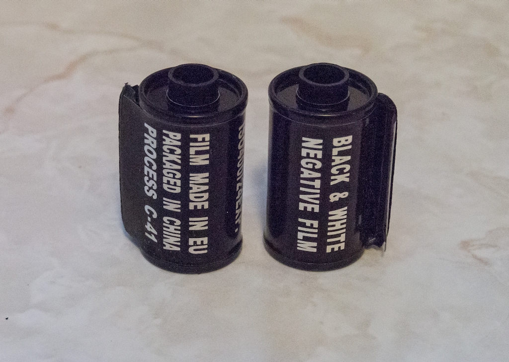

I think Kodak's was the only C-41 B&W film to use an orange base so it could be printed on colour paper. I believe the Fuji version was re-packaged Ilford from hints I have had. But there was another mystery film - I bought this from Freestyle many years ago and it behaved exactly like XP2 Super:
There were no edge markings beyond frame numbers, the base was purplish, and the technical department at Ilford looked at it for me and declared it was not a Mobberley product. So if it wasn't old bulk Ilford XP1, XP2, XP2 Plus or even XP2 Super, nor any of those passed on to Fuji, I wonder where it came from? Perhaps the claim it was made in the EU was just a lie and the whole thing is a Chinese knock-off. Whatever it was, it was cheap and good and just like the real thing for exposure and development.
If it's made in EU, it pretty well had to be Ilford or Agfa (did Agfa actually bring a C-41 B&W to market?). "Deniable" isn't a term used only at the State Department. Freestyle was and is well known for rebranding film from others, and there was a day (before the Ilford bankruptcy and buyout by Harman Tech) when Ilford sold their prime-line films for rebadging by (among others) Freestyle.
