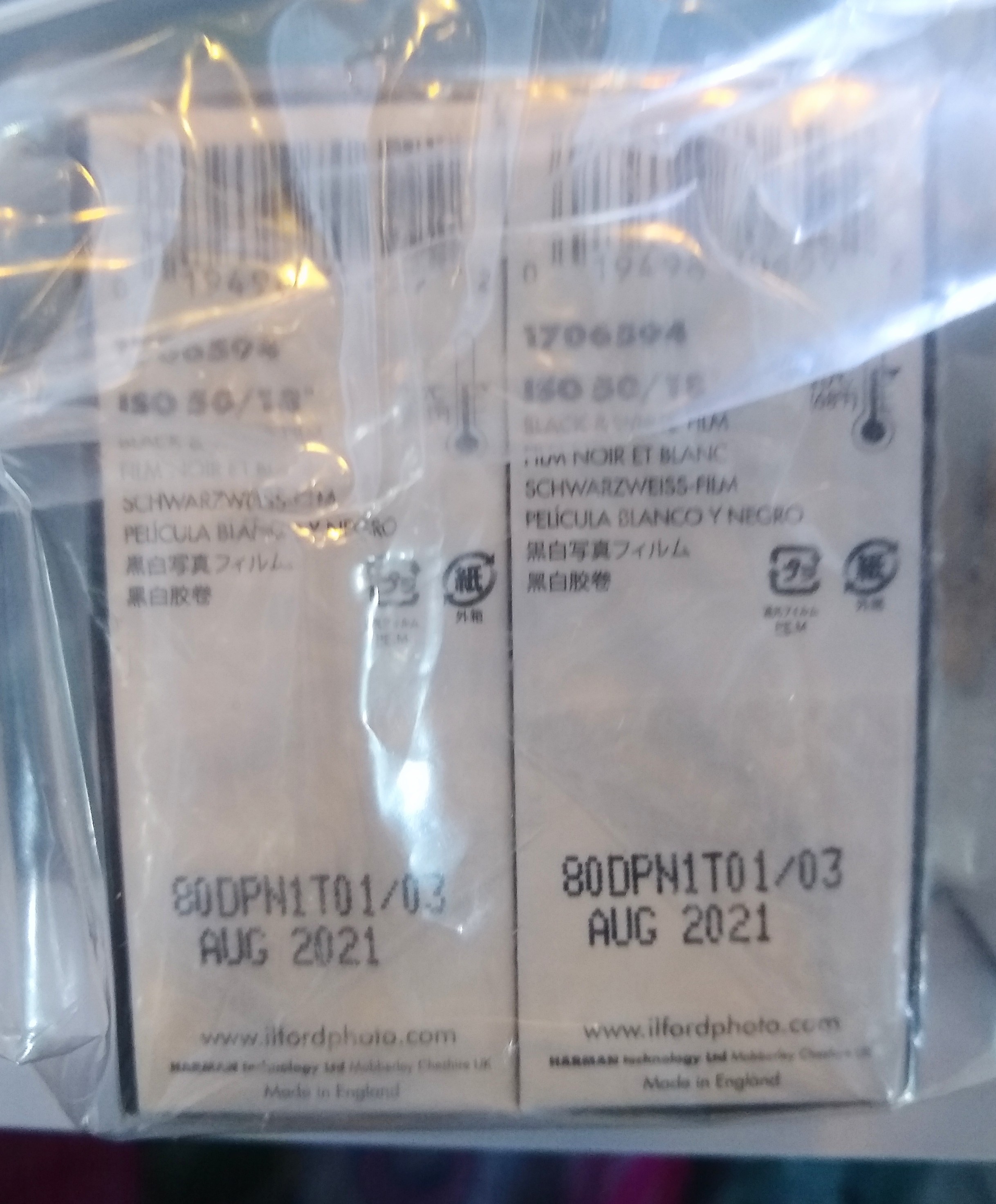

I've just come across the mottling on a roll of Pan F Plus used for a developer test. Batch code: 67BPN1C01/02 July 2021. I have a few other rolls from this batch and an additional test to do, so will probably report to Harman.
Edit: The 2nd roll of test film (Pan F Plus) also shows the mottling.

Hi Tom, I just processed a roll of Pan F Plus this evening, which I had shot yesterday and it has a lot of mottling. Guess what, I have a further two rolls and I've checked the box details to find the following... Batch code: 67BPN1C01/01 July 2021.
My batch was likely manufactured the day before yours! Obviously, they had problems at that time. I'm going to write to them and notify them of the issue.
