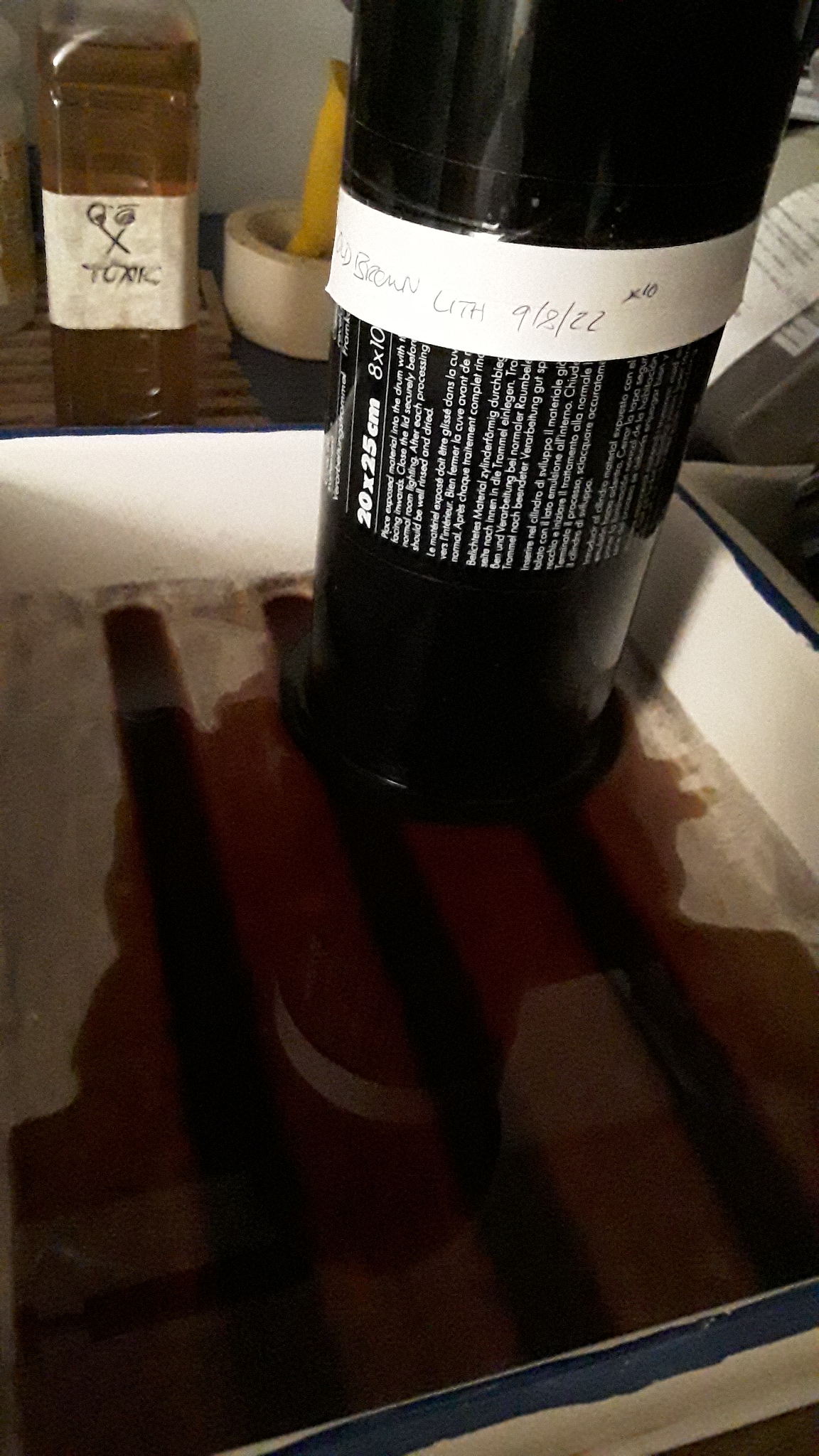

Came back to the darkroom to find that my Ilford 8x10inch processing drum has been slow leaking. Thankful from years of drilling in, the drum was stood on a processing tray.
Any recommendations for an inert pour in solidifying sealant which can withstand alkali/acid solvents?
Kind regards
RJ

My first choice would be Epoxy Glue.
Only substance from our range against which it has lesser resistance is Dichromate.

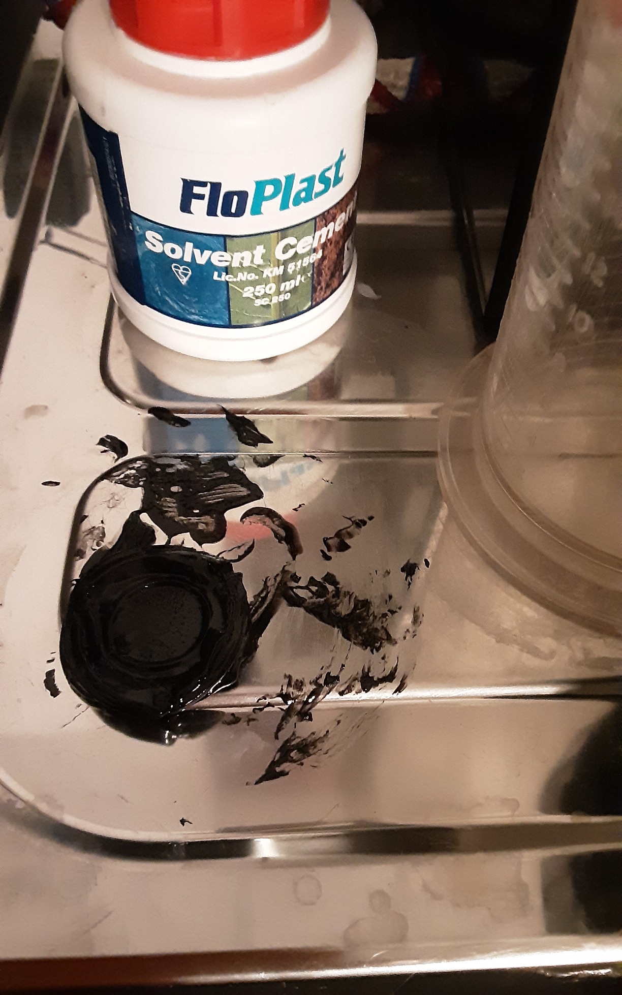

Thanks AgX Not sure - I dont know what the Ilford drums are made of. Maybe they are ABs plastics?
Farmers reducers and other strong oxidising reagents will attack the solvent weld. I don't use Potassium Dichromate regularly.
Here's the solvent glue. I can't trace the leak from the outside under a water tank looking for bubbles - thinking pouring in a layer of solvent glue to seal the base from the inside of the drum?

Flo Plast Solvent Cement
I did not find a data-sheet, but I assume it is intented for (hard) PVC. (But then it might be applicable on PS and ABS too.)

I tried the Floplast and poured in a centimetre and set it. Didn't work- the leak is flowing even faster and I can't tell where it is coming from even with the base newly sealed.
I think the Ilford drum tank is at the end of its useful life. It wasn't very well built compared to Paterson System 4s.
Sorry to see it consigned to the darkroom graveyard. Back to using Kodak 16 litre deep tanks ...

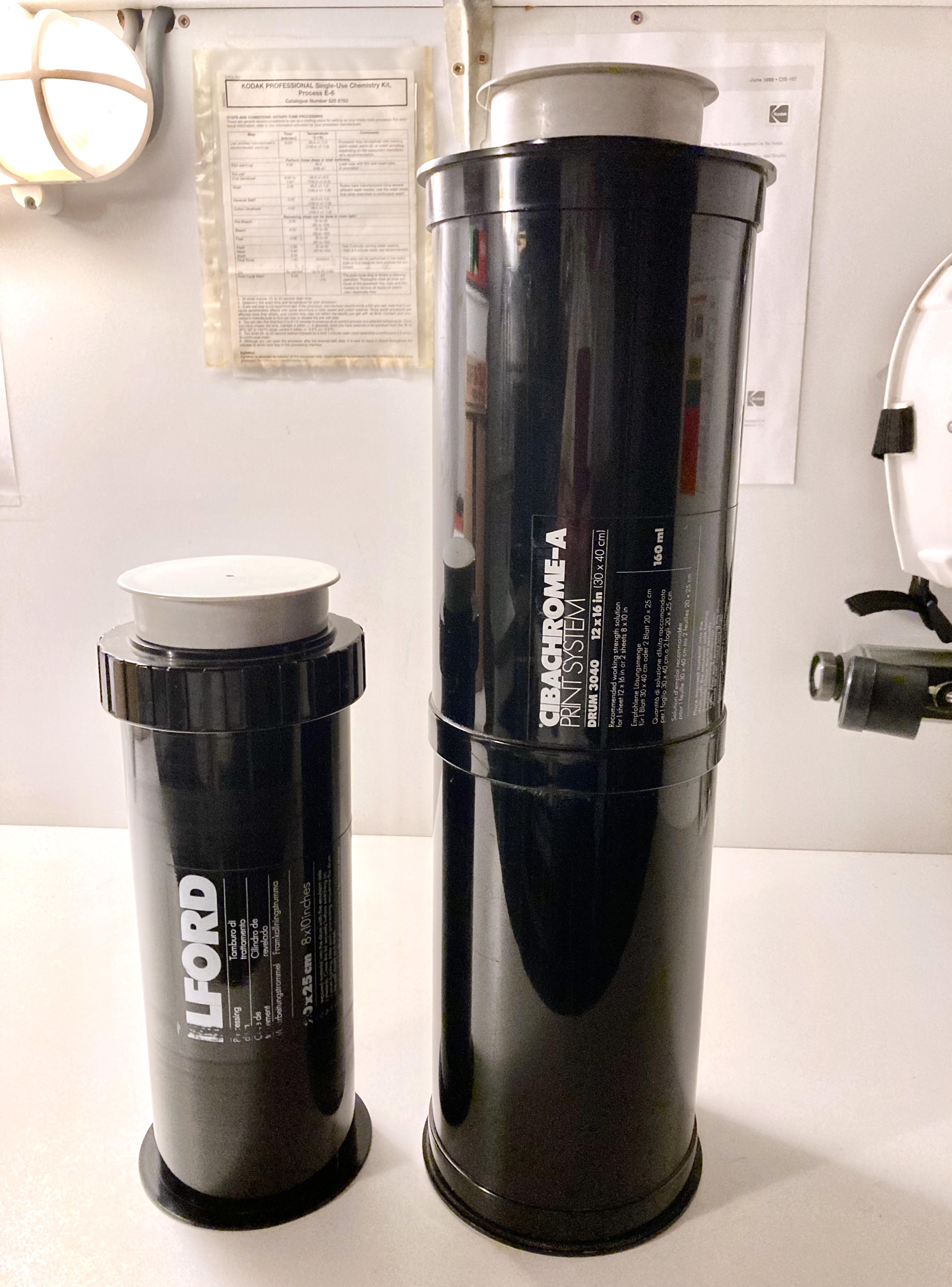

I have a ILFORD drum of the same size, and a CIBACHROME of twice that size, I don't use any more, if you are situated in EEC, I would trade the ILFORD for 5 HP5+/120 roll-films and the CIBACHROME for 7 rolls of HP5+/120 plus Bpost (that's both for 12 rolls)...

I think that the bottom of the large drum wouldn't com off as it is built totally different.
But, if you want/need one of these drums, we can work something out as Brexit may not stand in our way!

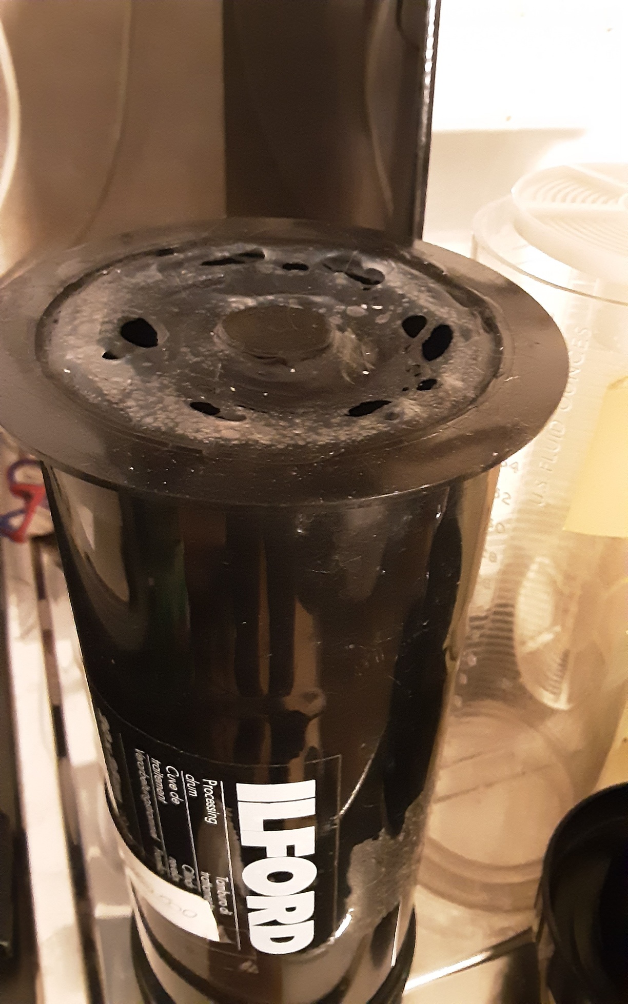

Final update for any future Ilford drum processor users -
These tanks are next to unrepairable - Floplast solvent cement glue cannot fix these and whatever material they are made from, they are just not as durable as polyethylene.
The bottom fell out completely. Time to move back to stainless steel ...!
