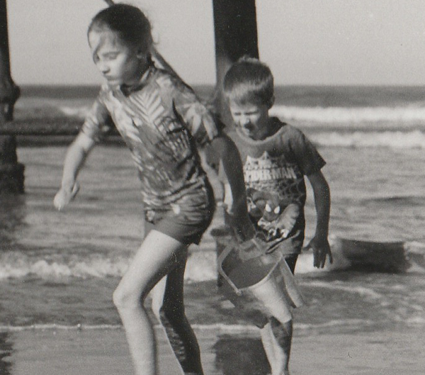

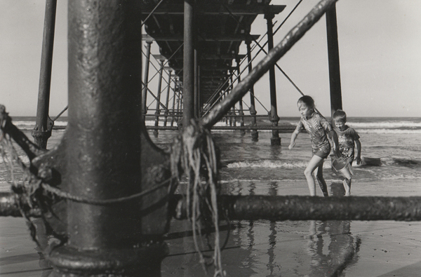

If people can get past the banal image, lazy scan, and dusty flatbed scanner, my only concern would be Op's short development time.
on the face of it the image attached looks fine - this was developed for 4 mins in microphen i think.
but... looking at the bucket and leg there is a weird blotchy effect which I am assuming is caused by such a brief time in the tank.
something for OP to look out for when it comes to printing.
