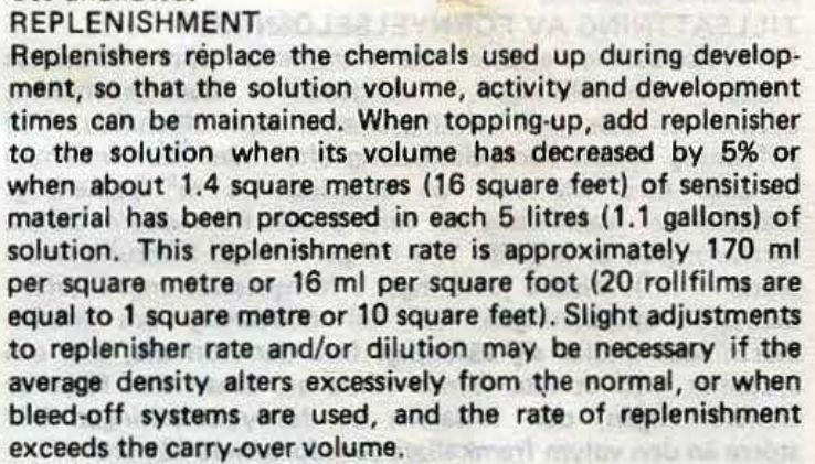

I found this PDF browsing on web. It's a scan of an Ilford document from 1977 giving the developing times for Microphen and also the replenishment rates for Microphen replenisher. I have to admit that the mixture of measuring units it's a bit confusing, but in the end it seems that 1 roll of film would need about 8ml of replenisher. I think this gives accurate values for Microphen or ID-68 replenishment rate for those who are mixing their own developers from scratch. I am attaching also the screenshot for the quoted paragraph from below and the website source :
https://www.photomemorabilia.co.uk/Ilford/Chronology/Ilford_Microphen_D_R_Oct77.pdf
REPLENISHMENT
Replenishers replace the chemicals used up during development, so that the solution volume, activity and development times can be maintained. When topping-up, add replenisher to the solution when its volume has decreased by 5% or when about 1.4 square metres (16 square feet) of sensitised material has been processed in each 5 litres (1.1 gallons) of solution. This replenishment rate is approximately 170 ml per square metre or 16 ml per square foot (20 rollfilms are equal to 1 square metre or 10 square feet). Slight adjustments to replenisher rate and/or dilution may be necessary if the average density alters excessively, and the rate of replenishment exceeds the carry-over volume.

I mixed some Microphen/ID68 formula (the one with 85gr. of sulfite) few months ago. I also mixed a replenisher. Since then I am constantly replenish my working solution with 8 ml after each roll developed. However, I am noticing that the density of my negatives has decreased, if I am looking at the control numbers. How is that possible? Or there is a limit of how many times you can replenish this stuff? I think I have developed about 30 rolls from the beginning of the replenishment.

I have a 1982 data sheet, that says replenish with 90ml replenisher after every 10 rolls of 120 film. Remember that films have changed significantly in recent years T-grain and similar films have a much higher Iodide content and that affects the replenishment rate.
I think it's 9ml , not 90ml :smile: You mentioned this 9ml value at the beginning of the thread. I used 8ml only because I followed that piece of scanned Ilford spec found on the internet. I am attaching the file. Actually, after doing the math, it should be 8.5ml
Hmm, that's something I didn't think about. You are probably right. I will over-replenish it with some extra 30ml. Another explanation could be the age of the replenisher? I mixed it in April.
No the full datasheet says 90ml after every 10 rolls of 120 film, which is equivalent to 9ml per film.
Increasing the replenishment will quickly change the balance of the developer. When Ilford formulated Autophen, essentially a PQ version of D76/ID-11 for photo-finishing, they analysed the used developer to allow them to formulate a replenisher that replace what had been used in the development process. Microphen was spin off from this research.
Ideally if you increased replenishment to say 30ml per film you would need the 9ml replenisher and the rest fresh ID-68, that would balance the working solution. I'd do that by re-formulating the replenisher.
You need to look at the Xtol replenishment volumes which are around 30-40ml per film.
Ian
Great, thanks for clarification. I was thinking to add 30 or 40ml of replenisher in the working solution only to bring back the developer to a proper strength (because now it shows thin control numbers). After bringing back the proper strength, I was thinking to maybe increase the replenishmet rate to 15ml per roll? It's just a thought.
