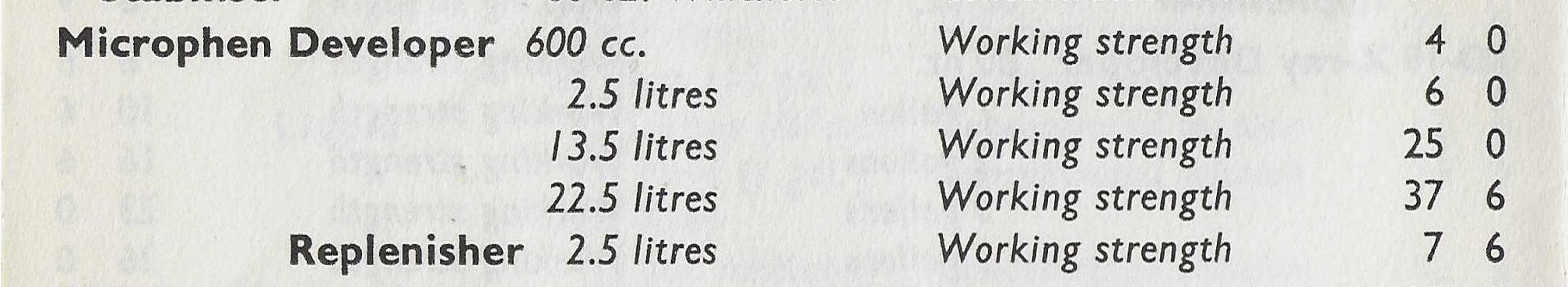

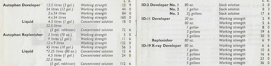

Mike, Microphen is now only available in 1 litre packaging, ID-11 is still available in 5 litre packaging as well, but again with no replenisher. Below is from the 1960 Ilford price list
When I used Microphen at school, a few years later, I was buying the 2.5 litre packs of the developer and replenisher. Because of the vagaries of replenishment I wouldn't want to use a working volume of less than 2,5 litres, in order to achieve consistent results.
For comparison see the much larger packaging for Autophen and ID-11.
Ian
Ian I am not sure if I have followed all of your reply correctly but are you saying that Microphen in its current form can be replenished with Microphen but it requires the so-called working volume that is used for the development to be 2.5 litres rather than the one litre of Xtol?
Have I got this correct and if so what might the replenishment rate be for each new film, is it back to your 9ml or is it a much higher replenishment rate?

No Microphen can only be replenished by its Replenisher. If it was possible to replenish with itself it would be uneconomic anyway.

That seems like an odd way to list prices. Why 160 /-, why not £8? I guess it keeps it to 2 columns instead of 3.

Craig, I guess the s/d prices are partially to make comparisons easier, 50kg of Hydroquinone is listed as 1818s 9d. It's also noticeable that prices are rounded to 3d, 6d, 9d, as there are 12d to a shilling this would indicate that it may also be to simplify addition.
