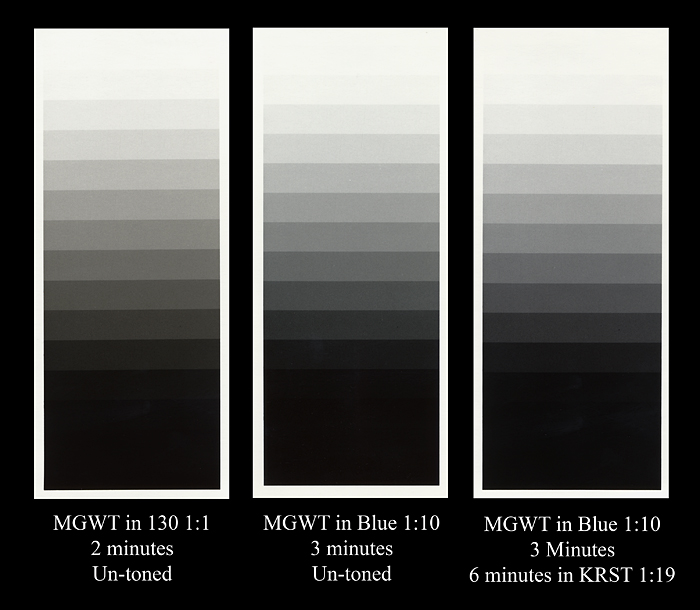

Cooling MGWT, a test
Well I told you I'd get to testing and I did. Today I got some Clayton's Ultra Cold developer and also again used some Moersch SE6 Blue that I had in stock. I was printing step wedges.
To be honest I was extremely disappointed in the Clayton Ultra-Cold. It produced a rather unpleasant greenish tone, not far from what most other developers would produce. I added 10ml/L of 1% benzotrazole solution to it.. Nothing. I added another 10ml/L of 1% benzotriazole, and again, Nothing. I'm not giving up on it yet, I'm going to selenium tone some of the wedges and also split sepia-selenium some as well to see how it tones.
On to the Moersch SE6 Blue... WOW!!! As soon as I turned the lights on I knew that was the developer for neutralizing MGWT. A wonderful neutral bluish color. Very cold, similar to a mild gold toning of MGWT. Some of the color is lost through washing, though not much. I also got around to selenium toning one of my wedges of MGWT in Blue. I was amazed. I toned for 6 minutes in Kodak Selenium at the 1:19 dilution. The paper acted much like MGIV, not turning a brownish-purple in the shadows, but rather simply cooling off even more and losing the slight tinge of green from it's blue. The blacks stayed cold! I was very impressed! Next I'm going to try the 1:9 dilution and see if it cools off even more, or gives a cold purple to the shadows. Overall I would have to say that Moersch Blue is the cold-tone developer that will cool off MGWT.
I have attached scans of MGWT in Blue un-toned, as well as MGWT in Blue & selenium toned. I have also included a scan of a wedge of MGWT in PF130 1:1 for comparison in tone.

Great results, Brian. I also have some of that MT6 blue toner too.
Have you any idea of how archival it is? I'm a bit worried about that, to be honest, as I think it's dye based.
Also, for cold tone developer - have you tried Edwal Ultra Black? I used that for a while, and it gives amazing blacks and cold tones.

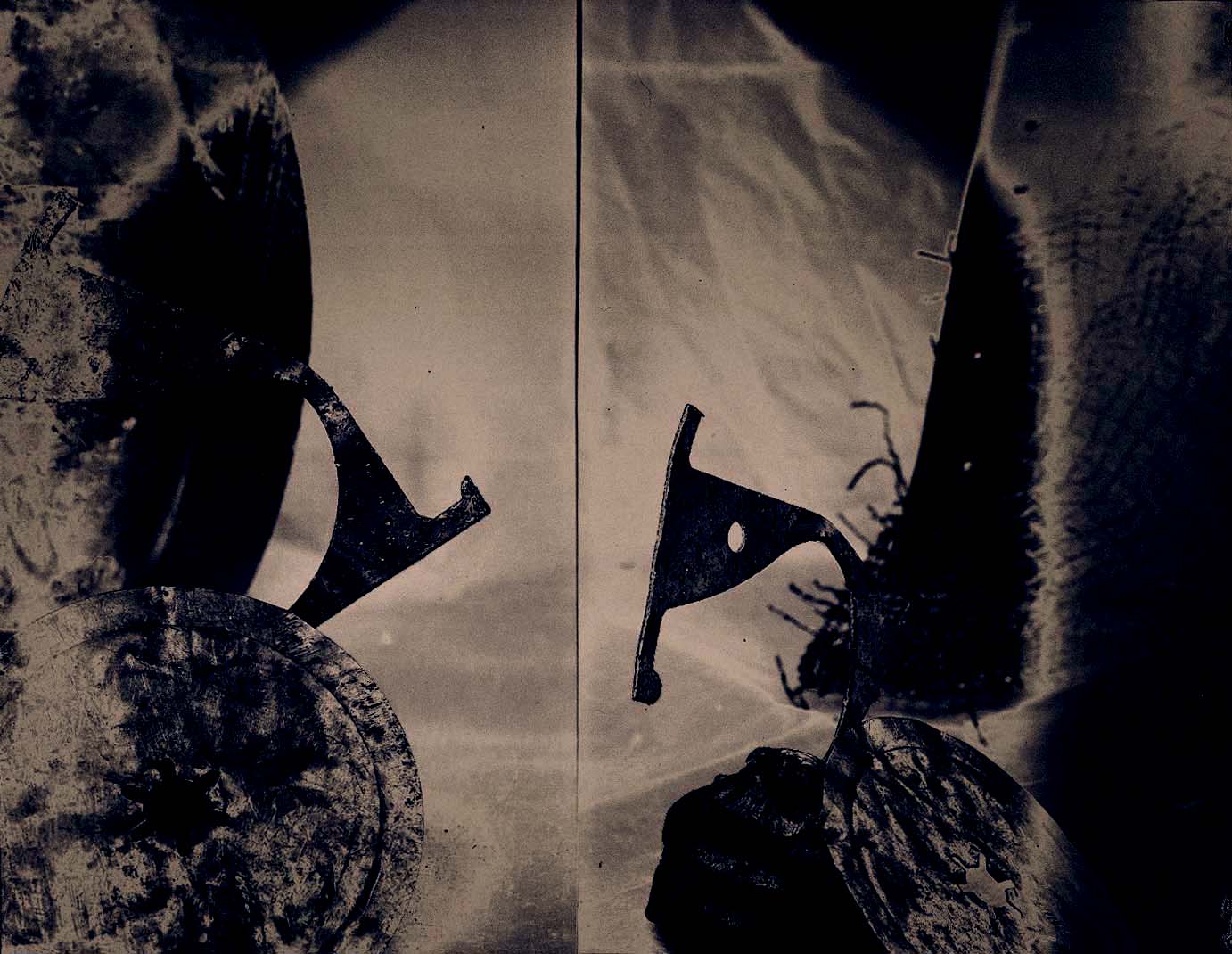

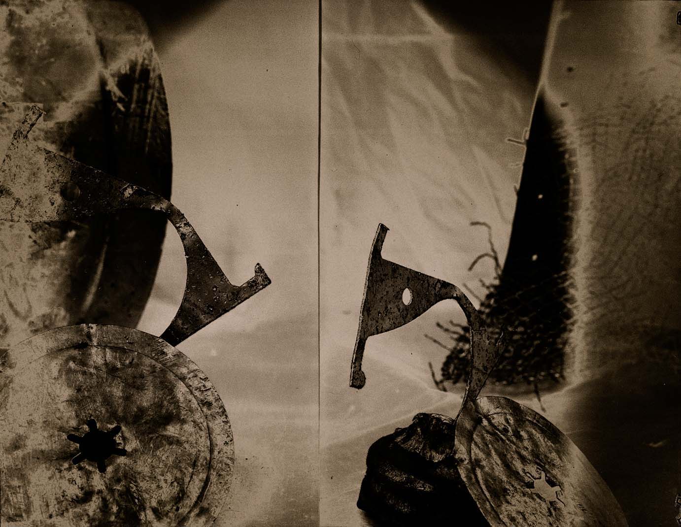

I have decided to abandon the blue chemically , in my toner sequence.
This is my crazy solution*****FOR SENSITIVE READERS DO NOT FOLLOW THIS POST AS IT MAY CONTAIN DIGITAL DIALOQUE WHICH COULD HARM YOU****
Once I have selected an image from my series that I really believe is worthy of printing and selling. I will high resolution scan the entire image,.
Then I will make my enlarged solarization prints with all steps that I have been working on for the last few years minus the blue toner. (I will include the black rebate for measurment sakes.)
I will then mount the print to aluminum and measure the print .
Then I will in PS separate out the shadows and make a shadow only negative with anything above 1/4 tone blocked out black on the negative and only the shadows showing through.{ the negative will be sized to the print) right now I am planning on 18x28 inch prints , once I get the larger film I will make them to any mural size.
Final steps will be to coat the paper with some sizing to accept a hit of Carbon, or Gum that has been made with blue pigment.
This layer will create the elusive blue shadows I have been pinning for the last 6 years.
What is your problem with the blue toner? Assuming you are using a non-dye based blue toner with a combined bleach / toning solution, that creates the Prussian Blue pigment as the end result, do you pre-acidify your papers before attempting to blue tone by soaking them in for example a citric acid bath?
The Prussian Blue pigment, which is the same pigment that forms cyanotypes, prefers slightly acidic environments, and will be destroyed in highly alkaline environments. This is also the reason why it should be the last toner in the sequence of toners, as for example the highly alkaline thiourea redevelop bath of a sepia toner will likely destroy it.
Impossible to work with as the last step, clearing out is a real pain, and I am not willing to work with it if the results are not what I want. I am using the iron blue direct tone formuala and it really works well sometimes, other times it is a huge mess.

I posted some solarizations with iron blue as the final hit over top gold and sepia. in my first testing I was using 11x14 and 16x20 papers, the control of the blue was ok , though I was unhappy with the fact the blue would wash off and be unpredictable as well not as archival.
When I moved up to 30 x40 and now 40 x50 the problems become too much for any sane man/woman to want.
With the alt overhit, I believe that it is quite predictable and the washing mechanics are not so labour intensive and un - predictable. As well the pigment overcoat is as permanent as the sepia and gold and it makes me warm and fuzzy to say I am doing.. two dev, solarizations with duo tone toners with a gum or carbon pigment over coat.
The sepia and gold is very predictable and easy to do in murals but once one starts iron blue toning 30 x40 's a whole world of whoopass starts.
I do not want to spoil days of printing with a sketchy end toner process.
