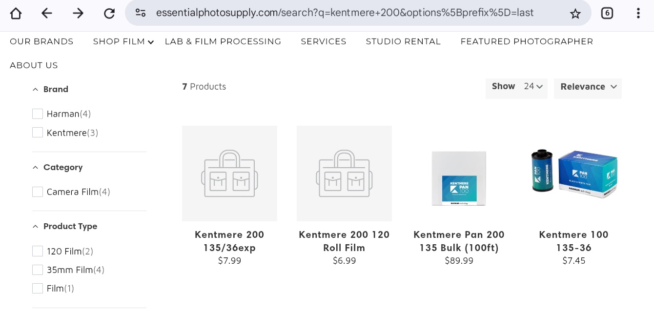

Essential Photo Supply has Kentmere 200 pages on their site, 36 exposure is $7.99, 120 is $6.99, and 100' bulk is $89.99 (though the photo/description has info for Kentmere 100, so not sure if its a messup on their part or what).
The 35mm & 120 rolls are available to buy (was able to add them to the cart), the bulk roll shows "sold out"
