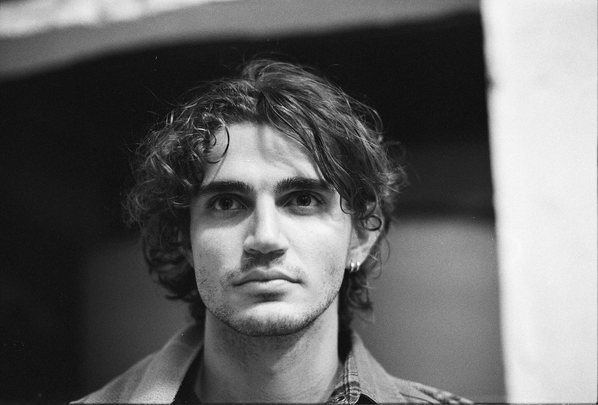

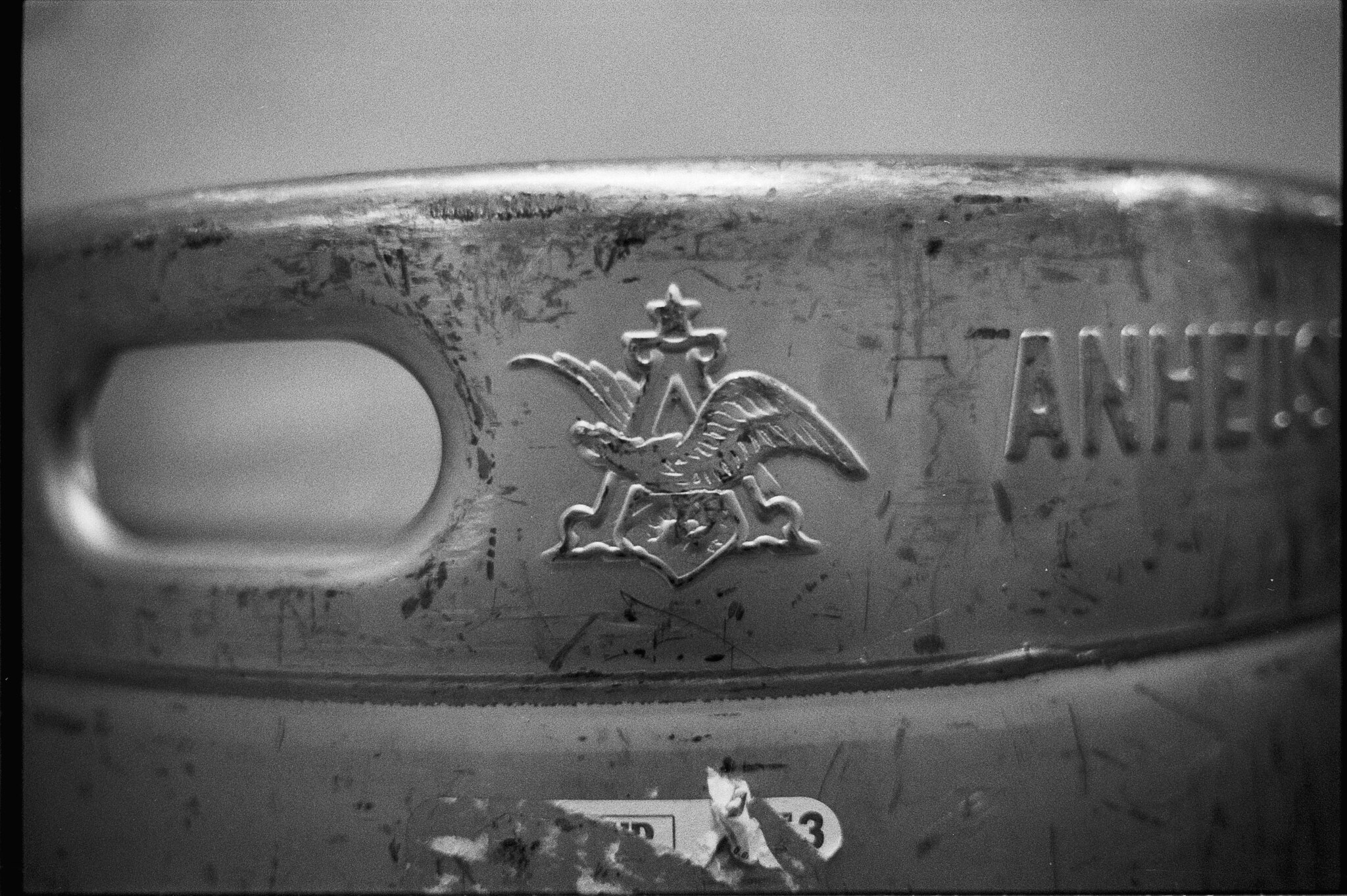

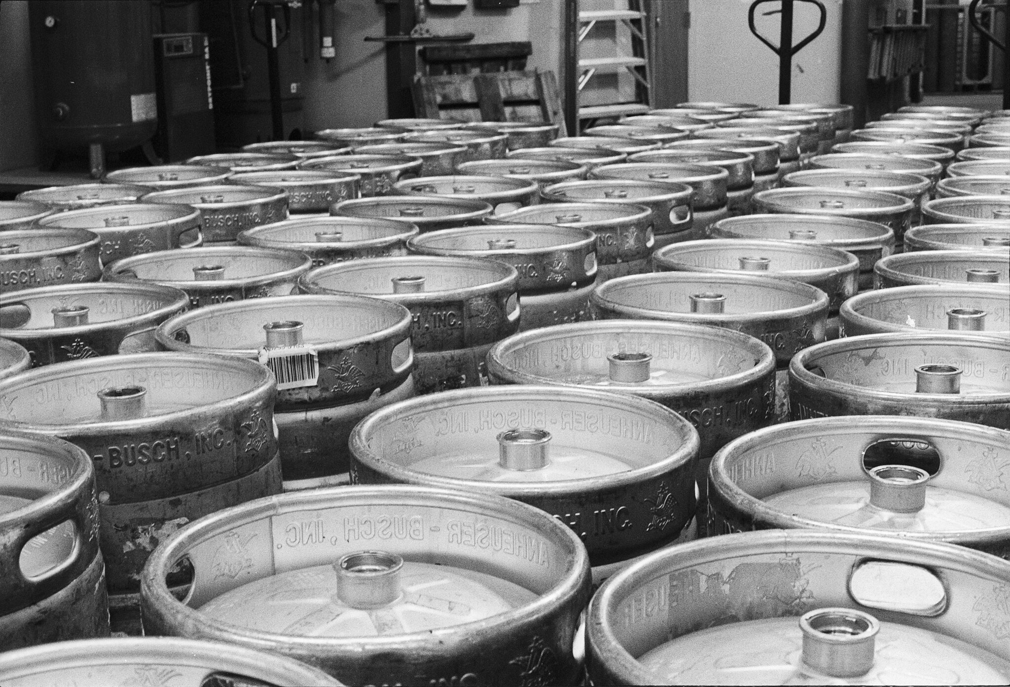

It’s difficult to evaluate the photos you posted above, without knowing how you metered them. The shadow areas in all three are relatively unimportant, so if you rated the film at 1600 ISO (ie under-exposed by two stops relative to box speed) and metered for the dominant mid-tones, one would expect the film (in fact any decent film) to have coped with the situation easily.
Rated at @1600 using Minolta A7 meter.
I have tried to push bunch of films and even developed tmax3200.
HP5 has really good resolution and dynamic range @1600
I have never tried triX at @1600 but I loaded some with my Leica CL.
Interested to see the result.
