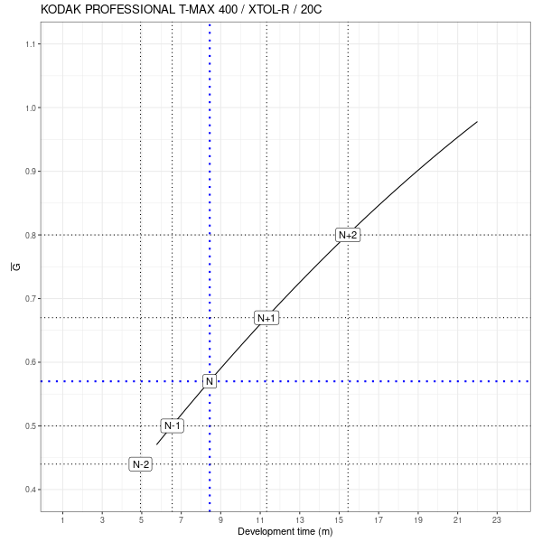

HP has a moderately long toe. There's a huge bifurcation regarding its usage on this forum between those who prize its quality for small format photojournalistic or street shooting reasons, and those like me with an entirely different application in mind relative to

Increased development helps to expand mid tones which might otherwise be compressed together in the foot of the curve, but has barely any impact on recording of shadow detail. In other words, there is no actual increase in the speed of the film.
