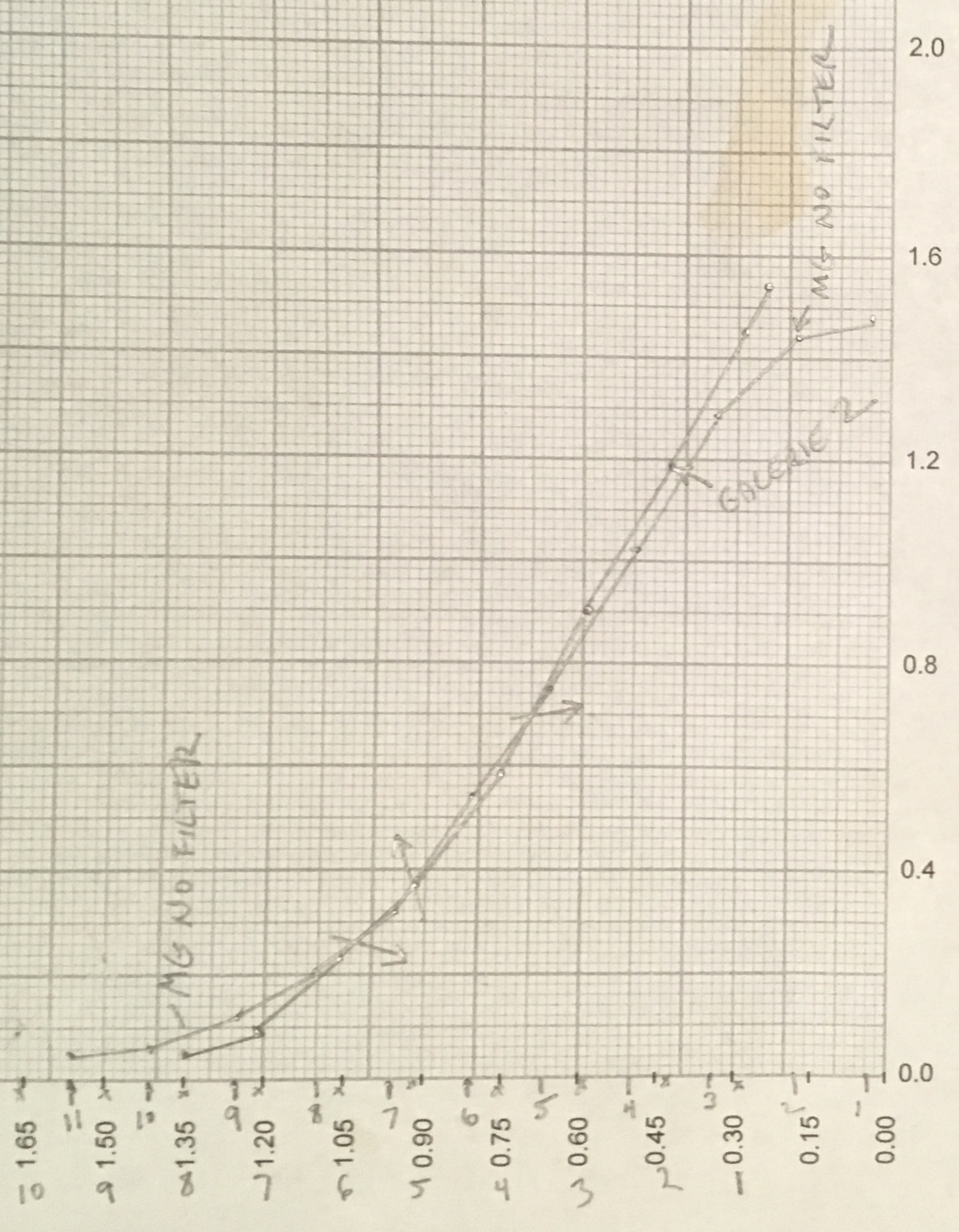

Galerie is olive in Dektol 1:2 compared to neutral MG. MG seems to have the opposite effect of dry-down happening in the shadows. A dark solid actually opened up when it dried. (Dry-down normally relates to clear highlights going thud).
Even though I didn’t catch a proper D-max of Galerie 2, here is a graph of it superimposed on MG with no filter. Both toned in KRST 1:20 for a few minutes.
Almost a perfect match. This is with an Omega DII and Aristo grid. The teal/turquoise color obviously provides sufficient blue and green light. (I wondered if it was good for MG but now I am convinced it’s just right).
I always “knew” Galerie was somewhat “olive” and it’s easy to see when side by side.
It looks like Galerie could have kept going, though I suspect the shoulder is just about to break at 1.55
I shifted the x-axis 0.25. Obvious to me MG is “one stop faster” than Galerie. The funny arrows just show the inflection points where the two curves crossed back and forth since they are so close to each other.
