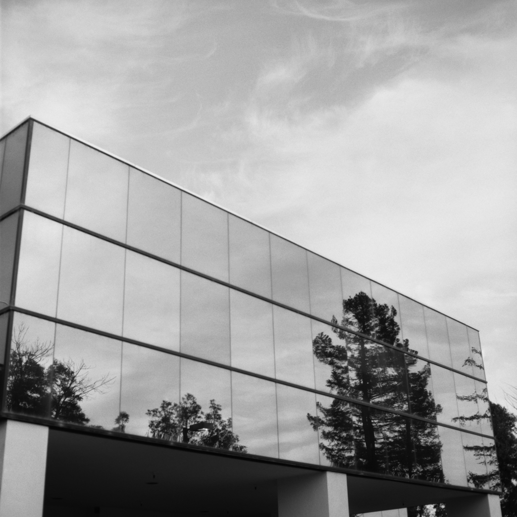

Perhaps you misunderstood my post. This is why I make test exposures and characteristic curves. I want to see what the film is doing so that I can decide if a generic curve will be fine, or if I need to make something more specific. More often than not, a generic curve works just fine, but if you want to do something specific, then you do need to work out where the inflection points in the curve are, and how much contrast there is between the inflection points. Describing with words tends to lead to misunderstandings, so it's easier to just show results: CatLABS X film 80, developed for 9 minutes, gives a touch over ISO contrast, relatively straight, with a pretty generic looking toe. All the inflection points are about where I'd expect them to be, so it's the standard generic ISO contrast curve.
Contrast wise, I have full shade on the underside of the building, with full afternoon sky and clouds. I can see details on the underside of the building, the sky and clouds aren't blown out, and I'm getting a nice reflection of the sky and clouds off the glass face of the building (which is mostly west facing and also has the sun beating down on it). It's not particularly flat, nor is it particularly punchy. Perfect for tuning up into something if I were so inclined to do so.

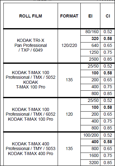

In developing film you know the ASA contrast figures out near 0.62
For my Zone System work, I use the following contrast aims: N+2 0.95 CI, N+1 0.75 CI, N 0.62 CI, N-1 0.53 CI, N-2 0.46 CI
I picked these off this chart starting with just saying 7 stops is Zone System N: (http://beefalobill.com/imgs/Contrast Indexes - Kodak.jpg)
The main point I want to make is that rather than aiming for a perfect Zone System N time or ASA fit, you should test a family of development times.
Try to get a spread of results in the range of contrasts from 0.95 to 0.46
From that you can make a Time/Contrast curve that will give you development times for any contrast you want between your test times (and you can extrapolate past the test times a little bit).

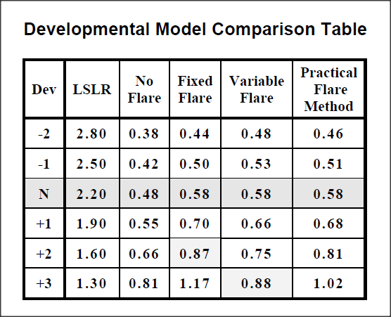

This is where the true superiority of a sensitometry and tone reproduction theory approach shows. All you need is a film's curve family and a developmental model and development can be tailored to a mired of situations.
Conceptually, the developmental model is the most difficult to accurately define. The idea should be simple, divide the aim negative density range or paper LER over the scene's subject Luminance range. This will give the CI or Average gradient need to match the scene to the print. A scene with the statistically average Luminance range is what is considered Normal development.
Unfortunately, there is another variable to consider. The actual Illuminance range striking the film consists of the subject Luminance range plus flare. Veiling flare adds illumination to the shadows, effectively reducing the subject's Luminance range at the film plane. How much depends on whether the lens elements are coated, how many elements in the lens, and the interior structure of the camera. On average flare under statistically average conditions are around 1 to 1 1/3 stops. The equation to determine aim CI becomes NDR / (LSLR - Flare).
The chart that Bill references was given to me by Dick Dickerson, head of Kodak's B&W R&D Department. His team invented the T-Max films and Xtol. It is based on a fixed flare model with 0.40 as the value for flare. While flare tends to increase 1/3 of a stop per stop increase in Luminance range and 1/3 decrease with each stop reduction in the subject Luminance range, the model is good enough as flare is variable based on not only the camera's optical system or the scene's Luminance range, but also the tonal distribution within the scene. A greater degree of lighter tones will produce a higher degree of flare. And since flare is extremely difficult to measure, calculating the influence of flare for any condition is limited to best guess.
Any degree of flare doesn't matter too much until developing for more extreme situations like -2 and below and +2 and above. Arguments can be made for a variable flare model, and I've come up with one that is a balance between the two and that conforms to psychophysical preferences.
Anybody that has worked in a lab knows that when a customer asks for +1 development, they mean the film was rated one stop under the ISO speed. Development for "speed" is different than developing for contrast. Different but not impossible to determine. The model Kodak uses is almost identical to the variable flare model.
All possible from one series of film tests.

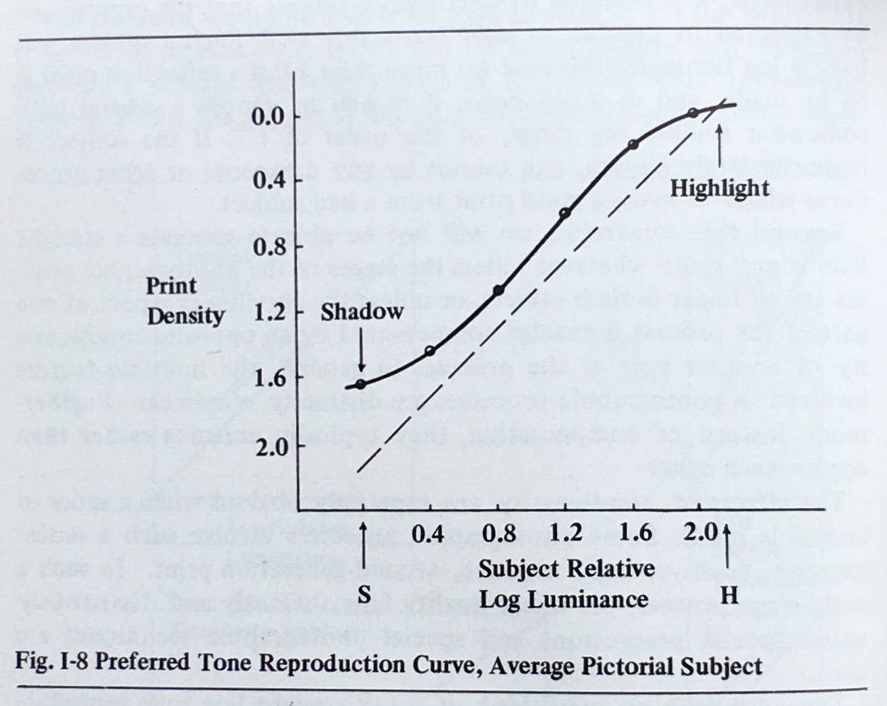

Here’s what I would do if I could introduce transfer functions... I would try to end up with this curve at the print.
If you ever wondered why paper has the strong s-curve it has, aside from that being generally characteristic of silver gelatin, the paper manufacturers aim at this final curve... (Todd-Zakia).

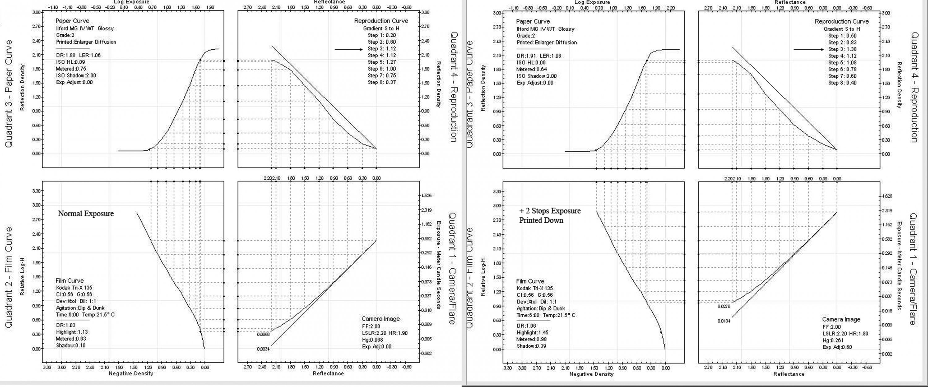

Nice call Bill. I was thinking about showing a couple of tone reproduction diagrams and now I will. Here are two tone reproduction diagrams. One is normal exposure, development, and printed to match the paper LER. The other has the negative two stops over-exposed. The negative picked up a little extra density range as it moved off the toe, but as with short toed curves, it wasn't much. The negative was printed to fit the same paper. The results are a little extra contrast in the shadows, slightly lighter tones through the mid-tone range, and slightly more compression of the higher values than in the highlights.
If the negative processing was reduced, it would have produced a flatter negative which would have needed a higher grade of paper. Now, I have a Howtech Scanmaster 4500 drum scanner, but haven't really used it yet, so I don't have experience scanning through the additional density from over-exposed negatives. I guess this would be a question for a different forum. For here in the analog section, as Loyd Jones said, it's not about density, it's about contrast.
