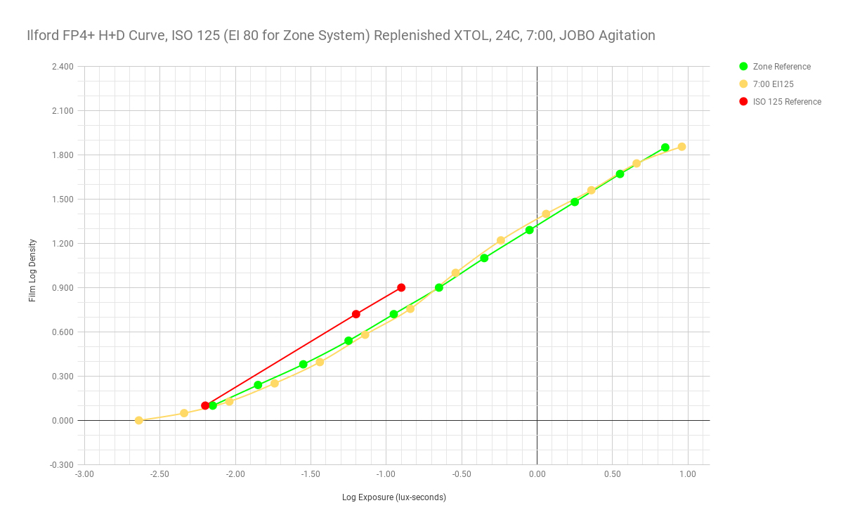

Thank you. I'm often out at Pt Reyes, Mt Tam etc summer about once at week, at least when I'm not in the high country somewhere.
I get that. I did it the way I did it because it’s easier in google spreadsheets. My options are to generate the ISO reference the way it is now, generate the way it is now, but with no dots, and generate it with no dots and after the graph image is generated, pull it into photoshop and manually put a dot on 1.0 for the meter point, and 1.3 for the aim point. What’s the preference?
For the horizontal scale along the bottom, converting it to arbitrary relative log units isn’t really that big of a deal, though I’d have to come up with a scale for log meter candle seconds. Is there a reference for this somewhere?
Easiest would be to do a little math on your numbers to “put them where they should be” keep the units and scales you have they are fine. I struggle with how to represent Zone System. For this I took Ansel Adams guidelines for Zone V and Zone VIII highlighted in green. See how nicely you hit N? Starting with your numbers I interpolated 0.1 and assume it shifted 0.05 towards less speed due to lesser than ISO development. I locked the 0.1 point and put all your data points correspondingly. I found the interpolated 0.1 at 0.106 and you can see the math lower right corner. I just added 0.11 (rounded) to each Zone data point to put them where they should be.
Again my bottom Log E scale is arbitrary and literally is the density of a step wedge on my sensitometer which arbitrarily puts about 0.3 log meter candle seconds at the film plane. You absolutely can change that to be 0 anywhere you like, for example the speed point, Zone V or the metered point if you like. Towards left is less light, towards right is more light. (My scale goes up from right to left only because it’s “attenuation”).
I picked Ansel Adams’ Zone V and Zone VIII ranges for diffusion enlarger.
I think I'll keep it log units, but put the zero at the far left so left to right is more exposure, as that logically makes sense.
For your last chart you posted, I've looked at it, but I need to noodle on it a bit, particularly the interpolating zone 1 part. I think my last chart is pretty close, but I didn't do the zone 1 interpolation part, so I'll see if I can work that in and post the results.
Thank you for this input and your time. This has been pretty instructive.
Thanks, This has been fun for me too. I don't think anyone's done a graph showing the relationships of ISO and Zone System in this way, and I think it's a good way to show the differences. (I like what this is beginning to reveal).
Actually, if you use the scale 0.0 on the right -3.0 on the left, that is like your last graph, that is a good fairly common way to do it. Log meter candle seconds... negative log values just mean smaller numbers. 0.0 is one, -1.0 is 1/10th, -2.0 is 1/100th, down to -3.0 is 1/1000th of the light at the far left (less light as you go to the left).
Interpolating is really easy and self-confirming. (The correct answer looks right on the graph, incorrect math doesn't even come close).
I like the way Zone V at EI 64 can get you 0.7 density... and Metered point by ISO 125 can get you 0.72 density... and everyone assumes they are the same. But notice how with Zone System you downrate the film by nearly 1 stop, and that would lead to higher density except with Zone System you develop to a lower contrast, and that leads to a lower density - the two practically cancel out.
In practice, don't plan on developing to ISO, that's just for testing. After you find the test times for ISO to confirm your process conditions, you dial down the contrast slightly.
Well, it's just me trying to wrap my own brain around how this works and how the two are related. My original graph was actually an accident as I was just trying to make sense of the two systems and come up with a reasonable way to determine rough development time and approximate speed with the equipment I had available to me. I knew I was on to something when I did a couple of exposure and development iterations and saw what was happening on the graph, though I feel sharing here on photrio has led to quite a bit of refinement in that.

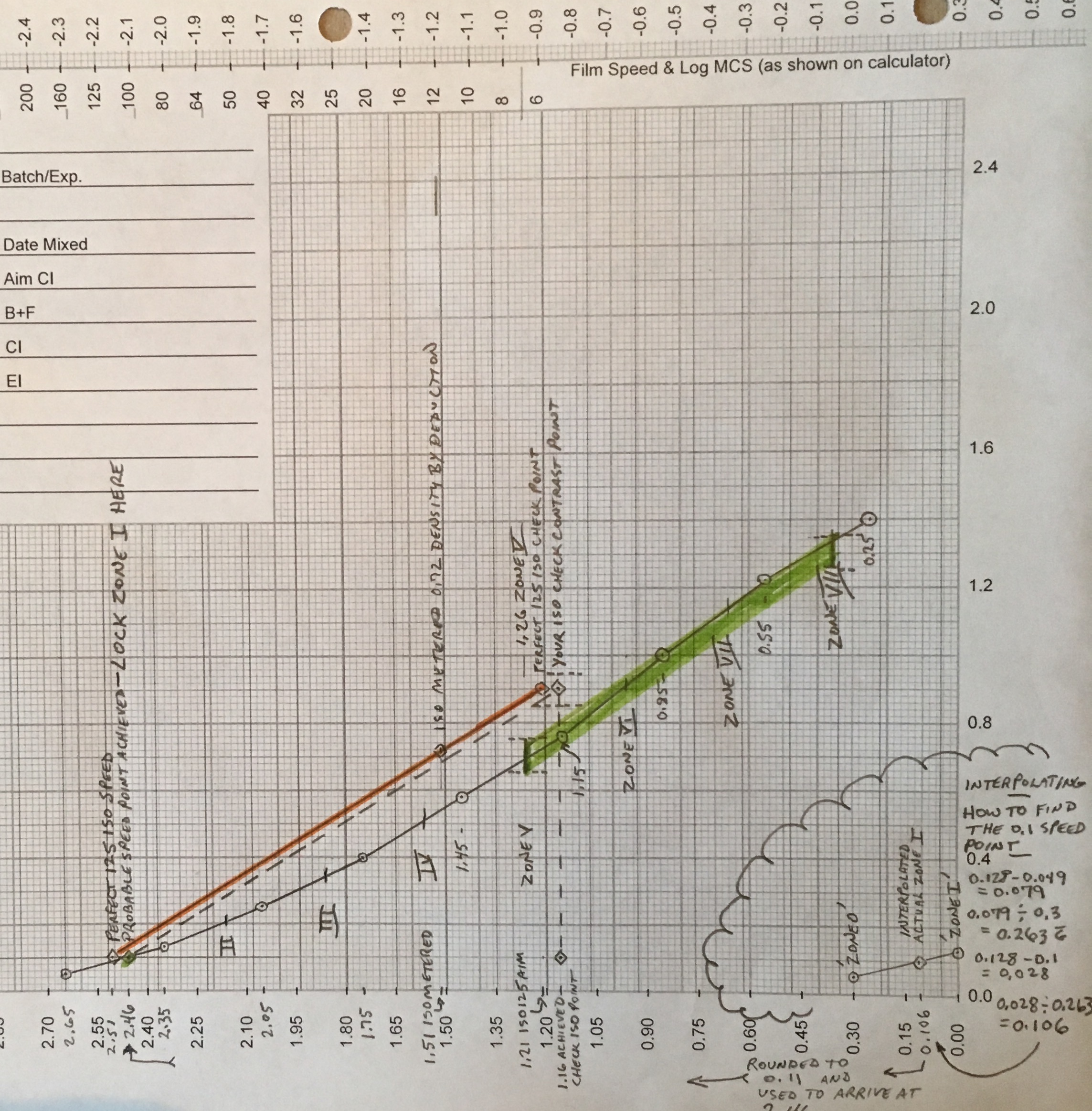

Just to make sure I'm getting this right... on your graph, points 2.65 is reference zone 0, 2.35 is reference zone 1, 2.05 is reference zone 2 correct? point 2.46 is my 4 stops down 0.128 sample data correct? So the zone reference data is offset by the interpolated zone 1 value in exposure units along the horizontal scale? Correct?
Nevermind. I figured that part out. The 0.11 is the offset from the 0.05 mark for my data. I put the zone 1 reference data starting at 0.05. See attached chart. If that's not correct and should still be at the same place as the ISO speed point, then say so.

2.46 is Zone I according to my best guess. The zones all shift 0.11 to the left. They shift because you didn’t have a sample point at 0.1 (it’s not necessary or even desirable to have a sample hit 0.1).
Your latest graph is nice. Zone and film look good. The ISO is too steep. Metered point should be at density 0.72 and 1.21 should be at 0.9

Alright. Here is the latest version. If there are no further changes to make, I'll update the original post so people don't have to scroll all the way to the bottom to get the best one. If there is anything else to change, say it now or forever hold your peace :smile:. I've got a whole stack of sample data from other emulsions to do this on.

Stephen, I had Adrian mark (in red) the ASA parameters for 125 film, plus the ‘10x’ point. Then for Zone System he took Ralph’s (I think) densities for Zone V and Zone VIII. (Close enough to Ansel Adams’ suggestions to work for me). He extrapolated the other Zones. We took the Zone Reference 0.1 speed point and shifted it to the right 0.05 (an arbitrary guess) from ISO 125 speed point to reflect where I think the lesser development for Zone System N may move it.
The result is a red ISO Reference and a green Zone System Reference for N.
Then his characteristic curve is yellow and we put the interpolated 0.1 on the Zone I mark. The yellow dots are his data points.
I think it’s perfect and could only be better if we find the absolute speed point shift due to Zone N development. For now 0.05 is my best guess.
