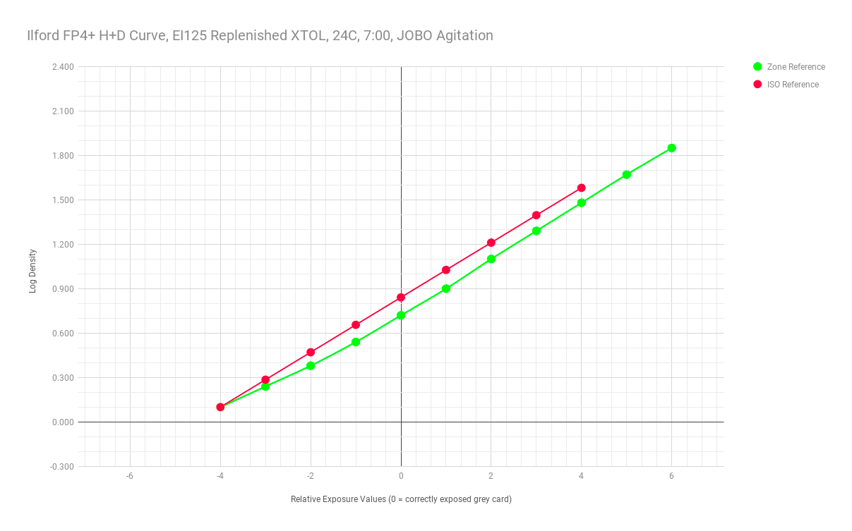

For those that are interested, here's what the characteristic curve looks like for Ilford FP4+ in replenished XTOL.
It was generated with what tools I have available to me, and while not scientific by most measures, gives a reasonable approximation of what to expect if shot and developed using a similar development setup as me.
The development setup:
Replenished XTOL, developed in a JOBO with constant agitation at 24C for 7:00 even. The XTOL is in a 2.5 liter bottle and is replenished with 70ml of new for every 80 square inches of film run through it.
Ilford FP4+ H+D Curve, EI125 Replenished XTOL, 24C, 7_00, JOBO Agitation.jpg
The green line is the zone system contrast curve, the red line is ISO standard contrast curve, the yellow line is what FP4+ is doing. The vertical axis on the left is film density in log units, 0.000 is film base plus fog. The horizontal axis along the bottom is relative exposure of an 18% grey card in full stop increments with the card filling the entire frame and the lens at infinity focus. The zero point on the horizontal axis is the exposure index for a correctly exposed 18% grey card, so horizontally to the right is the grey card given more exposure, and horizontally to the left is the grey card given less exposure, in full stop increments. -4EV on the left side of the horizontal exposure axis is placed 0.1 log density units above film base plus fog and is the speed point for the red and green lines.
I can very reliably control the amount of light hitting the grey card to within a 1/10 of stop up and down the exposure scale. It's not without error, but it's consistently very close.
So, looking at it, I'd say that with Replenished XTOL at 24C in a JOBO, Ilford FP4+ is at least an ISO 125 film. At EI 125, -4EV down has a density unit of 0.128, with the 0EV point hitting 0.756. If development time was added to bring 0EV up to ISO contrast (the red line), you could probably expose it at EI 160 to bring down the -4EV spot, though more development time would mean the highlights from +1EV and up would have more than ISO contrast.
Enjoy.

Adrian,
This is helpful as I've recently started using XTOL replenished again, and there have been some comments online about film suffering speed loss with this system, which your graph would seem to contradict.
Tom
Usually when you see comments like that it’s because if you run it for the same time as stock, it under develops, either that or they’re just repeating the Internet echo chamber and don’t actually know because they haven’t actually tried it or measured it.

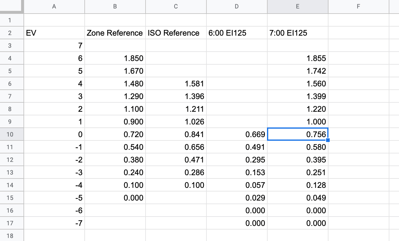

In the interest of transparency, here's the values that make the graph up. I didn't include the 6 minutes, but do have values that I can plug in up to +6 EV just like the 7:00 minute column. 6 minutes isn't enough time.
I can drop the zone 0 point off the graph if it would cause less confusion, though Ralph might feel a little clipped :smile:. For the ISO Reference, 4.3 stops up puts the log density at 0.9 above FB+F, however 4.3 stops is about a 1/3 of the way between 0EV and 1EV and I want the value at 0EV which is 4 stops up, not 4.3 stops up because I'm using full stop resolution. Soo.... I took the ISO contrast (0.8/1.3 = ~0.615) and calculated each full stop point starting at 0.1 using the 0.615 gamma. I'll be the first to admit that I'm not a math wiz, so if somebody has a more accurate ISO reference for each full stop value starting at 0.1 density, I have no problem with plugging that in.
The 0EV point is a meter reading with an incident meter placed where the grey card is, facing the camera and is illuminated with a giant 10x16 foot white wall behind the camera that has two studio strobes with umbrella reflectors hitting it with light. The grey card is about 10 feet away from the wall. It's as even lighting as it's going to get and I can exact some pretty consistent light with it. Since FP4 is available in 35mm, I generated this using my T-Stop rated lens which has a de-clicked aperture control ring on the barrel of the lens. Since it's transmission rated, I'd expect each t-stop mark on the barrel of the lens to be extremely close if not exactly on for the amount of light going through the lens and hitting the film inside the camera. The setup is not sensitometer accurate, but it's within reason and very consistent.
So, given the spreadsheet values, what would you change again?

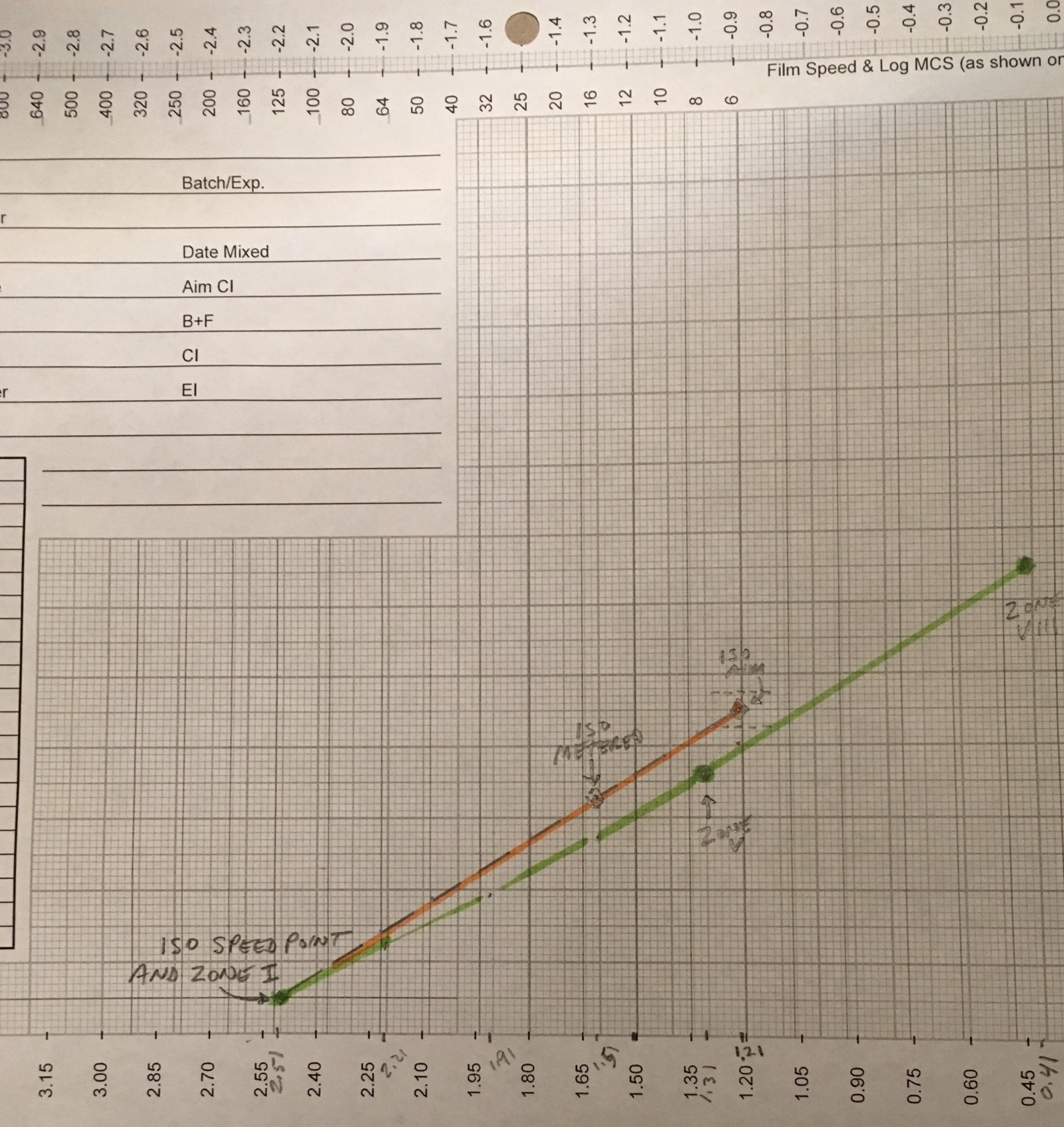

Thanks for the data points. I’ll graph it on paper and show what I think the references should be!

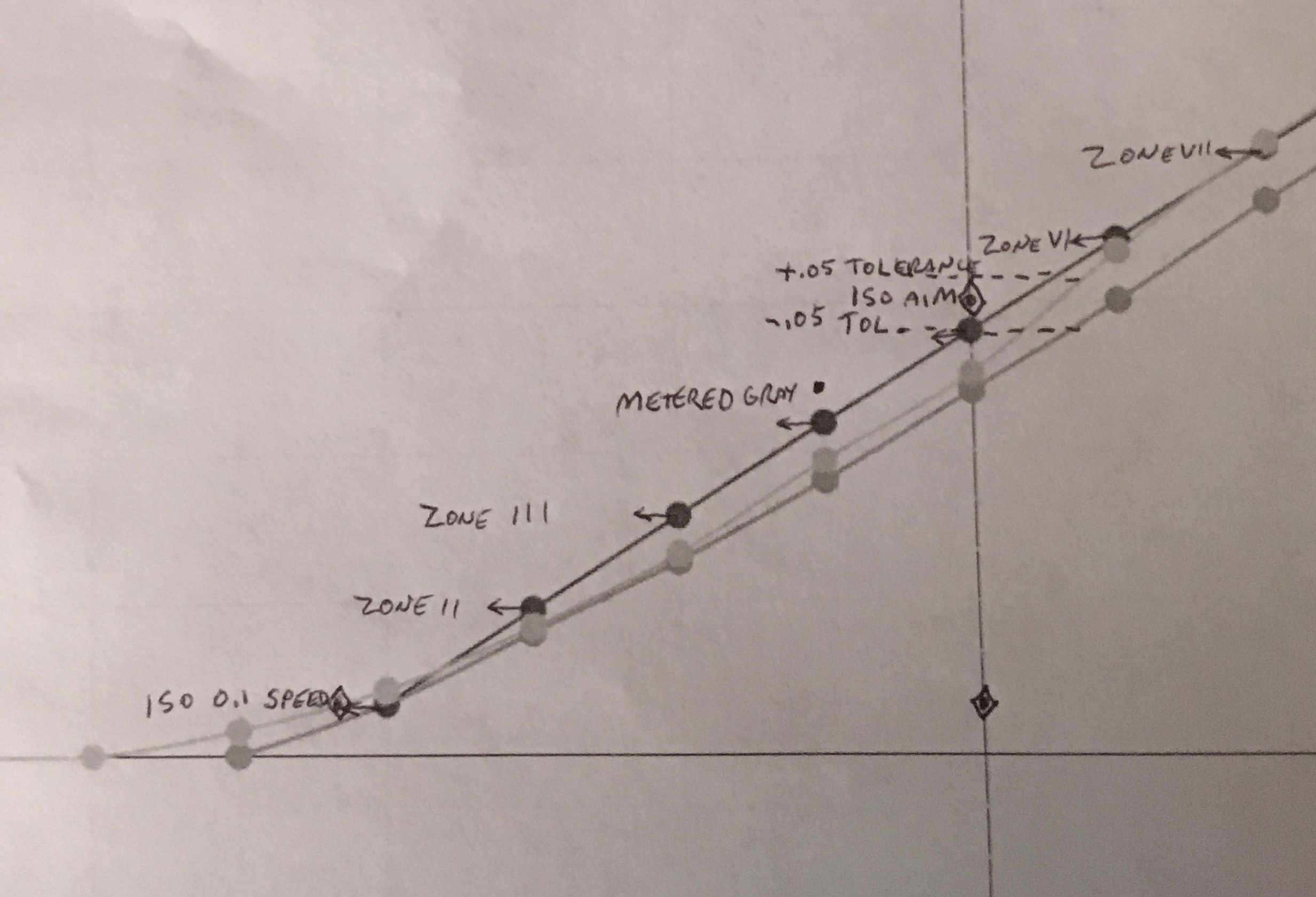

I propose this framework for the references.

Adrian, I didn’t explain my scales. The lower x-axis label is “arbitrary” and is where I marked results of calculations but the real scale is at the very top. It’s what my arbitrary scale is calibrated to and shows log meter candle seconds corresponding to film speed.
The chief differences I want to point out is that ISO meter point is 1.0 (3 1/3 stops) from the speed point while the Zone System meter point is 4 stops. This means green and red scales need to be stepped apart from each other by 2/3 stop, with the Zone System seeming to make the film look slower. You also develop the film less for Zone System so I knocked off another 1/6 stop to adjust for that.
A correctly exposed gray card with Zone System would be Zone V with an EI about 64
A correctly exposed gray card with this film at EI 125 and stopped down three and a third stops would be 0.1 when the contrast parameters are met. And that point would be at -2.2 log meter candle seconds.
I would want to put your 7 minutes film graph with its 0.1 mark at the point of -2.15 log meter candle seconds to adjust for the slightly lower development that you achieved.

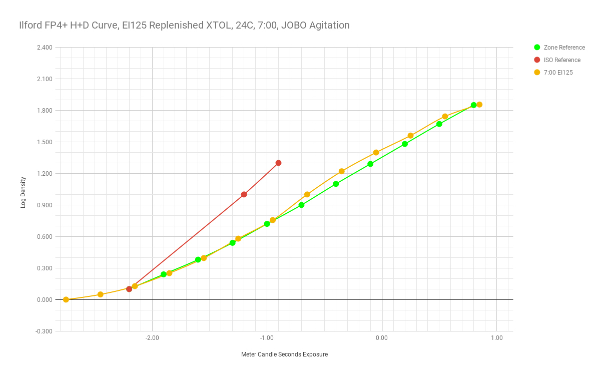

Horsing around with Google Spreadsheets resulted in below. Something like that?
