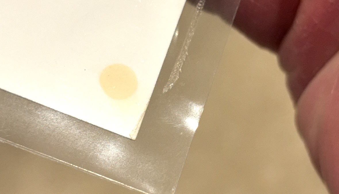

Hi all,
I've been using Ilford's 5 + 10 + 5 wash method for their FB Glossy paper. I did a residual hypo test (photographer's formulary's), and found a definite yellow stain.
Curious about what I'm doing incorrectly. I'm using their rapid fixer at 1:4 for 1 minute, per instructions. I'm using a vertical print washer.

Out of curiosity, is the stain the same in different places on the sheet? I wonder whether the flow patterns in the vertical washer may have an effect.
Good point!
I’ll spot test other parts of the print tonight. Just did the one spot.

One thing I realized just now is that I don’t empty the print washer after the first 5 minute rinse before the HCA.
This may make a real difference as the wash water from the first 5 minute rinse will be relatively heavily loaded with fixer. Depending on the rate of flow through the washer, this may carry over into the subsequent washes and have a significant impact.

I have, using a vertical print washer (Paterson) but emptying in between. My blind guess would be that that’s the important difference.

Yes, all my prints pass the RHT test using a slightly modified Ilford sequence. The first wash is normally for 10 minutes in flowing water with a change of water that accumulates in the tray at 5 minutes. Then 10 minutes in washaid with agitation as normal and finally a one hour wash in a Paterson vertical washer with a complete change of water at 30 minutes. All at 20c or a little more.

I also found the ilford method way too short for me as well. I do a brief wash in a tray with siphon after fixer or toner. Then into hypo clear for 10 minutes. Then wash for 50 minutes in vertical washer. This passes the RHT for me every time.

The first wash tray or washer needs to be emptied and refilled if it is to be used for the second wash.
The intermediate wash-aid step should be done in a separate tray with agitation using fresh solution.
The final wash needs fresh, running water.
Temperatures need to be close to 20°C
Times from Ilford are predicated on using very fresh fix and short fixing times. Exceeding either of these parameters will increase wash time.
If you are using a one-bath fixing regime, then your throughput capacity will be rather low: 10 8x10s per liter for "optimum permanence," or 40 8x10s per liter for "commercial" standards. This latter may be too generous.
If you exceed the 60-second fixing time with drain time or whatever, you'll need to wash longer.
If you tone, you'll need a much longer wash; Ilford says 30 minutes for the final wash after selenium toning.
If you keep getting stain with your RHT, and are using fresh reagent, doing the test in subdued light and reading the result after only two minutes, then you simply need to extend your wash times.
Personally, I use the old-fashioned Kodak sequence, but with a longer wash-aid step. I fix in less-concentrated rapid fixer using a two-bath fixing regime for 2-2.5 minutes per bath, then give an initial five to 10 minute wash (often longer, in a holding tray), then a 10-minute treatment in wash aid, and then a final wash for 30-60 minutes. Never a staining problem.
I don't like the short fixing times with the Ilford sequence, Keeping wet time in the fix to just 60 seconds with a two-bath regime and large prints is just not practical.
