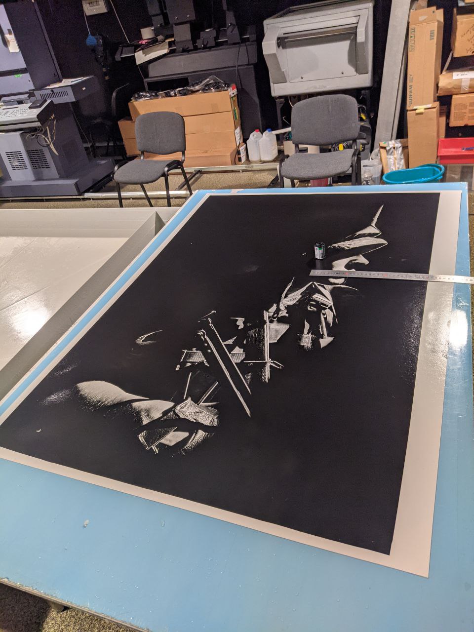

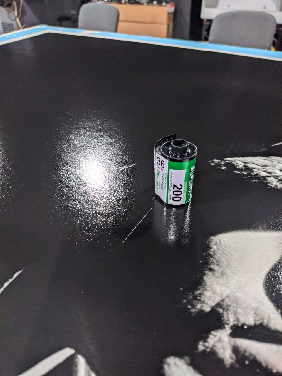

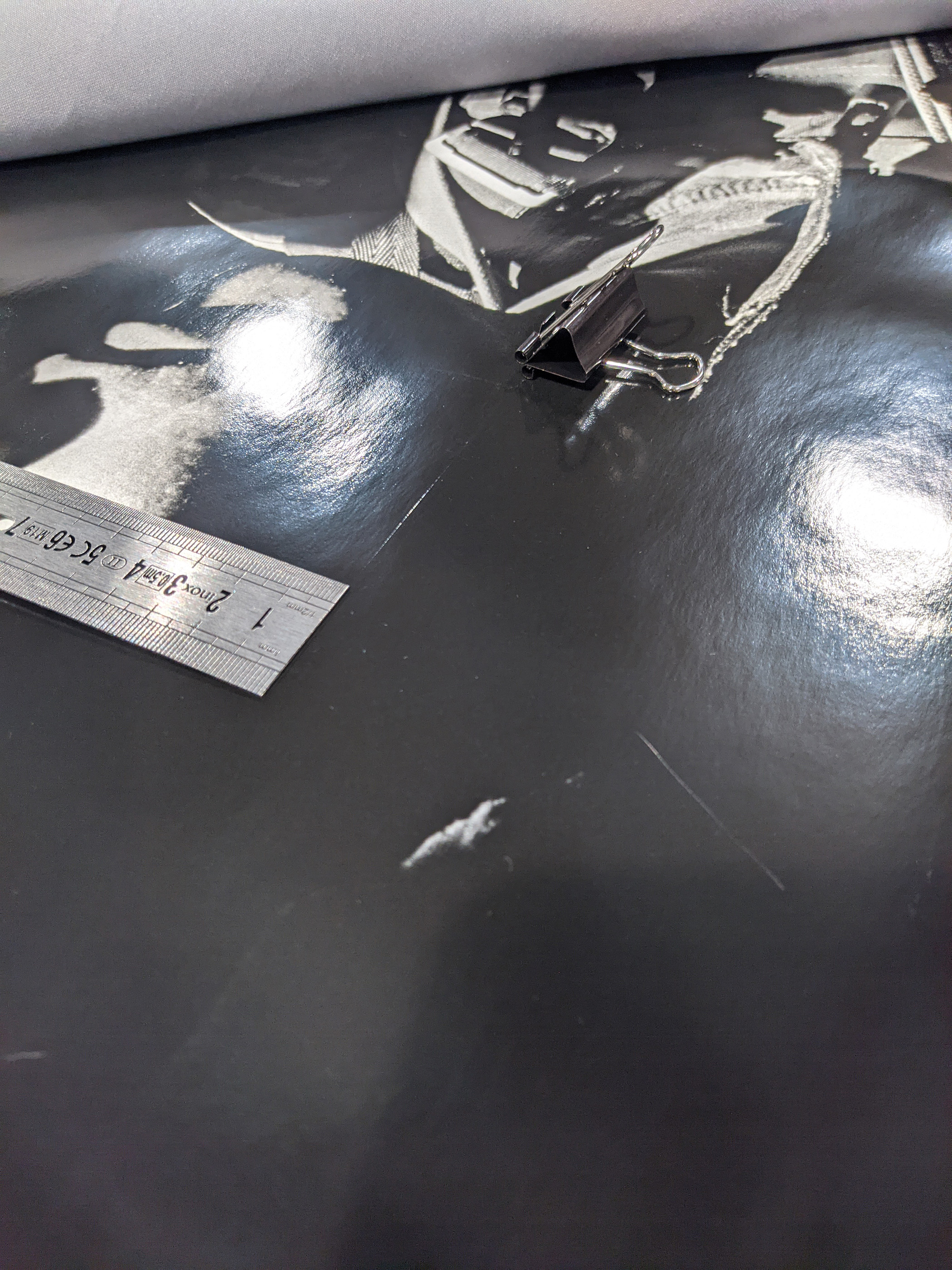

We had a very expensive experience this week.
Having an order to print and tone four 100+cm BW prints only after the dry mount press we found some very small scratches that were going over the whole print in al a line (sometimes continuous, sometimes disappearing and coming back again).
All prints had this scratch line in the same place from the side (about 30-40 cm) and going parallel to the side. Paper was 106 cm wide and 30m long roll. The client denied prints with idea that our AD52 auto-cutter made these with rollers.
We had to agree that we lose money at that time and reprinted the order. But the next time we cut paper from roll manually on the table. And then had the same - 4 prints exhibit the same kind of scratch along with the roll.
We think that Ilford while rolling the paper did that to the whole roll.
Bad thing is that we got 4 rolls of the same emulsion at one time...
If that is a new reality - that you could buy the scratched paper from the factory now and that would be only your own headache - we are just so unlucky?
Would like to add - one of the last rolls with Ilford surprised me with a "factory" diagonal rough cut made by hand with scissors.

As you already considered your roller cutter for the unexposed paper to be the cause, what makes you sure that the fault was not caused by your succeeding processing?
I assume there is some automation too.
Have you examined the artefact itself too? I know that is Ilford's task, but just out of curiosity...
No... processing was done in the tray..
Something like this:
Artifact looks like the scratch of mechanical rolling. But to our surprise not from rolling out but probably from rolling in.
I would try to make more images on other prints. Was too upset today when realized that it was not a one-time fault...
From experience I know that Ilford take the quality ot their products very seriously so I assume that you contacted them immediately you realised that there was a problem?
You should unroll non-processed paper and take photo of the scratch as it is in the paper.
And I can guarantee Harman will take this things pretty seriously.
Have you checked the bottoms of those trays and the hands of those working with the prints? And have you checked a piece of the unexposed paper for a similar fault?
Dry mount presses are also notorious for making all sorts of defects in prints too. As are squeegees - how do you wipe off the face of the print before drying?
I think user error can be easily ruled out by photographing same scratch on non-processed paper. No need to check equipment at all if the scratch is in unprocessed paper too.
I'd agree - though given the severity of the scratch, it should have been visible from the moment the lights went on in the fixer.

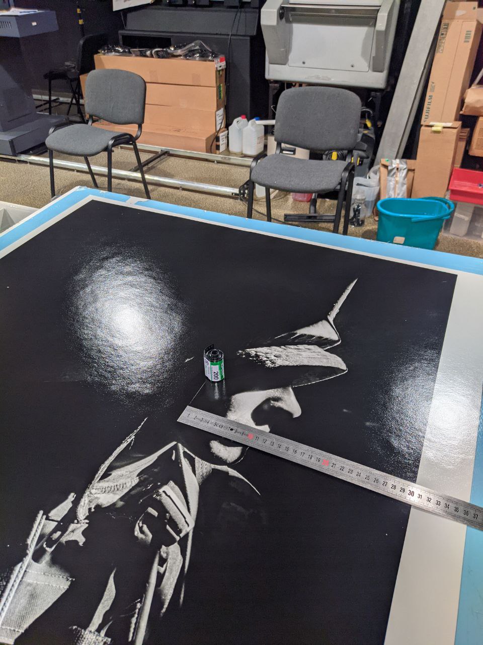

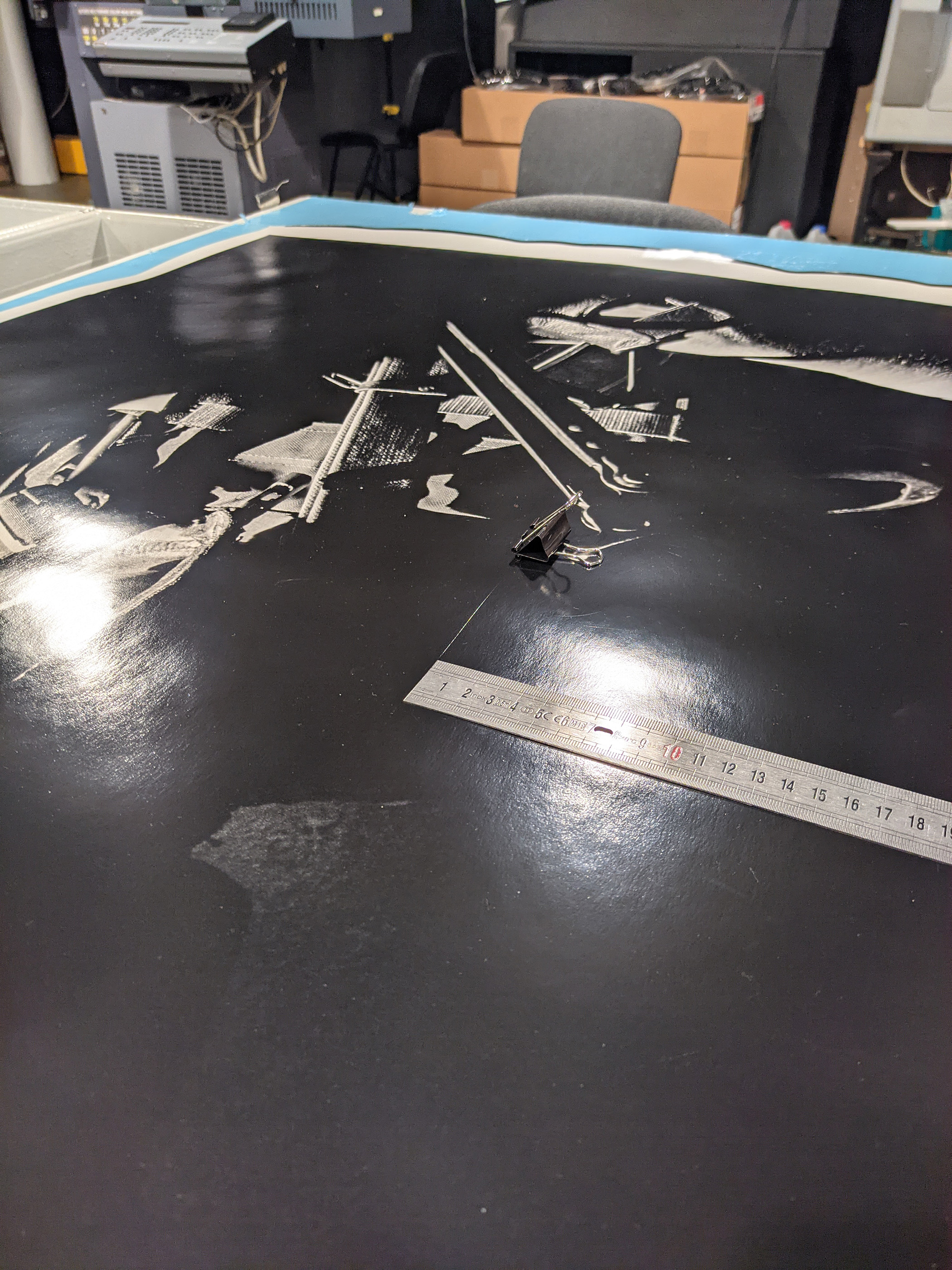

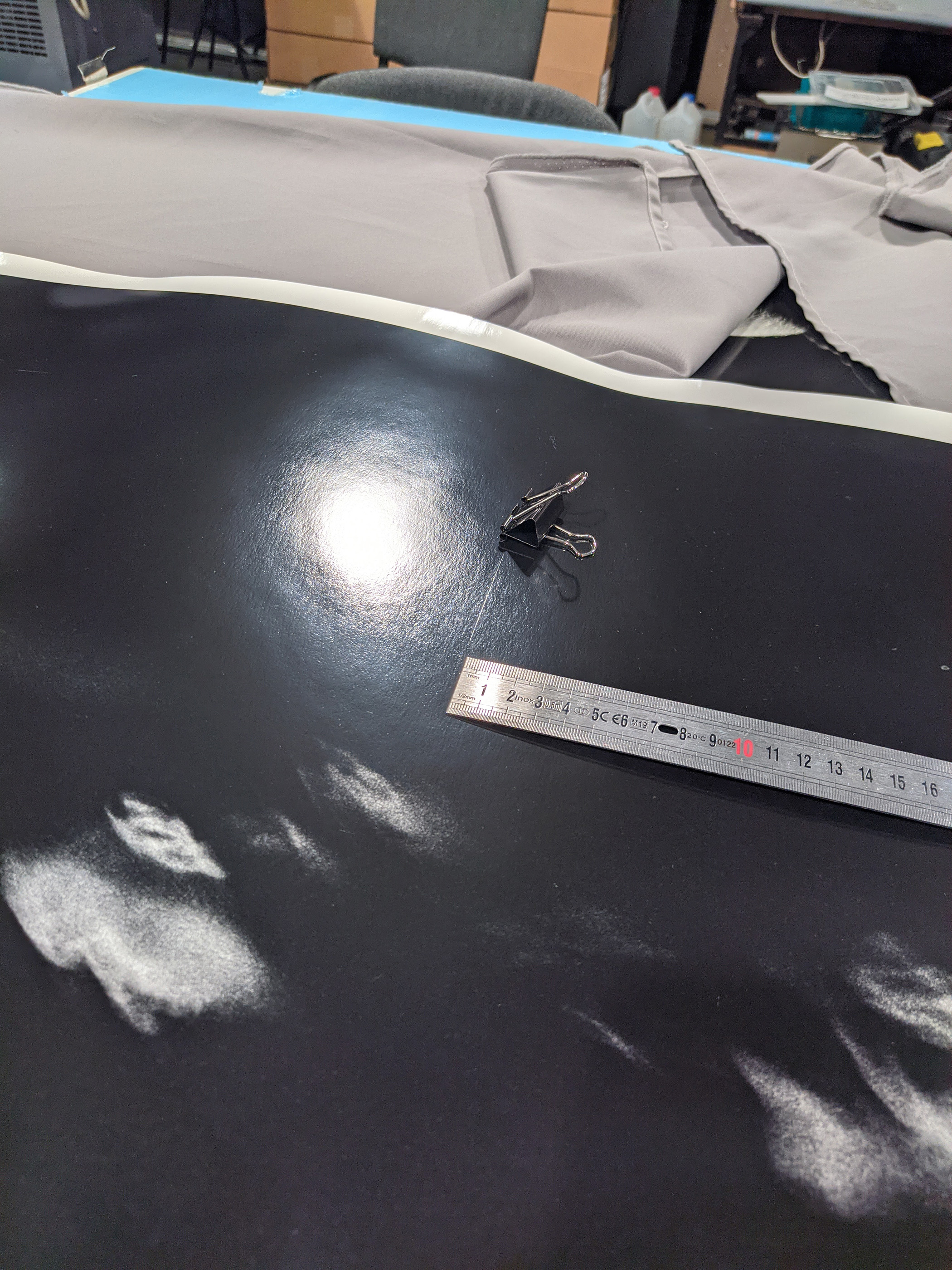

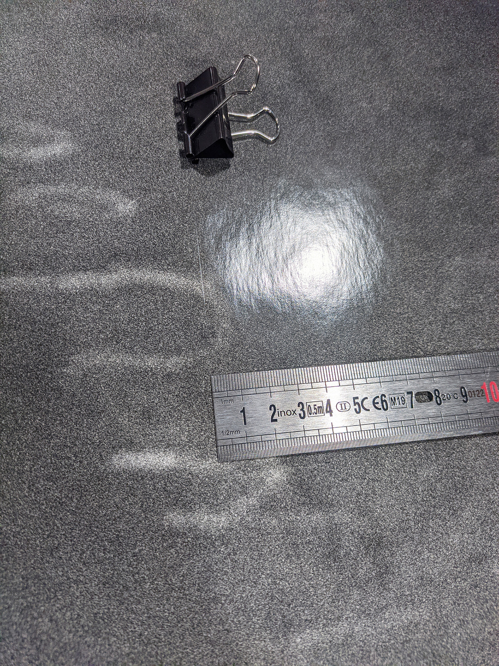

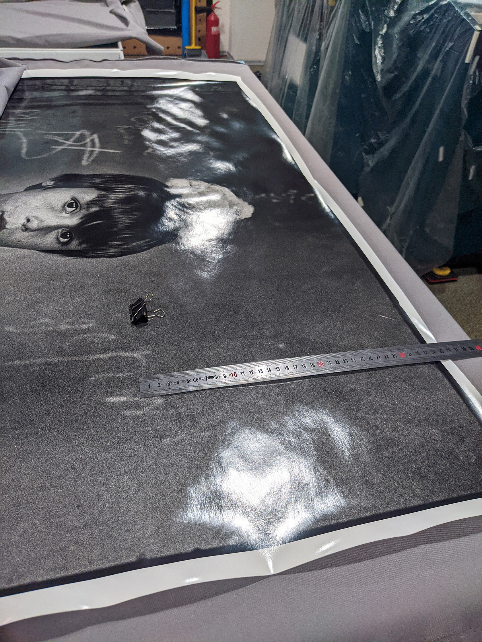

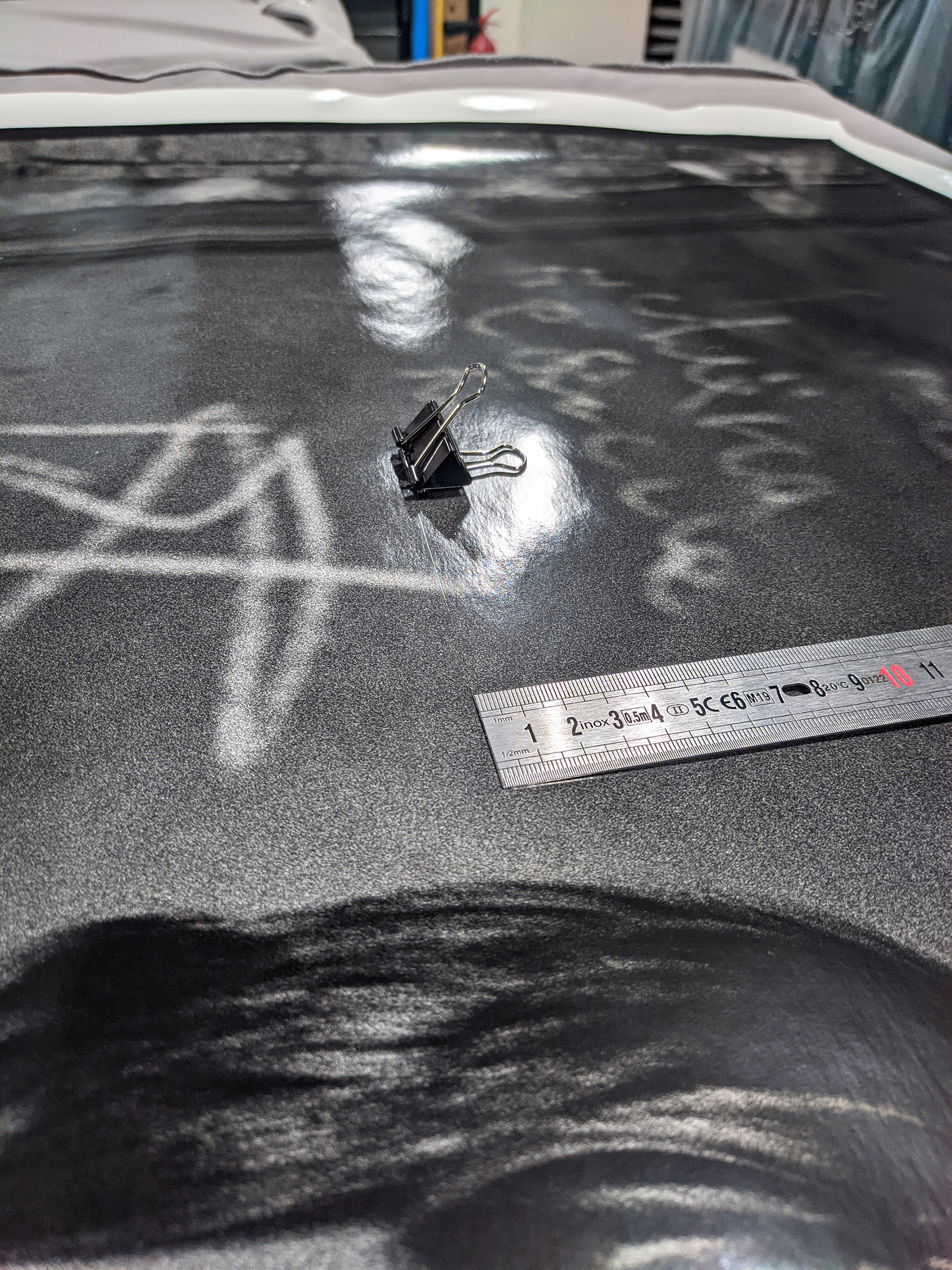

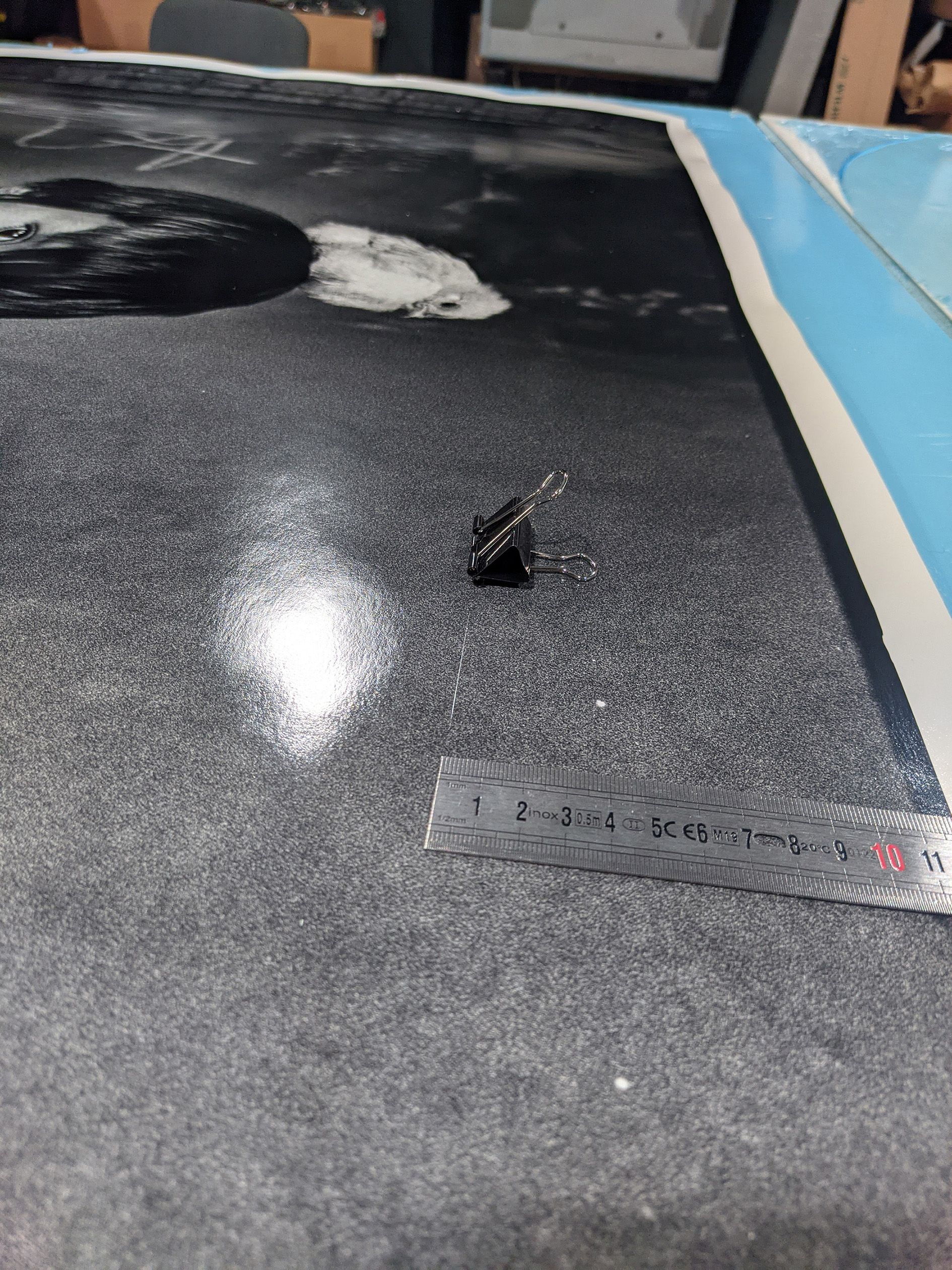

These are images of other prints with scratches from the same Ilford 106 cm roll of FB paper.

And we rechecked - they all exactly the same distance from the side (is the side) - 35 cm. That is why we first decided it was our AD52 cutter.
