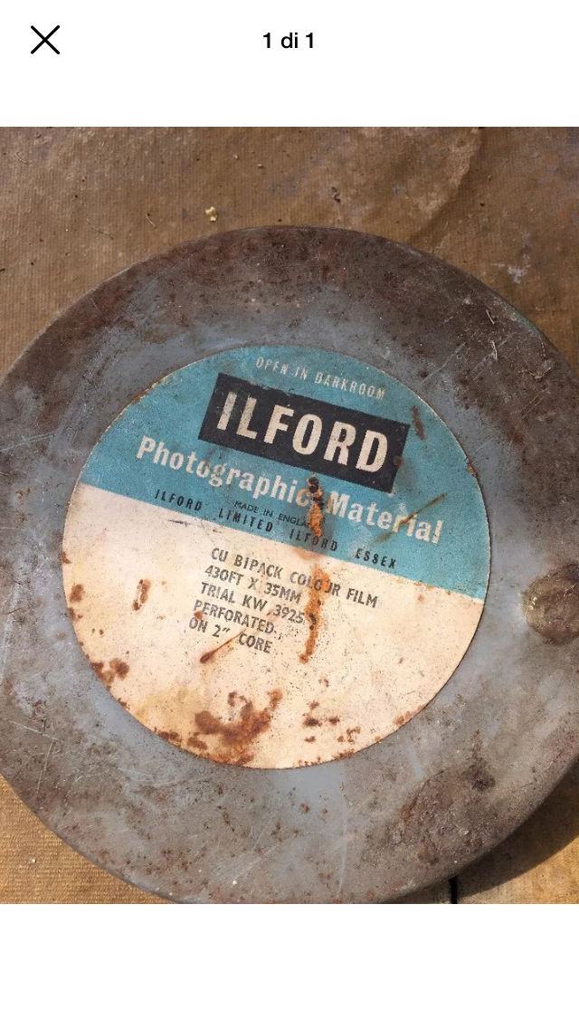

hi guys! this is my first post here!
i have bought a used film loader kaiser rebranded jessop and i got a surprice
It was loaded with a bulk
I ask the seller
he told me it is not certain but could be a Ilford colour film! in the picture there is no indication of iso!
does anyone have info?
i hope i did not ruin and i would like to know how to process it but first at what kind of iso should i shoot it!
Thank you in advance!

Quite a find. If the film belongs to the box then it has to be very old. Ilford has not been based in Essex since the early to mid 1980s. Others may remember when it last produced colour film. On the other hand someone may have had a spare empty drum and decided it was worth storing other B&W or colour film in it.
I'd try loading a few frames, exposing then developing in B&W chemistry. I'd treat it as ISO 50 maximum. As it is unknown there may a case for Rodinal Semi stand development. Even if it is colour there should be edge markings that will tell you what it is. You can then take things from there in terms of chemistry and times etc
Do not expect too much. Best of luck and lets us know how it turns out.

I ask the seller

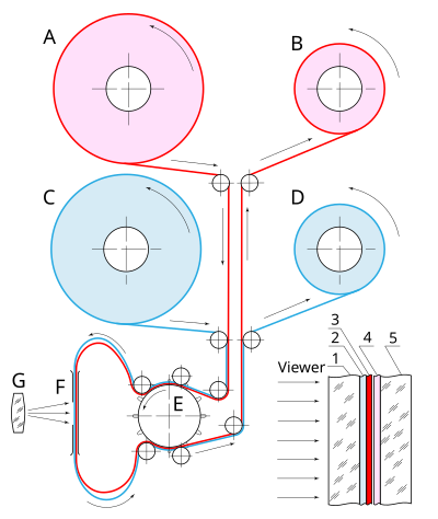

If the film is from the picture box, than perhaps, it is just only half of the bipack - b/w film with blue sensitivity and was made before WWII. The whole colour bipack system:
thank you, will give you updates!
