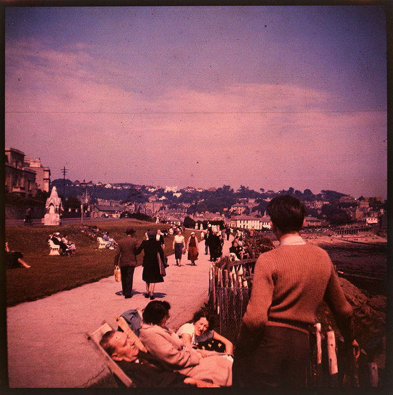

A scan of a Dufaycolor 6x6 transparency shot in 1956 when we visited my grandparents in Bristol, England.

Dufaycolor was only a toll-coating product of Ilford, not their own product.
Dufaycolor is a regular-grid, additive colour film.

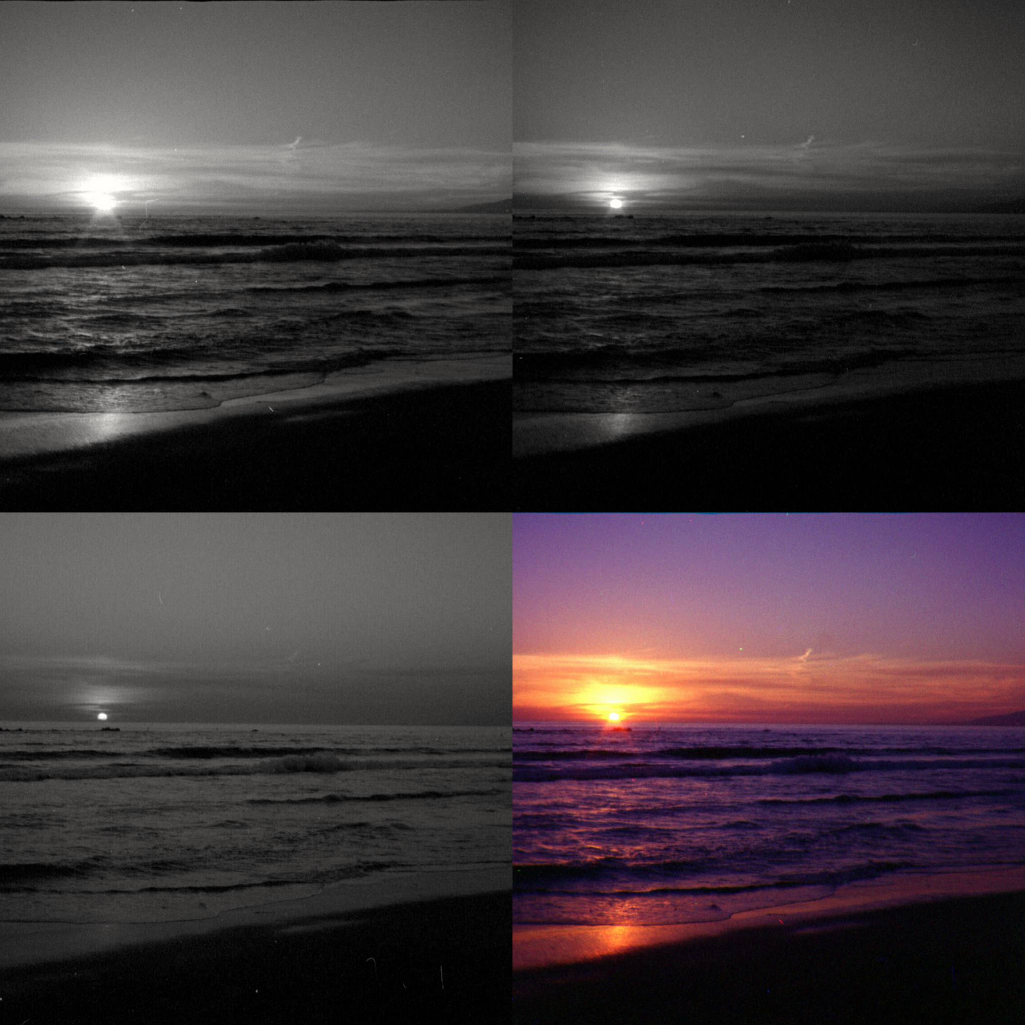

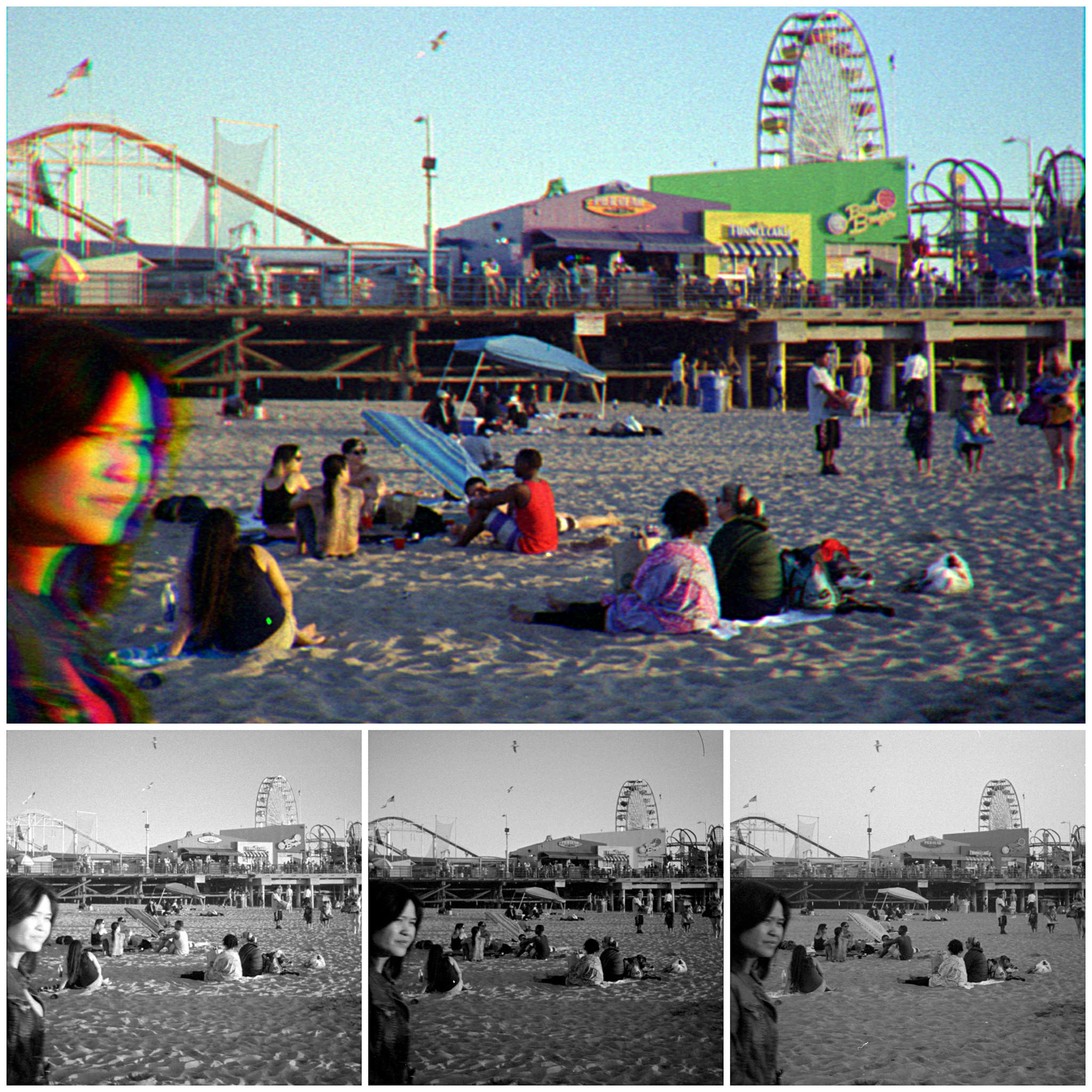

FWIW, I've had good results from Ilford Delta 100 & 400 and a Nimslo with RGB filters:
