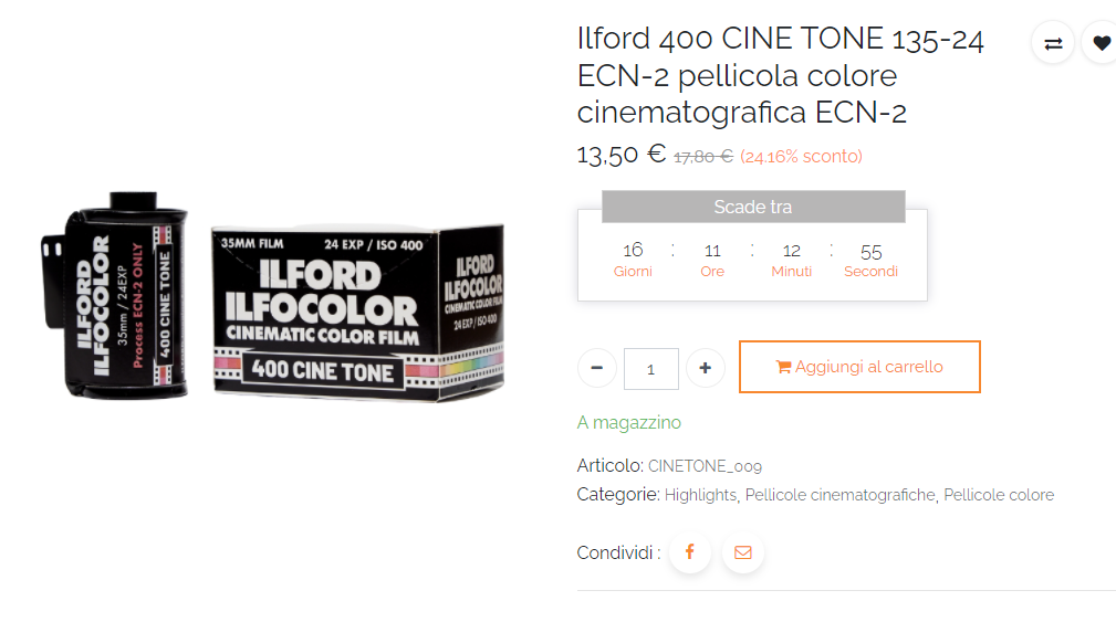

Anyway....is there any more news/info on this "Ilfocolor" ?
this popped up on an italian shop today
brbo
Dec 28, 2011
2,290
EU
Interesting...
So far there was Ilford Ilfocolor 400 Vintage 24exp. that was believed to be the same as Orwo NC500 (produced by Inoviscoat). Maybe this Cine Tone is NC400?
Ilford Imaging Europe website doesn't have any information on either Vintage or Cine Tone film...
MattKing
Apr 24, 2005
54,251
Delta, BC Canada
The Cassette says "Process ECN-2 Only".
brbo
Dec 28, 2011
2,290
EU
There isn't a colour negative film that won't give you a picture if you process it in ECN-2. Besides, Orwo says that you can process NC500 in ECN-2, too.
But, you are probably right, that "Process ECN-2 Only" probably is a clue that this is a Vision 3 5207 or 5219 with remjet. And if you look at the picture the base does indeed look like it has a remjet.
Should be interesting if this film appears in US. CineStill obviously will be forced to defend their "Cine" trademark. This film might get a new name, like "Ilfocolor 400 Motion Picture Film Tone". Just rolls off the tongue... :wink:

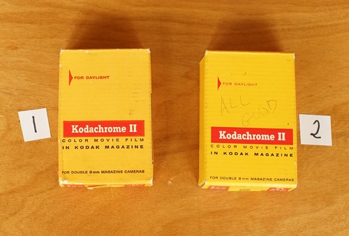

Kodak before the time of Super 8 called their home movie film "Cine-Kodak" in many markets.
Which ones? Did some searching on the auction site. Here is one from Oz of Kodachrome II 8mm labeled as movie film. Note pix of boxes indicating it was made in Rochester, New York:
