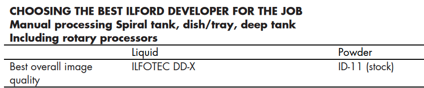

Taken from the Delta 400 datasheet.

Lets go back to the first post. The question was: how to select the right developer for Delta 400? Not what was the best, the question was about the process of developer selection.
In that regard, what is wrong with using Ilford's recommendation that best image quality can be achieved with ID-11 if one prefers a powder developer? It doesn't say that DD-X is the best, it says that is capable of best overall image quality, if one prefers to use a liquid developer. There can be may reasons to choose a powder developer over a liquid one, and it doesn't say that DD-X is better than ID-11.
If you look at the DD-X tech sheet, it says "Ilfotech DD-X is designed to complement the features of all Ilford films" - that's a pretty sweeping generalization.
