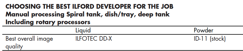

@Tsubasa indeed, I'm not really sure what @250swb was referring to in his response to your post. In the Delta 400 datasheet linked to earlier in this thread, on page 2, Ilford specifically includes ID-11 under the heading "Choosing the best Ilford developer for the job". Your suggestion to use ID-11 is literally what Ilford, the film manufacturer recommends for "Best overall image quality" for a powder developer (quote from the datasheet, page 2), with DD-X for those who prefer a liquid concentrate.

Ilford make a developer called DD-X for the T grain films they make, presumably they think in their eyes this is the best developer. But it does not stop them recommending other developers given not everybody will have DD-X or even in the long run like it. So to make an analogy, you have a map that says turn left, your satnav is saying turn left, and the road sign is saying turn left, but you say 'nah I've never been here before so I'll turn right'. Choosing the deveolper specifically made for that type of film is called a datum point, the place you refer back to, but not necessarily the place you end up.
I think it’s worth pointing out that there is no absolute ‘best’ choice. Every developer available will develop your film, some with speed loss but fine grain, some with full speed but soft image, etc etc. When Ilford says ‘best overall image quality’, they mean it gives a decent compromise of all these characteristics. So it’s a sensible place to start.
