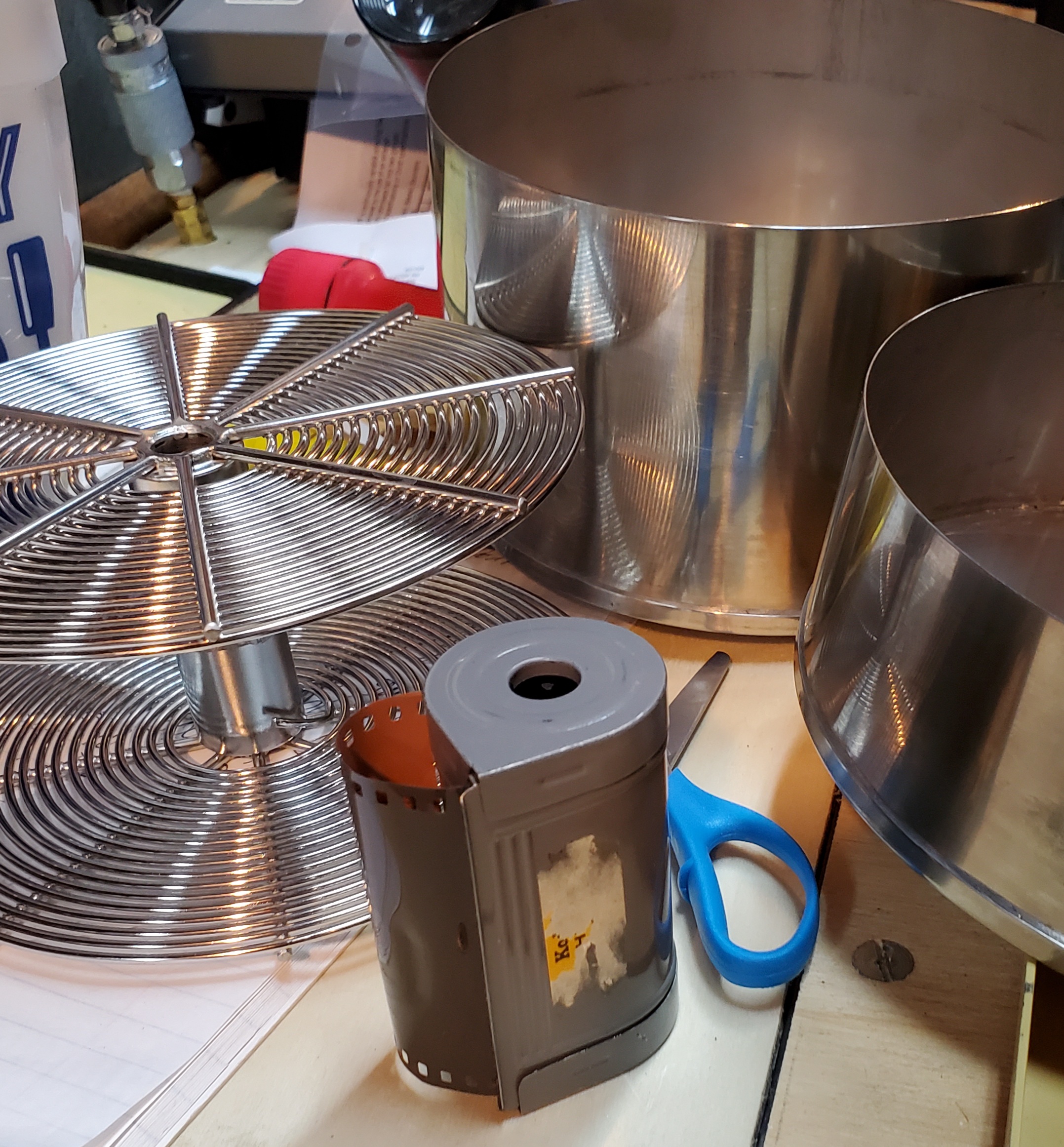

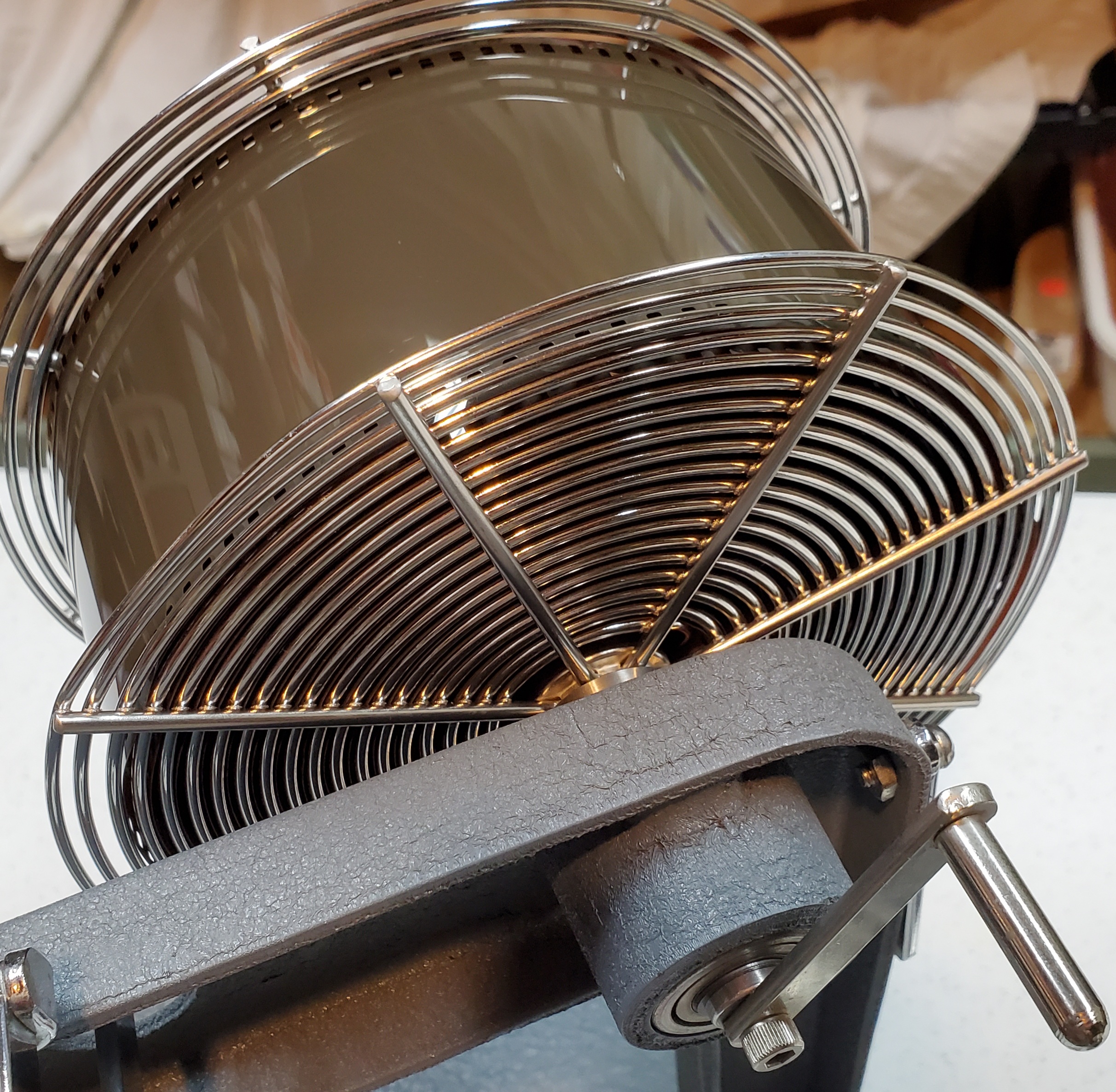

I wouldn't think it would be much different from loading 220. The film is about 8 mm wider, and once it's going on the reel well, an extra couple feet of length makes little difference. Given a choice, I'd prefer a Paterson type plastic reel, but I doubt anyone (with the possible exception of Jobo) has offered those in 70mm with enough length for the bulk load version (116 reels are the right width, but those will take a maximum of about five feet of length because they're the same plates for 35mm and all the other formats they're made for are the same length or shorter).
I had a 70mm reel, but plastic, large Jobo tank with a huge reel for developing Hasselblad back, 70mm (cassette) films.
It was a good tool, but this was in the early/mid 1980's and I loved everything photographic, so loading it was no something I took note of.
Loaded and filled, it was a bit of a handful, but it was more difficult to complete shooting those large rolls of film often enough, to become 'expert' with the handling of it all.
I ended up just shooting colour negative film, and letting a lab develope them, when finally completed, and 120 for everything else, so I could get back E6 colour slides in a few hours and do the black and white myself.
If the hight is correct on that large steel tank, for the 70mm stuff you've shot, go for it, but use wide duct tape to join the top and tank, because you'll want them to stay together, should that heavy, wet tank, take a fall.
You might also want a wide enough board to catch a falling tank, if your sink is ABS or other plastic, just in case.
IMO.

This is mostly an "experience" than a future practice. I have 4 rolls of VPS I bought from Ebay. The reel and tank are 70mm Nikor tank. I have plenty of chemistry. This is mostly a I want to give it a try. The film has been curled up for over 25 years. Will be interesting. :whistling:

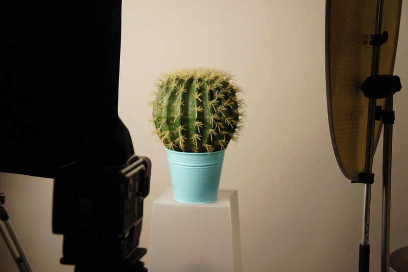

Shooting 70mm ELM tests 24 exposure rolls 100 Planar 2 by Nokton48, on Flickr
Here I am test exposing three A70 backs, with the Hasselblad 500EL/M, with the 100mm T* Planar, one of my sharpest Blad lenses. Broncolor C171 Pulso Monolight 1/8 power measured with Broncolor FM2 Incident Flash Meter. Made 1/2 stop bracketed exposures around the calculated median exposures, rating Rollei 400s at EI 100, then original 1981 Plus-X (luscious and amazingly still good) rated at EI 50. Finally Kodak WL Surveillance Film rated at EI 250. To me this film is like a cross between Eastman XX and old Tri-X formulations. I'll bet it pushes really well for higher EI's. 70mm and a motorized camera is great luxury. Hasselblad used to call this combo the EL/70 which you could buy as a package from your local dealer. If you shoot Blad 70mm you should buy an EL/M and try this. The 24 exposure rolls can be developed in my Patterson homemade 70mm spool rack, I will prolly use ADOX Borax Replenished which I know works well with the WL Surveillance. Rollei 400s I have developing in Rollei Supergrain from Freestyle.
Will be good to see the bracketed shots. And I can adjust development if I see fit.
Nice kit and film combos.
