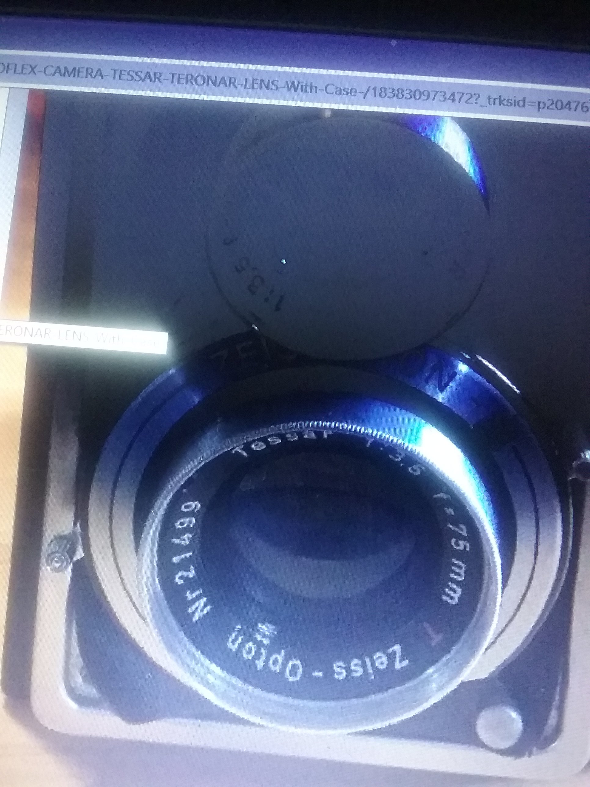

I have purchased an IKOFLEX that is somewhat of a mystery. The seller did not know the model nor do I. It has a 75 mm 3.5 OPTON TESSAR T with a 5 digit serial number.21499. I have checked ZEISS serial number lists but this number indicated 1907 or thereabouts. It can not be for this camera. Can someone help with the model? Any assistance will be appreciated.

Can you post a picture? Is the serial number on the lens or the body?

I am trying to post a photo but not successful so far. The serial #is on the lens

I know BUTKUS.ORG. The only photo that looks similar is of model 1 which to my understanding was produced until the 1950's.The camera has not arrived yet so it is not possible to know the body serial number.The photo that I posted came from sellers photos.
Carl Zeiss split after WWII. The West German Carl Zeiss in Oberkocken (with lenses marked ZEISS-OPTON) used their own new serial numbers, while Carl Zeiss in Jena, East Germany, continued the "old" serial numbers. The Tessar on your camera is from the early post-war period, 1946-47.

It seems to me to be a late Ikoflex I 850/16: http://camera-wiki.org/wiki/Zeiss_Ikon_Ikoflex_II

I have the same lens on a Rolleiflex Automat MXV and it's excellent. My gut feeling with such a low early serial number is it's an Ikoflex 1 850/16 Lps with a Prontor-S shutter. The Compur factory was badly damaged during the war and it was sometime before volume production resumed.

It was made in 1936. The Opton Tessar is coated so it has better contrast. They should in principle have equal sharpness, but there is some sample variation so you'll have to compare them. I have pre- and post-war 3,5/75 Tessars and they are excellent.

Yes, it says Ikoflex I 850/16 Lps and Prontor-S in the link I provided. The Ikoflex I (a, b and c) continued to use Prontor-S and Prontor-SVS shutters till 1960 to keep the cost down on these cheaper models.
This particular camera may have a flash contact, since it's a late 850/16. Earlier ones looked the same except for the flash contact.
