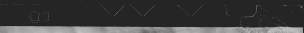

1. One triangle, "Eastman-Kodak", and a sheet number.
2. Square, triangle, small gap, double triangle, sheet number.

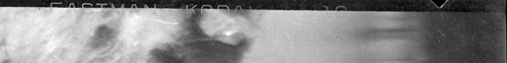

3. Three triangles with small gaps in between, "Eastman-Kodak", sheet number. The gaps are too wide for Tri-X, I think.

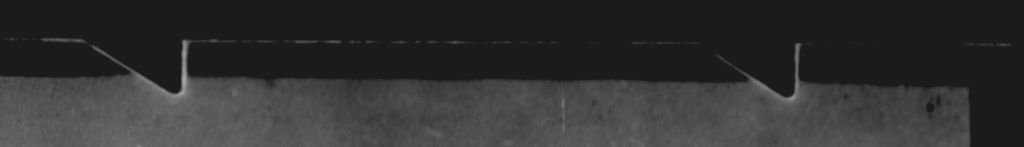

4. Two "sawtooth" notches with a gap in between, no markings.
#1 could be Verichrome or Super Pan Press B, and I'm not sure if the edge markings help to confirm that. Some of the images might be too old for those stocks, and maybe it's an early stock with a generic notch that doesn't code for the specific film?
#2 is mysterious to me; it's a complex code that surely identifies a specific film stock, but I haven't found it in any reference so far.
#3 looks like the notches for Pan Matrix, but no one would use that pictorially.
I know about the square/triangle coding for safety/nitrate films at Kodak until 1949, but with no date information that doesn't help very much. Does anyone recognize any of these?
Thanks in advance
-NT

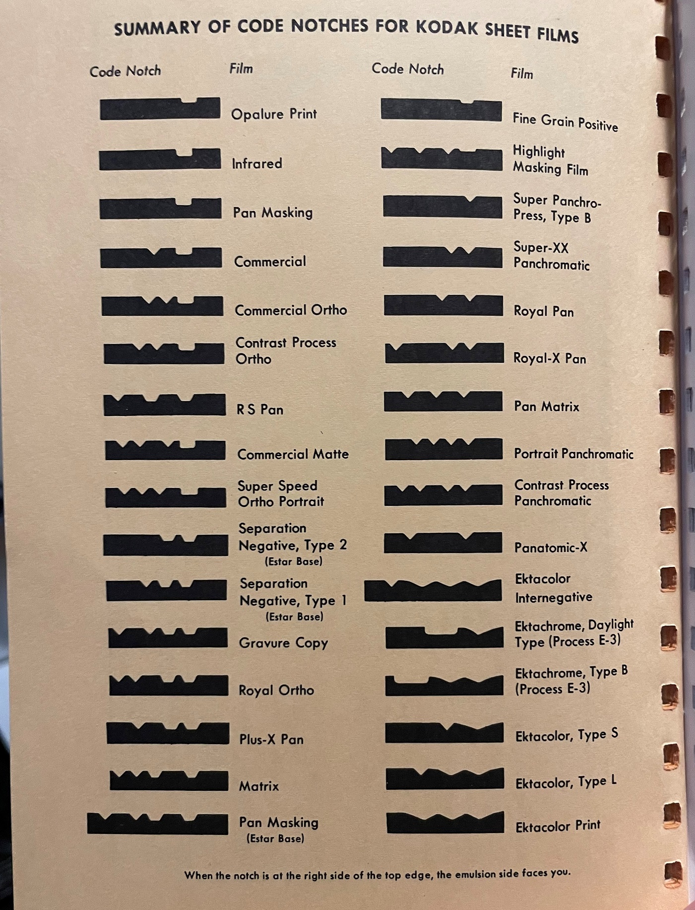

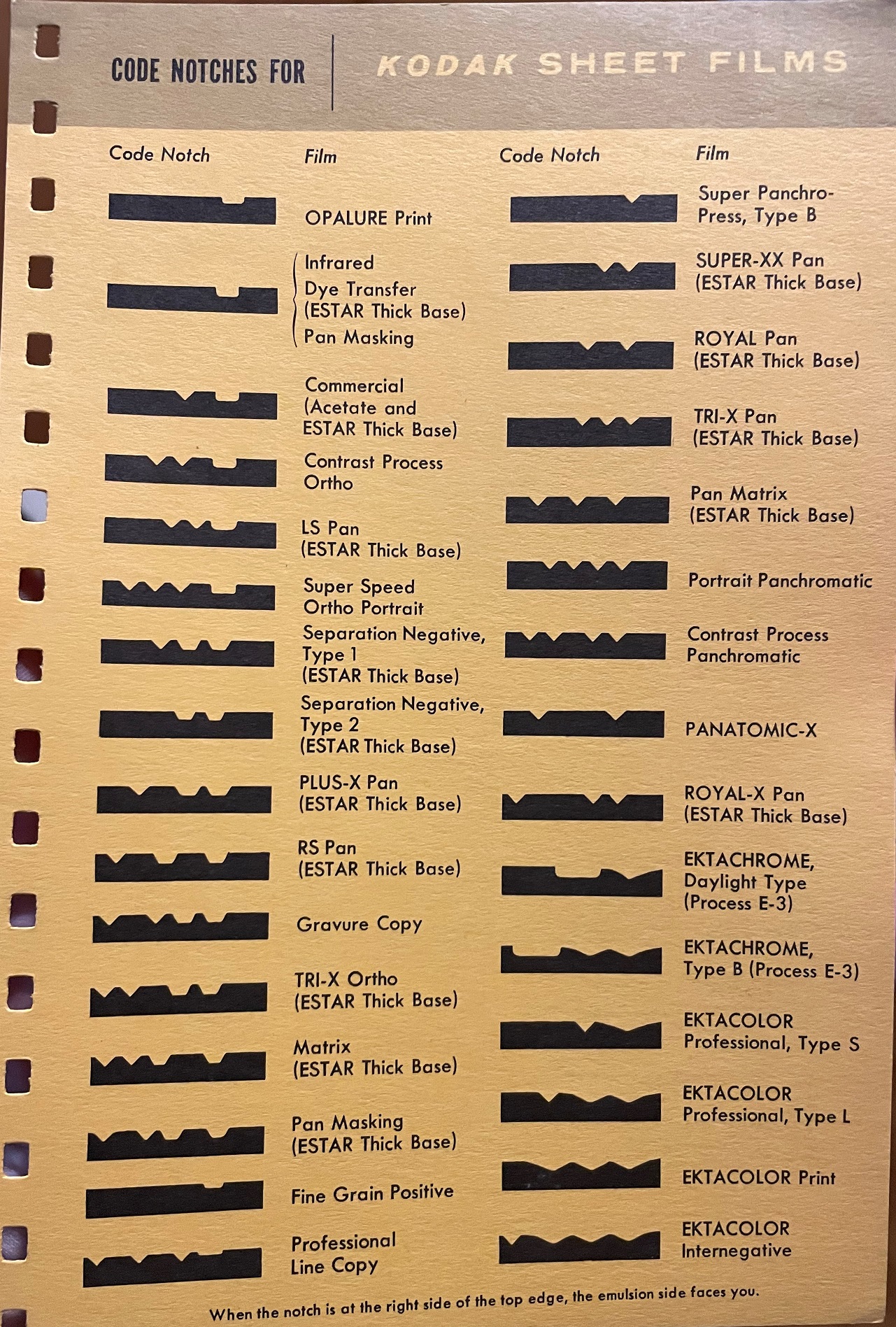

Looks like:
1. Kodak Super Panchro-Press, Type B.
2. Kodak Commercial Matte Film.
3. ????
4. ???? Looks like some form of copy film, the notches are not typical, or it could be DuPont, Agfa, etc...

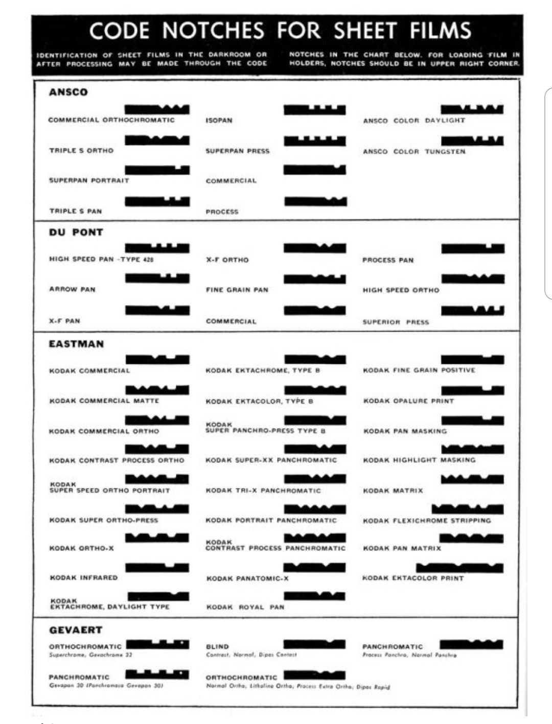

A couple of old edge notch charts:
#2 doesn’t look quite like Commercial Matte to me, because there’s a gap between the square notch and the first triangle. It seems like it would be a weird pictorial stock, too, though it’s always possible that I have some copy negatives.
When was SPP-B introduced? I’ve got one or two images with that notch that I think are pre-1930, too early for Verichrome but I don’t know about SPP-B.
-NT
