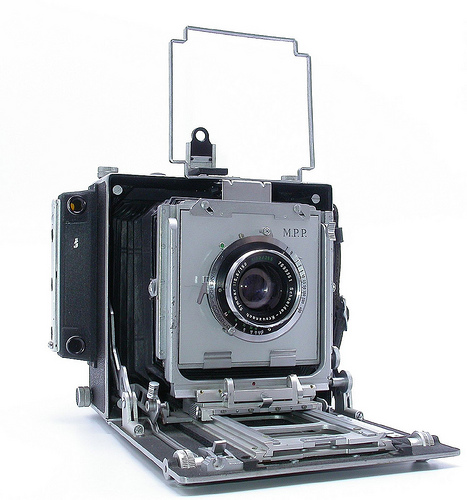

If you were in the UK I'd recommend that you look for an MPP MkVII with a 150mm Symmar (convertible) lens. They are field cameras that also have a rangefinder for hand held work. You view the subject when making the exposure hand-held through a wire frame "sports" viewfinder, which folds out of the way when not needed. There is a substantial strap on the side that makes holding it a safe prospect. On a tripod they give you a very wide range of movements for both the front and the rear standards. They are built to a high engineering standard and close up with the Symmar in place, protecting it inside its all metal construction. The revolving back makes swapping from horizontal to vertical format a very easy process. A very versatile tool and ideal for your purposes...
The MPP range finder will only work if the cam is calibrated for the lens. With these cameras passing through so many hands and a large variety of lenses capable of being fitted, it is almost impossible to find a matching cam. That said, it is possible to cut a new cam, but you'd need to do this for each lens, and if you use a convertible, two cams would be needed.
Despite the cam issues, the MPP is still a nice camera - Robust, simple to use, and reasonably compact.
