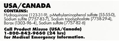

I just received a few 5 liter boxes of ID-11 from B&H and the USA ingredient listing shows Sodium SulfAte in addition to Sodium SulfIte. What is the SulFATE for? I thought that's only for tropical developers and some stop baths. I've never heard of this addition to normal MQ borax fine grain developers.
Are you positive the MSDS says sulfate? If so then it is probably a typo. The following is Ilford's specification.
https://www.freestylephoto.biz/pdf/msds/ilford/ID-11_B.PDF
The picture of the box for ID-11 on Ilford's website includes the following:
But why sulFATE added too? Just wondering. I never knew it was a D76/ID11 variant and what does it do? Tropical use?
