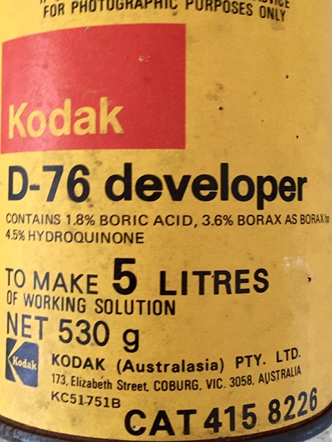

There are many versions of D76, the Kodak version has changed over the past 100 or so years
Indeed, and these posts from 3+ years ago
and other ones that thread provide some (IMO) evidence that the current commercial Kodak D-76 is buffered with 4g borax + 2g boric acid. Somewhere between "historical" D-76 and D-76d. ID11?? IDK.

There is some evidence that the formula changed. See above packaging from Kodak Australia, which lists boric acid as well as borax, which would improve buffering. That might help if not using it single shot.
