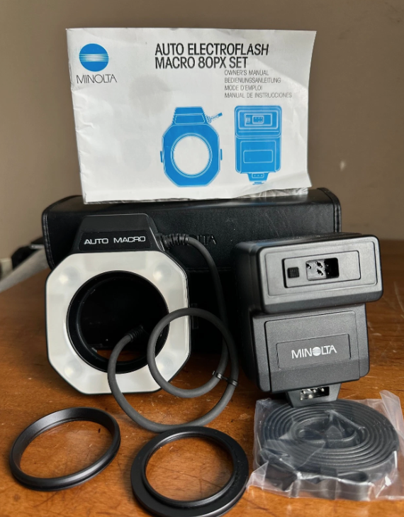

That 50mm macro on the X-370 is a great setup. My father-in-law used one on an X-570 to photograph the orchids he was breeding. As part of the MD system, Minolta also made an “Auto Macro” circular flash to mount specifically on that lens. I got one from KEH and plan to use the system, as you are, to learn macro photography. The flashes are $50-100 on eBay.
Edit: In a senior moment I forgot that this will begin on our next vacation in an area where lots of flowers are grown commercially.
Thanks for the advice. Is this the unit you are referring to?
