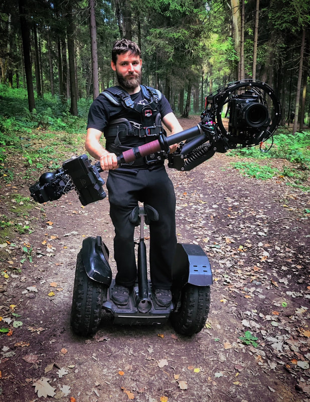

Have you looked into the Steadicam or similar mounts? The clever aspect of the Steadicam is that it doesn't use a gyro or similar powered stabilizer, even though many people think it does. It uses weight distribution to let gravity damp the motion of the camera. Of course, the full Steadicam is a rather involved rig.
A current trend among videographers and action-camera (like Gopro) users is to use a much smaller gimbal mount (often powered) that stabilizes action shots. These can be not much larger than a handheld microphone, for small cameras. I think the issue is that in-camera image stabilization isn't sufficient for video type uses where you are actually tracking and want the image to move, but without handheld shake; the stabilizer aids that. I know someone who uses one of these gimbals for videos while trail running.
I think my point is that even with digital stabilization, motion photographers need an external solution, but the gyro is likely already disfavored except for extreme use cases like aerials.
Every Steadi-Cam operator I ever worked with was built like a football player. And that includes the female operators. I take it as a sign that quite a bit of strength is required to manage the rig.

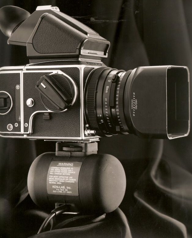

I will settle for one of these
There is one on ebay now but in the picture they have it mounted wrong. There is no stabilization 90 degrees to the axis of the sausage. That camera will fall flat on its face.
