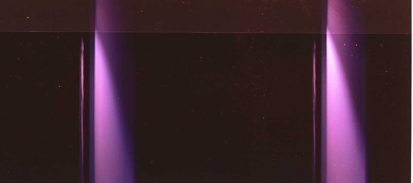

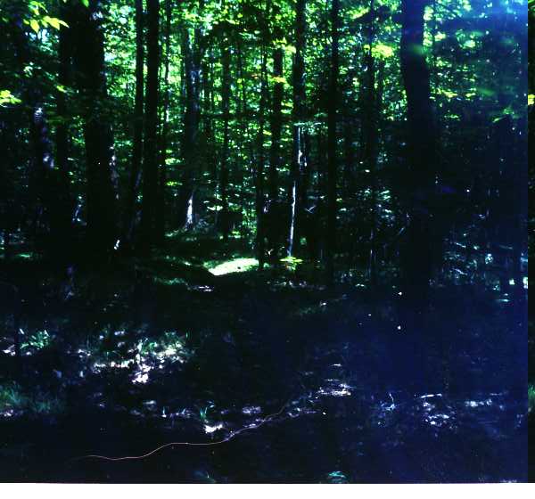

Great idea! I just got the rolls developed a few weeks ago and hadn't even looked at them yet. Now I wish I hadn't. Looks like things went awry from the very start, starting with me. I shot these handheld and it went from bad to worse to blank. Thats the case intruding on the lower part of the image. Guess I couldnt see that on the ground glass. Looks like there are other issues here, and clearly I need to hire a new photographer who uses a tripod lol.
Now I know why I got it for $15, or whatever it was. On the bright side, my C330 works fine.

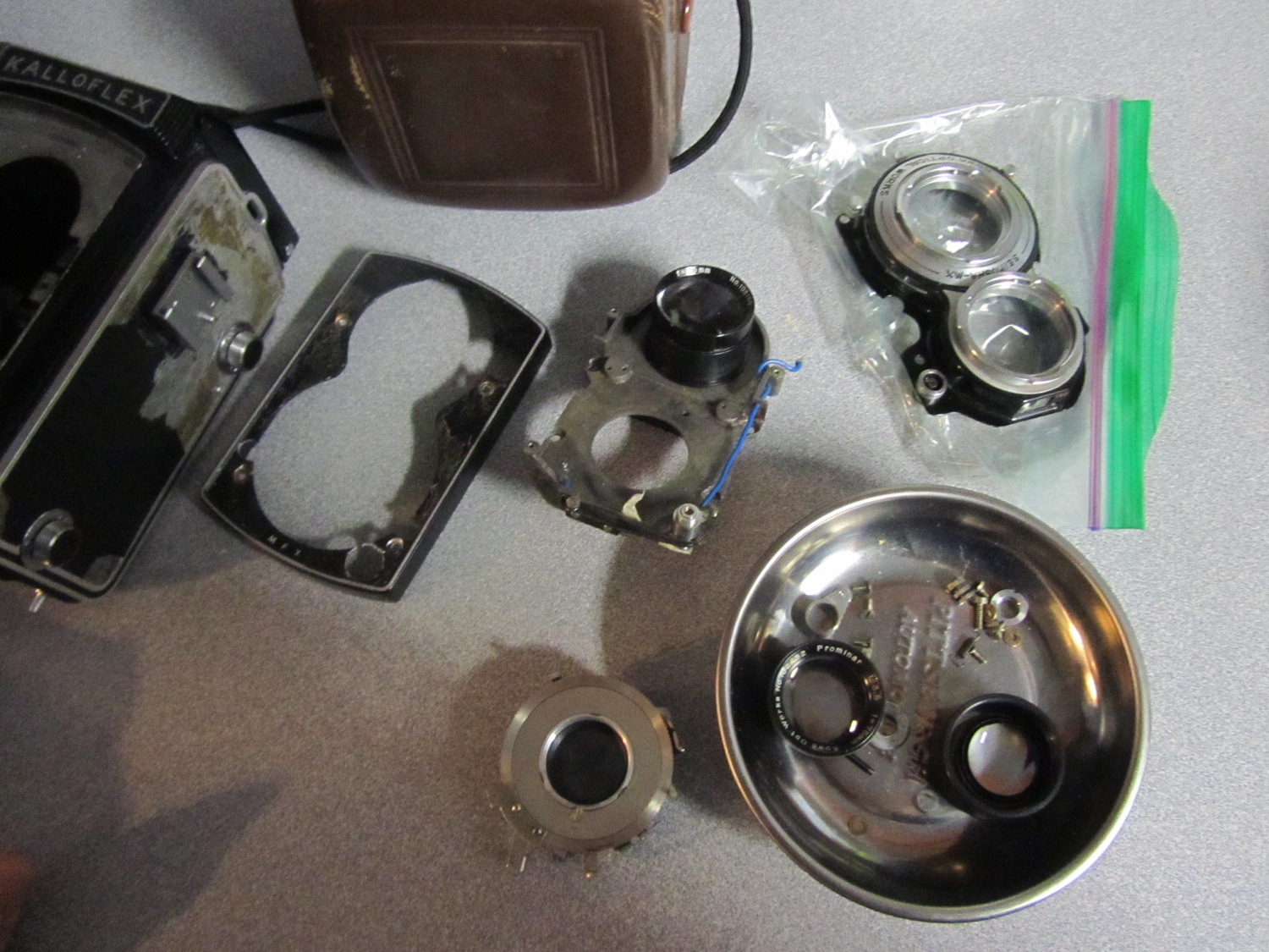

Well I got it back....sort of. :cry:
Well, that's bad, but it's not hopeless. Doesn't look like he got far enough into it to make reassembly impossible.
It's a pretty basic TLR and they all go back together pretty much the same.
Yeah but it hasn't been fixed, so putting it back together doesn't get me anywhere. When I stopped by to pick it up he kept saying he could fix it in a couple days, but he only had about 300 days to do so. I don't think he's fully compos mentis anymore...and being in his 80s I thought if I left it any longer I might never see it again.
What exactly was the problem? I never got a real sense of what the issues were in your prior posting.

Its been so long I don't clearly remember. I know the shutter was acting up, IIRC it just stopped working sometimes. Then there was the edge issues in the film, that I pictured way up above in post 29.
I contacted Mark Hama last winter, he said about $200 with shipping. I don't have $200 to put into this camera, which is why I took it to the old guy...
Going back and looking at the color images, it looks like most frames are double exposures with a slow/sticky shutter. The blank frame with vertical bars appears to be light leaks along the channels of the back; probably needs new black yarn in the channels.
