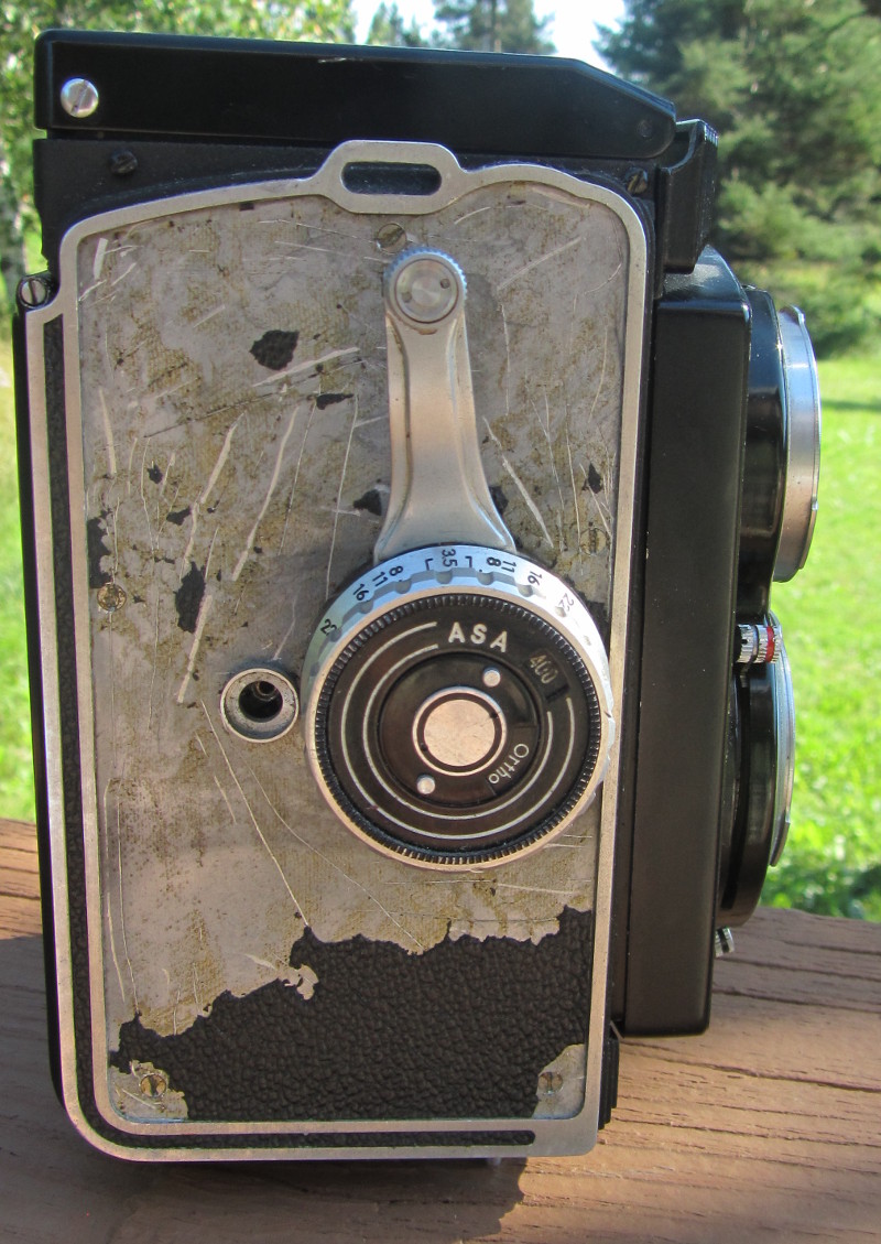

I've entered the extremely rarified air of Kalloflex ownership. :D And despite the looks, it works! Some new leatherette and it'll be in fine shape again. And you can't see the sides anyway when its in the leather case, which is in great shape. Unfortunately there are no lens caps and I doubt I'll find any.
The lens pics make it look like there's a rummage sale of scratches but in fact there are none. I think the strap from my point n shoot bounced and reflected around in there because the lenses are pretty clean.
So, for the 1 or 2 of you who also own one of these pups, what should be in that hole next to the wind lever? You can actually see the gears moving when you turn the lever, which can't be a good thing.

Hello from another Kalloflex owner! The hole next to the winder is supposed to be the double exposure release switch: From the manual: 'Intentional double exposures are possible. To reset the shutter without advancing the film, push down the release button at the back of Focusing knob and turn the crank counterclockwise (backward) one full turn.'

Guess I need to McGiver a double exposure button, though I rare do doubles. Thanks Chris!

Darn. The shutter is knackered. It was working at first, and worked through the first roll, but then it went tits up and doesn't open when I trip it. $175 for a CLA alone, so I might have a fine looking paperweight.
try naptha on the shutter, worth a shot.
It appears to be significantly longer center to center than the Rollei.
Actually only slightly longer. My Rollei and Yashica covers are just a little too short to fit my Kallo. I keep meaning to order an El-Cheapo plastic cap from the auction site for mine. The odds of finding an actual Kowa cap are even slimmer than finding a Kalloflex in the first place! And yes, the filters are Bay 1.
The shutter on mine is slow but working. I haven't gotten around to trying naphtha yet. Too many other cameras to tinker with right now.
The shutter seems to trip, but doesnt open. Its not slow, it just doesnt open at all and yet you have to recock it after tripping it. It sounds almost like its set on a super fast shutter speed, but it definitely isn't opening even for 1/500th. Never had that happen on a camera before.
Yeah, your shutter blades have glued themselves down. Try naptha with a qtip after taking out front and rear lens cells. Use sparingly, swab gently. Alternate with 99% alcohol and be patient. Might take a day or a week of periodic cleaning for it to free up...
