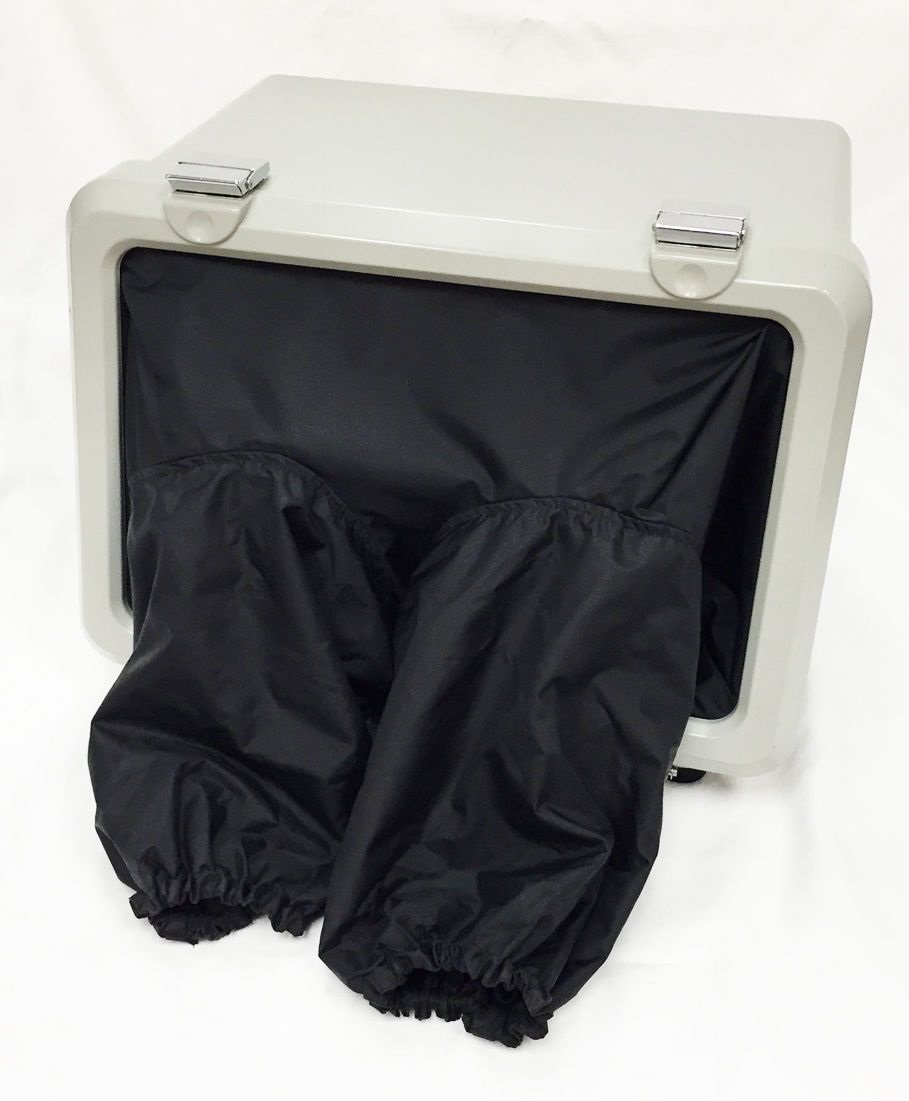

foc
Jun 30, 2010
2,573
Sligo, Ireland
How about a dark box for film loading, like one of these.
I know they are not cheap but they have a more roomy interior than a dark bag and may suit if you can't blackout a room or cupboard.

runswithsizzers
Jan 19, 2019
1,973
SW Missouri, USA
I put a cardboard box inside my cheap cloth changing bag. It seems roomier and less restrictive inside. With the sides as reference points it's easier to organize. The front of my box (arm side) is completely open; I left the back side closed for ridigity, except for an opening big enough to put the tank through.

gone
Jun 14, 2009
5,504
gone
Putting a box w/ short sides on it into the change bag is a great idea. Having a bag that's big enough is a big help too. I decided to just cover the bathroom window and block the light from around the door. I take the tank and film in there w/ a chair and a folding TV tray to set things on. If I'd set that box on the TV tray w/ the tank and reels in it, I wouldn't have accidentally knocked the tank's reel tube onto the floor yesterday, which caused a small bit of debris to get between two frames on the film.
