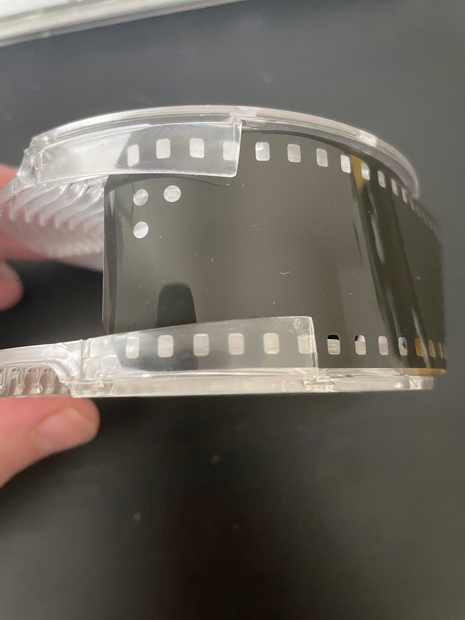

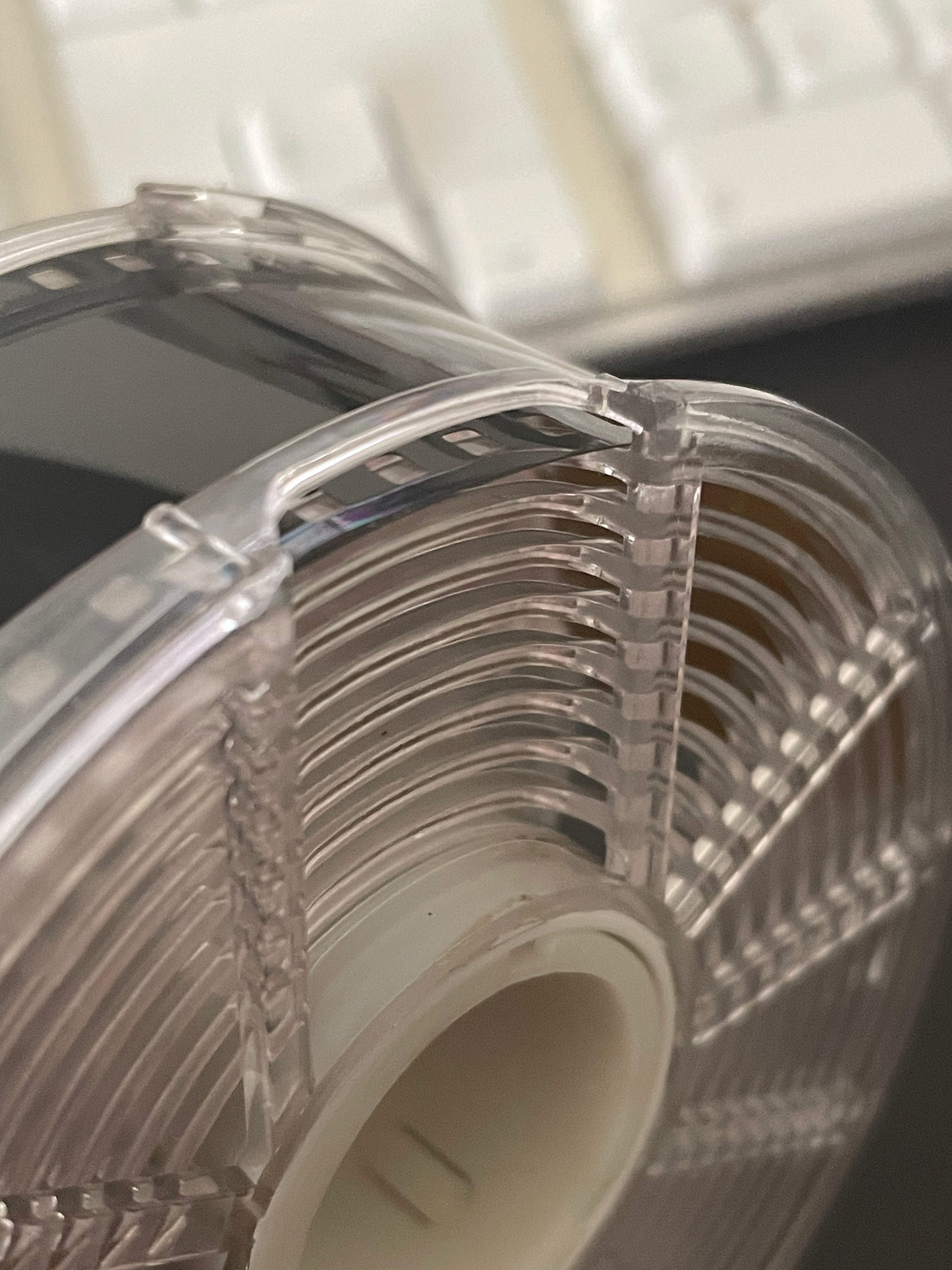

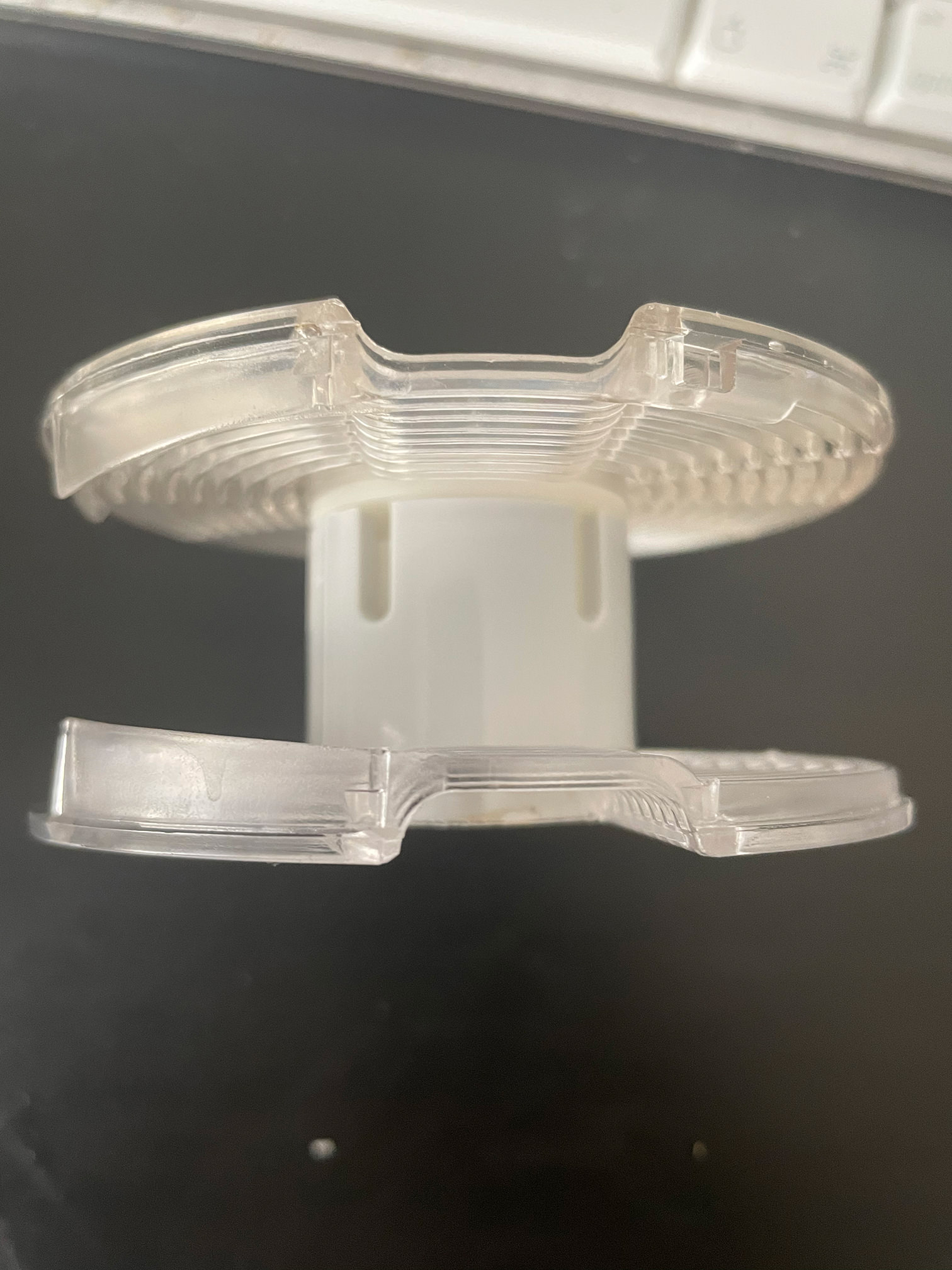

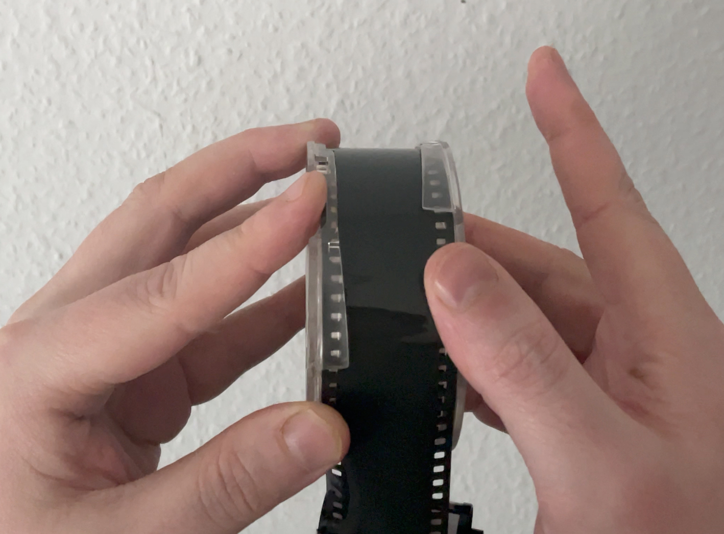

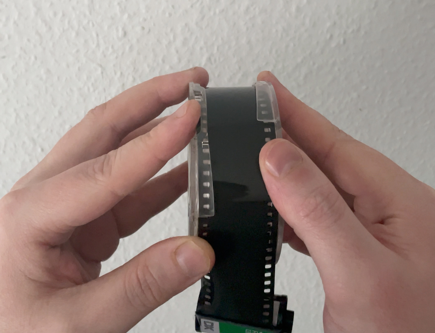

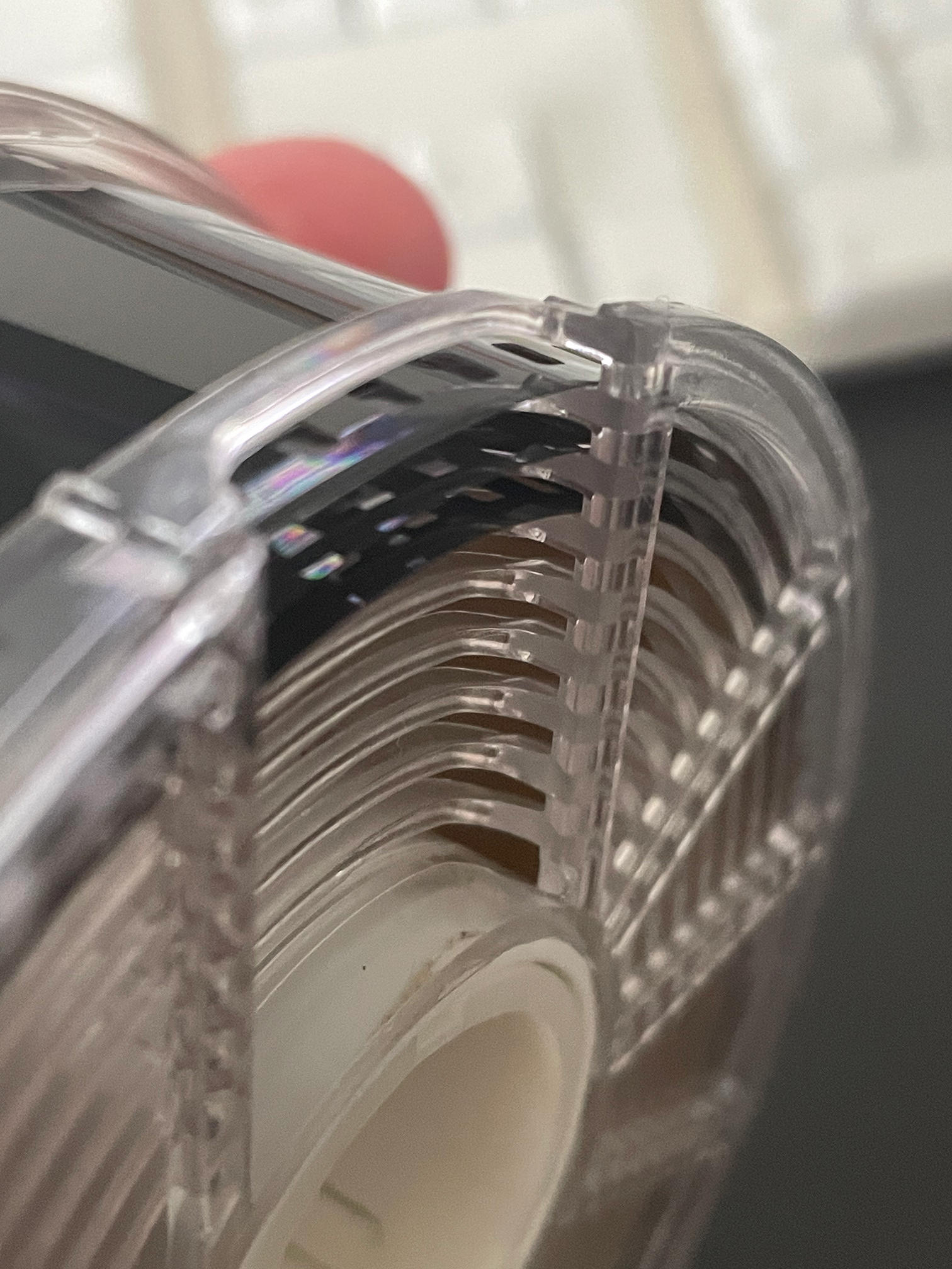

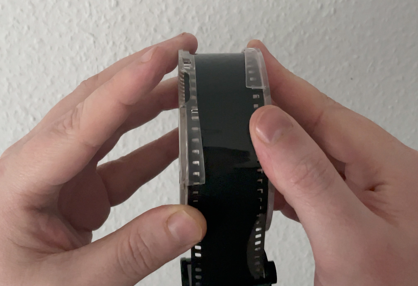

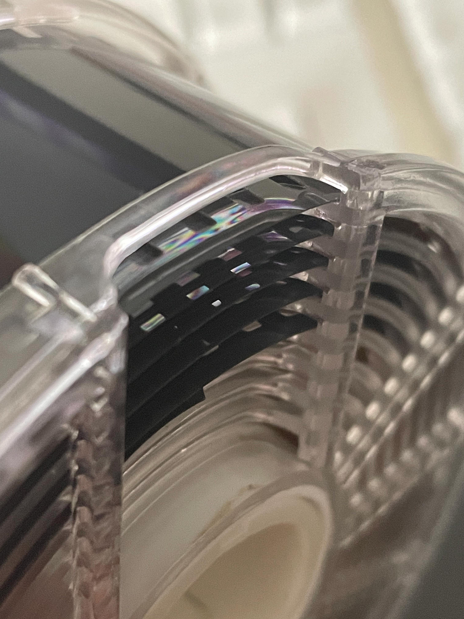

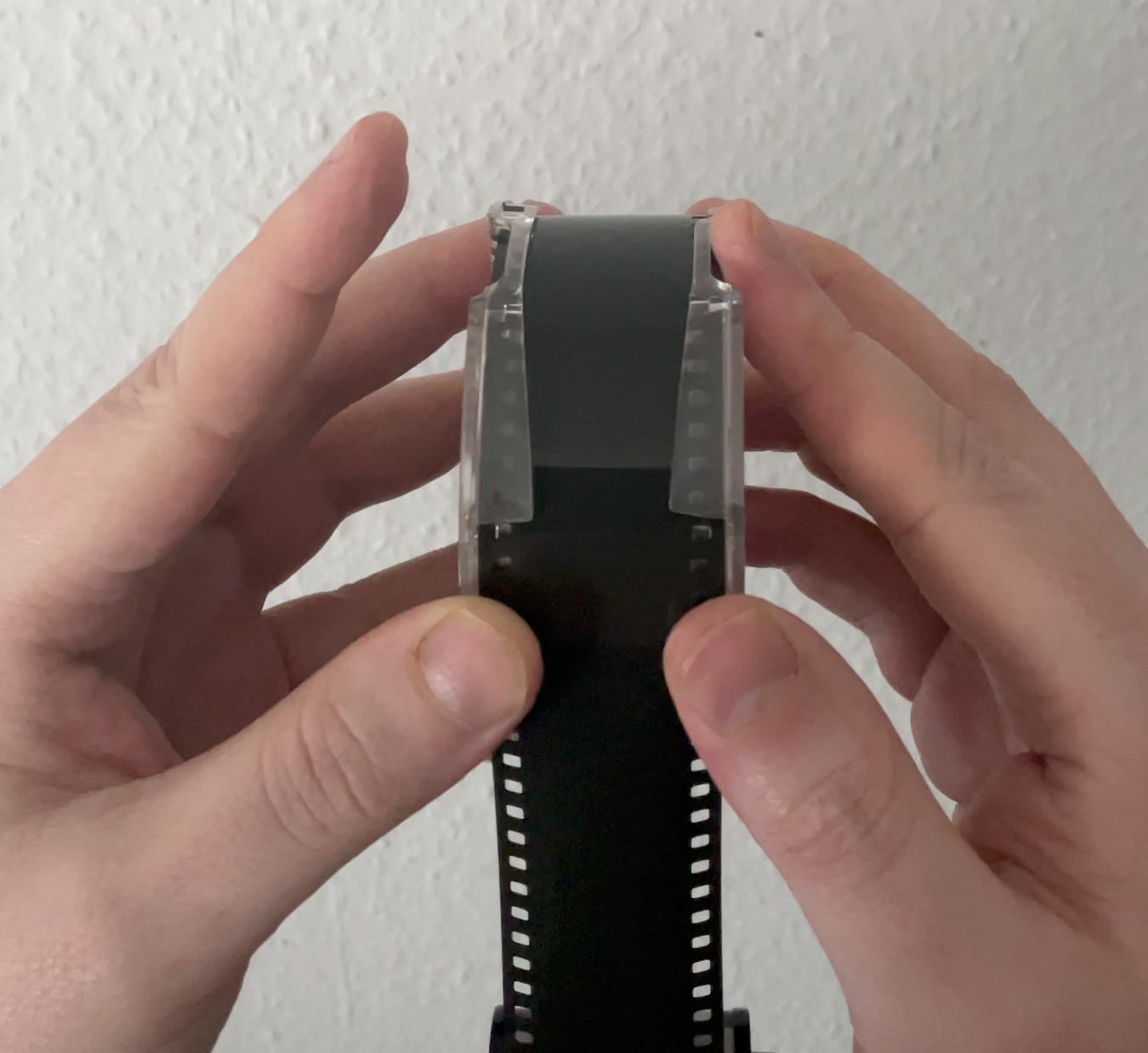

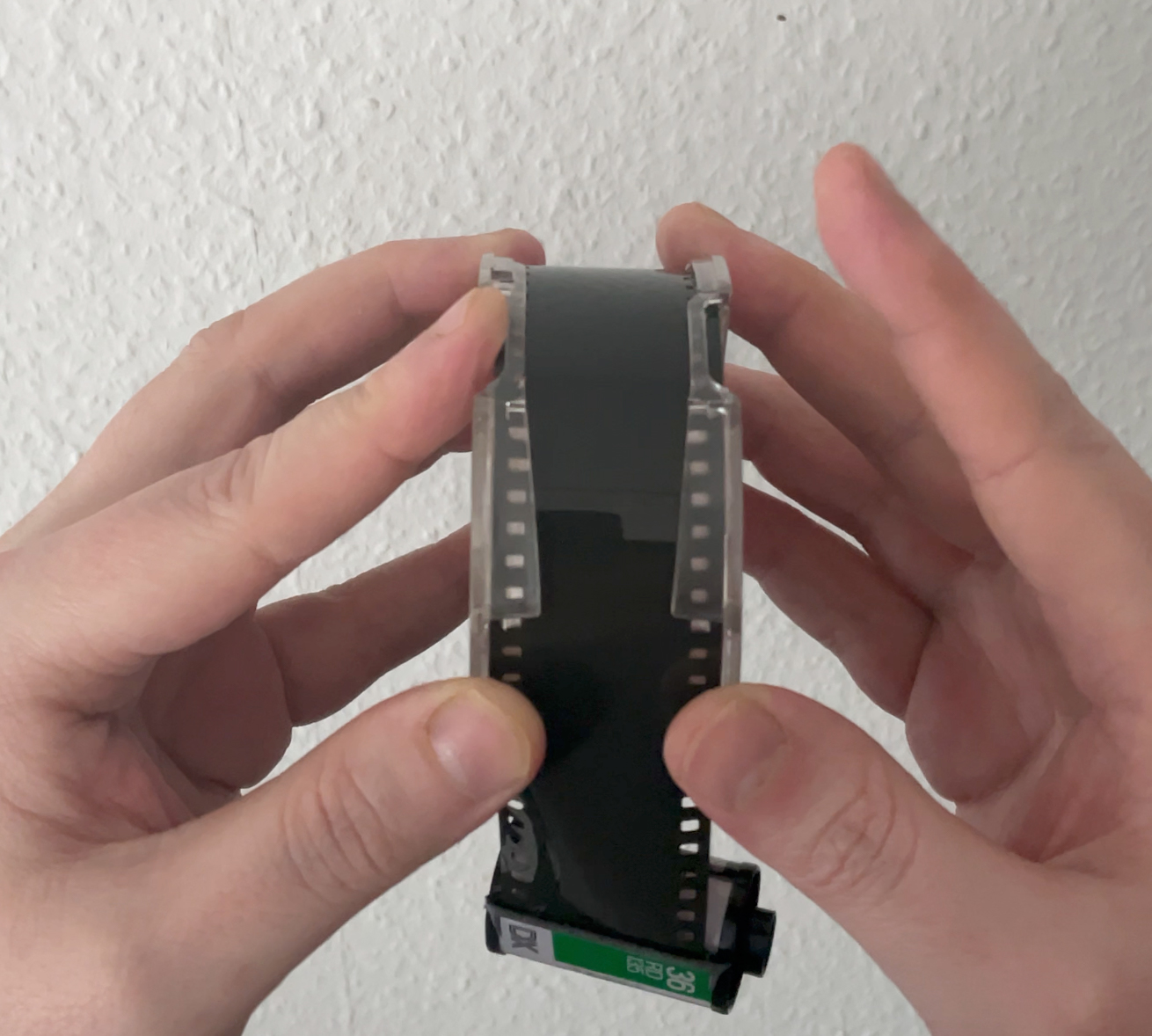

To give a more in-depth perspective into the jobo reel I attached some images:
Ideal would be of course a video of someone loading the reels I would suggest going on YouTube for it, but the server has a upload size limit and people on a later date should be able to read the post and not find a deleted video because they usually don't survive that long if they are not directly hosted on the server
Two major points, first as you progress loading you will have more surface of the film to touch which makes it generally easier and if the reel jams you can wiggle the film compared to a paterson reel because you can touch more "rows" overall your have more control over the whole procedure. Secondly the Feeder/rail is easy to feel/find while in the Dark.
