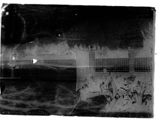

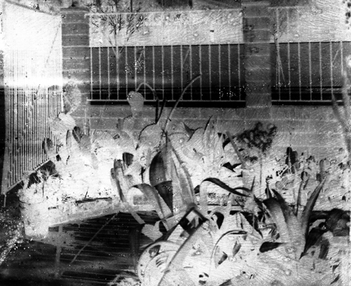

No, I did not give up on this project. I simply had no scanner with which to record my images. Yesterday I set up my "new" Epson 4990 flatbed scanner. Attached are a scan of a 5x7 glass plate negative and a detail of the lower right-hand corner. This emulsion is an erithrosine sensitized (Ortho) ,non-gelatin containing, emulsion. It contains no S or Au sensitizers and is only 40 speed. The negative was shot on a 5x7 plate in bright sunlight. 1/2 " at f45. Developed in D19 for 8 minutes. I like D19 for this emulsion as it tends to be lower contrast when developed in Pyrocat HD.

I will post the images again. I posted x2 both times thinking I was in JPEG. Third is a charm, I hope!
The process is Potentialy Commercial. I have been working with a company under a Confidentiality agrrement. But they are already trying to do more than their "staff" can handle. I may eventualy just post the whole darn thing, if it seams that they are going nowhere.

That's great, Bill! I look forward to seeing more.
Bill,
Those photos look great. Keep up the excellent work!
