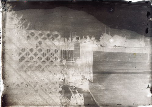

Hello to All,
For Some time now, I have been blabing on this Forum that I am working on a Silver-Halide emulsion without gelatin. I have now solved the last known problem with my formuls, which was bubbles upon drying.
First, I must apologize for the fact that I can not disclose the nature of the "gelatin substitute", as it is covered by a Confidentiality Agreement which I have with a company which, I hope, will manufacture and market it. Also, there is a processing step in the making of the actual emulsion that I will, for now, keep confidential.
I will mention the following:
1) This is a glass negative emulsion.
2)The emulsion contains no animal or plant derivatives,such as gelatin,gums or startches.
3) The emulsion is an Ag/Br/I emulsion
4) Once the "gelatin substitute" is in hand, the emulsion is VERY simple and easy to make.
5) Without S or Au sensitizers the ISO is 40. With S and Au sensitizers the ISO is about 320.
6)The images I have attached are blue sensitive only. Making an Ortho Emulsion is easily done with adition of the green sensitive emulsion that PE has recommended, SDE3006. Or,alternatively, I could have added erythrosine prior to percipitation. All this is not speculation. I have actualy done these things with earlier makes of the same formula. Within the next couple of days, I will post images of the faster emulstion and of the ortho emulsion.
7) The emulsion looks and coats much like a silver/gelatin emulsion,EXCEPT that it dosn't set-up like gelatin. It must actualy dry in the dark. This takes about 3 to 8 hours with hardener, which is glyoxal.
Bill:cool:

Nice mouth!
I look forward to more!

Why does your first example plate remind me so much of this?? :wink:
Ken

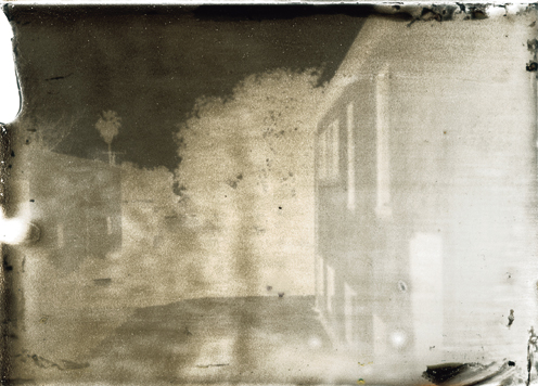

I have an OT question though, is that Little Mountain in the second photo?
No. It is called Blue Mountain. There are several hills about the same size around here (San Bernardino County, CA). They are not very high. But Mount Baldy is a real mountain, about 15 miles away.

Ken and Kirk,
Actualy, in "real life" the two look almost identical as far as grain and color are concerned. I don`t know why #1 looks so grainy and yellow in the scan.
I "pooped-out" last night. But I will coat more plates today and scan several.
