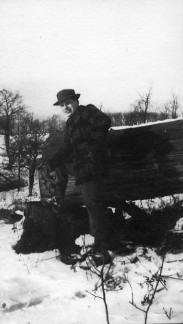

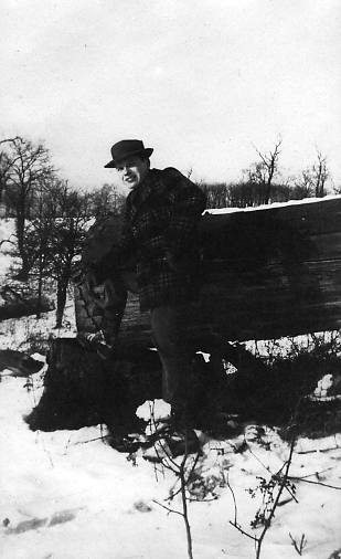

David, I have been examining these prints myself, but more for coating defects and for contrast and speed, so outside objective comments are very welcome. I am also very aware of the potential for flare from paper fibres.
I went back and reexamined a number of prints for flare and tried to reevaluate the images. All of them show a 'scatter' or loss of sharpness at the edges which is related to the paper fibres as I expected. You can clearly see that using a loupe.
The picture that you refer to is the only one with severe flare in the dmax region and it was printed through the base of the negative. Sorry about that, I thought I had caught everything.
So, here in two other pictures is a rather black hat against a white sky and some snow and trees to take another look at. It is printed properly. The grade 2 print is from a 5x7 digital negative and the grade 3 print is from an 8x10 digital negative, both printed emulsion to emulsion. They were scanned at slightly different resolutions to give approximately the same size images. One is on COT320 and the other is on Strathmore smooth.
When you have limited chemistry, you combine experiments, so I'm sorry for the differences. I have left in the tonal differences. The Bergger is slightly more brown than the Strathmore. I hope that this shows up in the images.
PE

Thanks. Those are interesting as points of comparison.
Have you had a chance to compare traditional negs to the inkjet negs? I'm wondering if that might not also be a source of scatter.
Yes, I have compared inkjet and traditional. I see differences. I'm still working on that. Too much to do, too little time.
