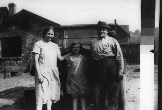

This is from an 8x10 contact print on my Azo type grade 2 paper.
The original sheet of paper is 11x14 inches, with an 8.25" x 14 inch coated area placed in the center using a coating blade of my design. The emulsion used was posted in another thread, but was modified slightly to improve dmin and was doctored and doped for contrast adjustment.
This is a very old family print about 75 years old.
PE

Peter Schrager
Jul 19, 2004
4,332
fairfield co
AZO?
PE-what did you do -scrape the emulsion off of the paper to use it? Just a little confused here...
Thanks, Peter
Photo Engineer
Photo Engineer
Apr 19, 2005
29,017
Rochester, NY
Thanks, Peter
Peter, I'm making my own emulsions.
The Azo work alike is the same speed and curve shape (as close as I can get) to the actual Azo product using direct comparisons.
I make the AgCl emulsion in gelatin and then coat it on paper.

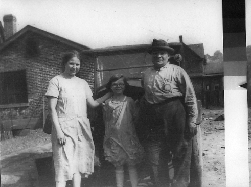

And finally, here is an 8x10 print made using my enlarger. The exposure was 12" at f8. This same picture required 12" at f22 with Ilford MGIV and used a 30M filter to achieve a grade 2.0.
Therefore, by comparison, I believe that this image is about grade 1.5, perhaps lower, and is 3 stops slower than the MGIV. I have matched the Ilford for speed but at the present time, but I sacrifice some dmin. I am working on higher contrast.
You too can do this in your home darkroom.
PE

David A. Goldfarb
Sep 7, 2002
20,025
Honolulu, HI
Interesting to see some promising results here. Is it my imagination, or are the shadows bleeding into the highlights, like you would get with diffusion under the enlarging lens? Is that infectious development?

Photo Engineer
Photo Engineer
Apr 19, 2005
29,017
Rochester, NY
David;
There are several factors at work here.
1. This was a 75 year old print that was scanned in and turned into an 8x10 negative with a step scale pasted into it. There are all of the defects associated with the old print (see the cracks in it?) and the flare from scanning a small original and making the 8x10 digital negative.
2. This is on a non-baryta fibre based paper which creates a lot of scatter from the paper fibres.
3. Maybe what you suggest, but I see no signs of it in other prints. I'll have more posted soon from a wider variety of better negatives.
Forgive the use of digital negatives, but for making large prints at constant exposure (when you are limited in the amount of time and paper available to you) you sometimes have to make do. I can only handle 12 sheets at one time, and there is no margin for error.
I am working on getting sufficient baryta paper to do an exact comparison, but have not had enough to do really extensive work with it. I think this will help somewhat in future prints.
PE
David A. Goldfarb
Sep 7, 2002
20,025
Honolulu, HI
Thanks. Not a criticism, but just curious.
