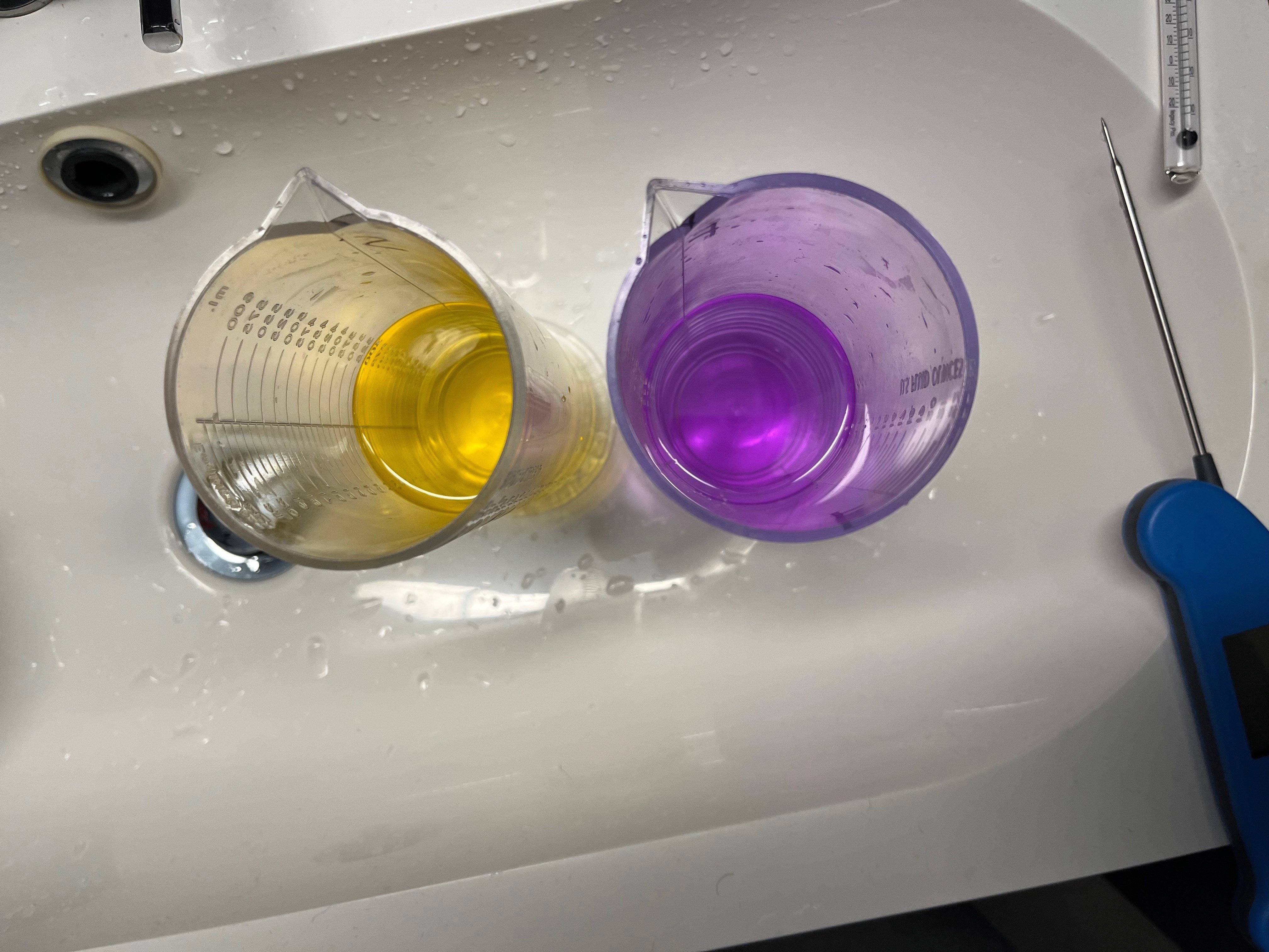

Here is color of the eco natural fixer after 3 rolls of tmax 2 triX and 1 ADOX CMSII.
After fresh stop bath for 1 minute.
Can it stain my films?
I have been scaning my black and white like color and somewhat like the results. TMax and TriX Blue/Purplish. ADOX is pink. Have not scanned it yet.

Nope, not if you rinse the film afterwards.
Thanks.
This is my first time using natural fixer.
My rapid Kodak and Milford never did that.
My fuji C41 did a little bleach stain.
What you're seeing is mostly the carryover of stop bath to your fixer. The stop bath has an indicator dye (bromocresol purple) that is yellow at acidic pH and gradually turns to purple when in neutral pH solutions. There's also some of the film's dye in there, which will gradually fade. This film dye washes away during washing and it is very evident if you leave film soak for 10-15'.
It never happened before using the same Xtol developer and Kodak stop bath with Kodak and Milford rapid fixer.
It must be something the Eco fixer does...
This supports what @Anon Ymous offered as an explanation. Kodak & Ilford (I assume that's what you mean) rapid fixers are acidic. The bromocresol purple will be yellow in those fixers and since it's diluted, it may not even be very noticeable. In your Eco pro fixer that's apparently > pH6.8 it'll turn purple, which is very noticeable. The MSDS for Eco pro fixer gives a pH of 6.75 for the concentrate which will likely be very close to the working strength fixer. This happens to be smack at the turning point of the indicator dye.
The indicator is telling you that your fixer is (slightly) alkaline. If your stop bath turns alkaline, it is used up - that is what the indicator is there to tell you. But once the indicator gets into the fixer, you are glad that the indicator turns purple, because it tells you that your fixer is exactly what it is intended to be.
Thanks.
And if my stop is dying it will turn purple as well?

Thanks.
The indicator in the stop bath turns purple when the stop bath is no longer acidic enough to neutralize the alkaline developer that gets carried over into it with the prints.
Essentially, it turns purple when you have used up its capacity by adding too much carried over developer to it.
If you continue to use the purple stop bath, the non-neutralized developer then starts travelling with the prints into the fixer, which isn't good for the fixer.
In addition, if your stop bath turns purple, it is at least a warning to check whether or not your developer is getting close to exhaustion.
