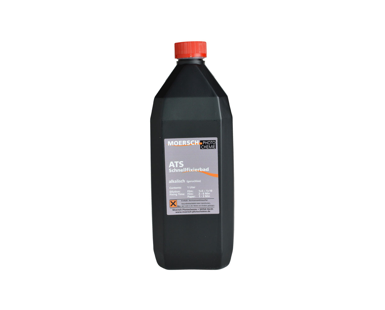

You can try neutral or alkaline fixers, they should have much better shelf life. Moersch gives 5-8 years for the opened concentrate.
Stop bath is a must after developer with alkaline fixer and you should wash between stop and fixer to maintain pH.
I always use a stop bath. I actually don’t have the problem with the mixed developer but with the concentrated solution.
