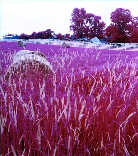

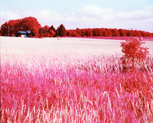

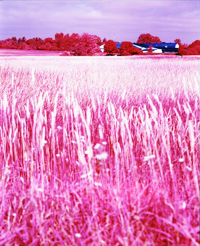

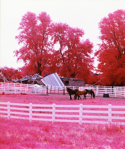

I bought some! It arrived on Friday and I shot a roll of simple landscapes and farmscapes through my Mamiya RB67 ProS with 90mm KL and 180mm lenses with Yellow 15 and Orange 21 filters. I developed it in freshly mixed JOBO Press Kit C-41 chemicals, 3:30 dev @35C, 6:30 blix @36C using the Kodak 1443 data sheet as a rough guide as I'm not really sure the difference from Flexicolor and the Kodak instructions are for aerial 40 ISO use anyways while I'm shooting at sea level.
So, anyone know of a starting filter pack to try? The data sheet says you can cross process in C-41 and then print to RA-4 but doesn't suggest filter settings. I've never cross processed slide film in C-41 before so I'm not sure even how much to add because this film lacks the normal orange base. This is false color IR film so I suppose it doesn't matter and most of my paper is expired anyways but if anyone else has done this, please let me know.
The negatives are drying now so I can't scan them until after work sadly. If I'm not too tired I'll fire up the dichroic head and Ektacolor RT RA chemicals to see how this stuff looks printed. Can't wait!
Will try some people shots on the next roll.

I was told to shoot it at EI 400 even while using a mandatory filter and from the drying negatives that seemed to work well. I was also told to shoot it under subdued lighting but I tried some shots overcast and some under mostly clear sunny skies to see for myself. So I was shooting 1/125 to 1/400 at f/5.6 to f/13 when I was out. All seem good on the negs, no bad misses which is good considering the narrow +-1 stop latitude of the film. Seemed quite hand holdable.
You develop it at lower temperature in C-41 to avoid fog but you don't seem to add much time, 3:45 @33.3 was suggested for Flexicolor chems. I sort of guessed as I'm using JOBO/Tetenal which normally takes a bit longer than Flexicolor especially for push processing.

Ummmm, really nice stuff hpulley. Those are Ciba worthy images.
I will contact Dean and see if any of this medium unobtanium is still available.
hpulley
Oct 6, 2010
2,207
Guelph, Onta
First roll, just trying stuff out. Thanks.
Actually these are negatives I made so no need for Cibachrome, will be doing RA-4.
