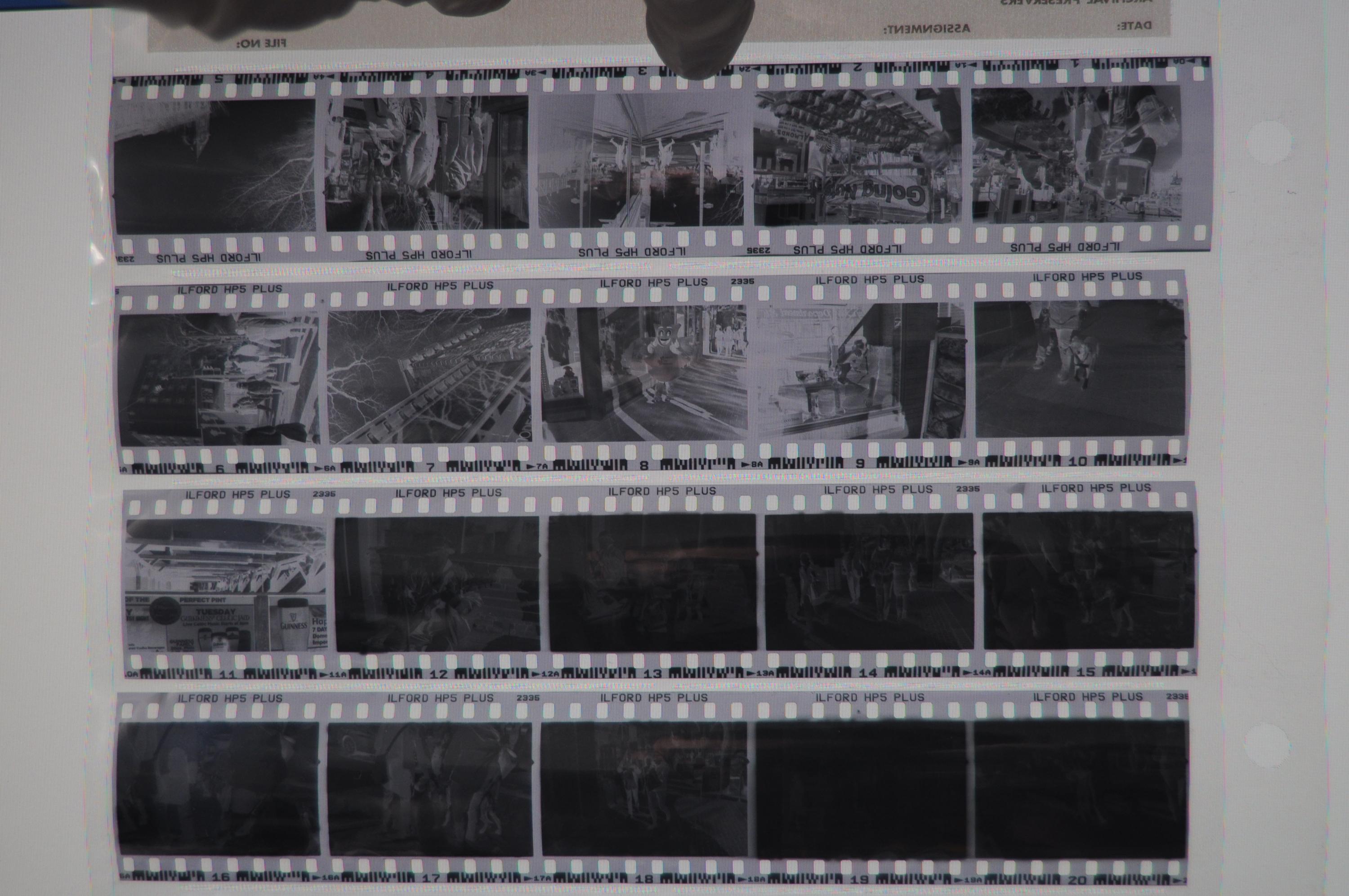

I've only been home processing my B&W film for a little over a month and I already feel like giving it up. But I've invested so much, like the convenience and long term affordability, so I don't know.
For those of you who haven't been following, I've already had three issues with my home processing. First was seemingly underexposed negatives, then weird marks from temperature change and/or accidentally putting wet negs in sleeves, then water/chemical residue marks that wouldn't go away. Each time, the community of APUG has been very helpful in the problem solving, and I greatly appreciate it. So now I have a fourth issue and I'm not even on my 10th roll yet (9th, actually). I'm hoping you guys can help me out. The number of issues I've been having has been very frustrating to say the least. Is it normal to have this many issues in such a short period of time? I know there's a learning curve, but it feels like I'm having more issues than I really should. Whenever I feel like I'm getting the hang of things and it starts getting easier, another hurdle is thrown my way.
So, let me explain, and then I will add images to further illustrate after.
I've graduated to processing two rolls at a time now, first time was ok. Second time (yesterday), not bad either. On the two rolls I processed yesterday, one was from a Nikon F90, the other a Konica Hexar roll. Both HP5 in DD-X for 9 minutes. The F90 roll appears to be fine. The Hexar roll (why is it always an issue with this camera, never have an issue with F90 home processed rolls...) on the other hand, had a peculiarity.
Much of the roll appears fine, good exposure, good processing, what have you. But the middle section of the roll came out extremely dark - so that means they're really bright. They seem very dense, most you can make out the photos somewhat against very bright light, but some look almost smudged (?). I don't get it - the entire other roll is fine, and about 40-50% of this roll looks fine too. The only thing I can think of is uneven development (but I would think this would translate to the F90 roll too) or something within the camera at the time of exposure.

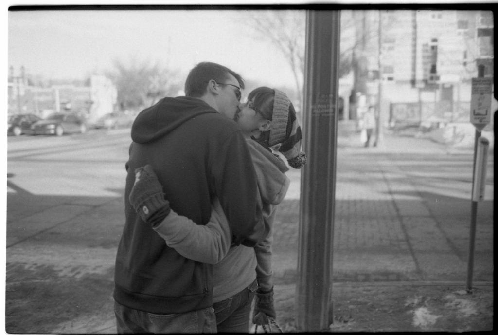

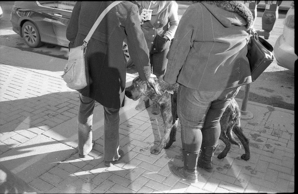

So the first two are ones that turned out fine, the last two didn't...
The good news is it doesn't look as bad as it does right off the negatives. I think I can fix the overexposure with editing programs. But will this be an issue if one day I start wet printing?
Also, even though these issues seem persistent only with the Konica Hexar, I have doubts that this was a camera flaw. I mean, the exposure was set to -0.3 or -0.7, so if anything, it should be underexposed, not overexposed. Plus I haven't had any issue with C-41 or any B&W that I got lab processed.

That looks like an exposure problem to me - as if the shutter on the Hexar was staying open too long.

Yep, negs look fine, but the latter frames are overexposed.

How though? I mean, I routinely underexpose my photos as it is. And it's not like it was so much brighter in those latter frames to warrant such a bright exposure. I've had C-41 done recently, and B&W back in Jan before I started home processing, all turned out fine. And until this roll, no issues whatsoever with overexposure on home processed rolls. I do have to say digital was so much easier, hardly any issues. It really takes a dedication to film to last through all these issues, not to mention past issues (some of which were documented on here).
Thing is too it's been over 30 days so I can't really return it. I don't know if I could afford a repair. It's not something I would've thought I'd need on such a modern camera. Maybe my Yashica, but not this '90s camera.

Did you accidentally change the film speed selection or exposure compensation for part of the roll?
The camera might need a cleaning if it is nearly 20 years old - the shutter might be sticking in some circumstances.
I agree. There's no visible effect outside the frame area (well, a tiny bit of bleed at the edges), which strongly suggests that the extra light arrived while the frame was in the film gate.

What seems to be happening is, on your second camera, it is intermittently over exposing by quite a bit. That has nothing to do with your darkroom skills or chemicals/processing. I had similar issue with my old Olympus OM-10. Either metering is flaky, shutter speed is unstable, or aperture is sticking/not stopping down. But, it has NOTHING to do with your processing of film. If it was uneven development, you'll be noticing problems in frames. Instead, you have perfect frame right next to bad ones. That's a sure sign the exposure is intermittently bad.

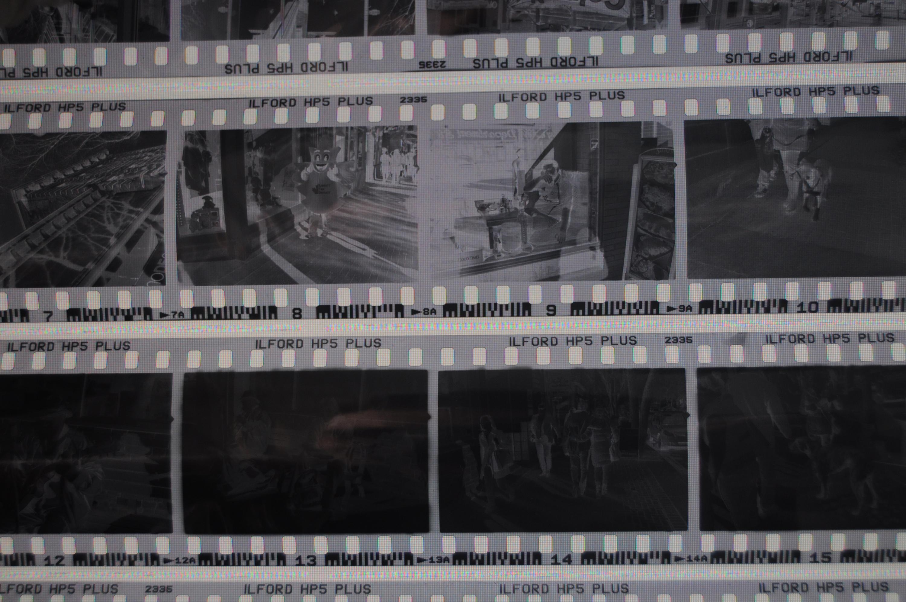

H.V., your negs look fine, the only thing I'd pick out is the pink-ish marks on the negs below your thumb on DSC_0110.jpg and DSC_0112.jpg - it looks a little like under-fixing to me (unless it's something the scanner's picking up that isn't there - I see you're getting quite some colour fringing there!). Sure some are vastly overexposed, but that's a camera problem and is no reason to give up home processing. You're doing a good job so carry on, especially since you've invested capital into film processing. Nobody gets it right 100% of the time, even us experienced folk have problems sometimes.
The overexposure could be caused by a failing meter cell, wrongly-set film speed, sticky lens aperture, dying battery, sticky shutter or another camera problem. It looks as though it's getting worse as you progress through the film. I'd have the camera seen to, or use/buy/scrounge another camera. But don't give up home processing.

Kevs ... thanks. I should add that the negatives in the original post is only about half of the roll. After that second strip of overexposure, there's one more (which wasn't there as I was using it to scan), and then the frames are fine once again. I will go check the battery right now though, it looked fine last I checked. Film speed - no way, it shows me the DX reading for the ISO and it's always correct. FP4 comes in at 125, HP5 at 400, Portra at 160 or 400, Gold and Superia at 200, etc.

Yep, exposure error not processing error. The processing looks very good actually.
Some common causes:
- film speed setting accidentally changed (OK, you checked that)
- compensation setting accidentally changed
- sticky aperture not closing down properly (shots wide open will be correct, shots at smaller apertures will be overexposed and have less DOF than expected)
- faulty shutter running slow at some speeds
- if the metering is via a separate cell instead of through the lens (TTL), did you maybe cover the cell up with a finger for a couple of shots?
- if the camera has AE-lock, did you accidentally leave that on?
So if I were you, I would do some testing alternating between larger and smaller apertures to see if that causes a difference. Shoot one scene at (for example, choose appropriate metering settings for your light level) f/2 1/250 then f/8 1/15 - they should have the same density but differ in depth of field and maybe motion blur.
If you get a density difference from that test, you're getting closer to finding the problem:
- if the small-aperture shot still has shallow DOF, then your aperture is probably sticky (failure to stop down before shutter opened).
- if the DOF change is appropriate, your shutter might be slow on some speeds so test it on all speeds. One or two speeds might be bad on a mechanical camera, highly unlikely on an electronic.

First of all, looking at the negs I see a lot of bleed between frames and the rebated edge on the overexposed frames. To me that says that if you changed nothing between the good shots and you see this overexposed result, you have a camera failure. Looks to me like the shutter is sticking or the aperture is sticking. Look into the lens from the front and the back with a magnifying glass and see if there is oil on either the aperture blades or the shutter blades. Most probably the shutter is causing the problem.
Secondly, take the camera and open the back or remove the back and aim the camera at a table lamp or some light source (illuminated white wall) and run twenty to forty exposures. Look into the back of the camera and get some sense of the amount of light you are seeing and then run the exposures. You will be able to see a much brighter 'flash' if you have a sticking shutter or the aperture blades are not closing. Between the lens shutters are extremely vulnerable to the slightest bit of oil. If the camera were left, for example, in a hot car during the summer months, the oils/grease will migrate from the focusing helicoid into the shutter blade/aperture blades. If it is not a migrating lube problem, then I would suspect a failure in the electronics.
Be sure when peering through the back of the camera to try all exposure modes including manual to see if the auto modes may be failing. Hopefully, this way you will be able to isolate the reason for the heavily overexposed frames. Also, try and duplicate the shooting situations you encounter by running the open back test outside. It is more difficult to evaluate in bright sunlight since your pupils will be closed but with that much overexposure you certainly will see a difference. Try different apertures, such as 16, and run a batch of dummy exposures. F16 will be obvious when you look through the back. If it fails to close down, you will see it immediately.
Lastly, doing the open back exercise may help if it is a camera that hasn't been used much. I typically will run a 100 open back exposures at all apertures and all shutter speeds with a new(used) camera just to exercise because most cameras I buy are likely to have been sitting in the closet and not used for a while.
It is definitely an exposure problem with the camera. Now it's up to you to find the issue! Good luck!

It is pretty much impossible for individual frames on a single roll of film to develop to different densities. Your problem is with your exposure, not developing. :smile:
