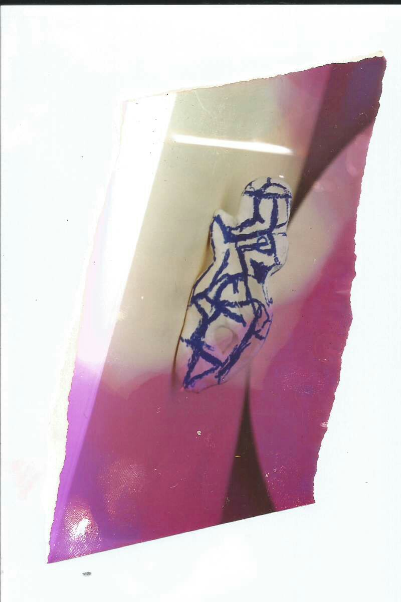

new updates: I'm working on the right filtration and I started by following the suggest of @MattKing. I reached 100M and 60Y. I think it's almost the result that I want. I had thsi result but I don't know if is depending by chemicals or by filtration?
I use 100M 40/60Y but so far the other tests with the same values seemed so yellowish/greenish
What do you think about it?

I for one would find it easier if the test strip were more recognisable.

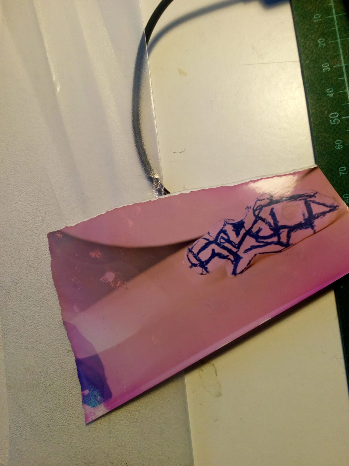

I did this scan... As you can see it's magenta...
Well, magenta or red... I wouldn't wanna say for sure over the internet.
I'd probably take a shot at red, maybe 20cc units as a real wild guess. If so, the fix would be to add both 20M and 20Y to your filter pack. If it overshoots then back some of the correction out for the next test.
If it's actually magenta (rather than red) then the correction is to add magenta to your filter pack.
Just a comment, if you write the filter pack settings on each of your test strips, as well as number them in sequence, you can later retrace your steps to evaluate how you did.
I agree.
It would help if it was a picture of something recognizable, so that we could tell what the colour should be.
The filtration you are using seems to be extreme. I don't know what your enlarger is but there are basically 2 filtration values. Durst and Kodak. I believe the Durst values are higher when compared to same with Kodak They are significantly different. The colour developer may also make a difference as will the temperature it is used at.
I use an LPL7700 which is calibrated in Kodak values and for a correctly exposed and normally developed negative the filtration is nearly always around 65M and 60Y when developed in the Tetenal 5 litre kit. If you can say what enlarger you are using and the RA4 developer you are using plus the working temperature, that could be helpful.

I'm using a MEOPTA OPEMUS 6 with color head. The paper is fuji crystal archive and the chemicals are Bellini RA-4 35°
Flavia it looks much better than the test strips which were unrecognisable to me, so you are getting close I believe. However as others have said a better negative to print from is one that has a range of colours and is of a scene that we can more easily identify the right colours. Skin tones and a range of colours with a patch of grey are better Choose a mid grey such a might be found in a wall or clothing or a car colour that you know to be mid grey then you can compare the colours to what you know they were in the actual scene

I think I reached the correct filtration but I still have problems with some magenta areas... I'm sure they are caused by chemicals but I don't how. I refresh the chemicals and I'm using them at the right temperature... They are Bellini RA-4 temperature 35° .I developed them in a paterson thermo drum. Do you know any possible answer to this problem?
Thank you so much
Would you mind posting a print of the full image? I have a hard time figuring out what is going on. I used bellini ra4 a lot and you need to be super careful not to contaminate the developer with the bix or it dies, when it dies the whites on the paper (like the white margins) turn mushy yellow. Clean the drums very very well between prints. I personally do it in open trays to avoid this problem.
The test strips that I've seen in this thread all look like they are partly fogged by light. Perhaps the box they're stored in before processing isn't properly light tight?
That magenta is a problem with either light fog or uneven processing - are you trying to use a safelight?

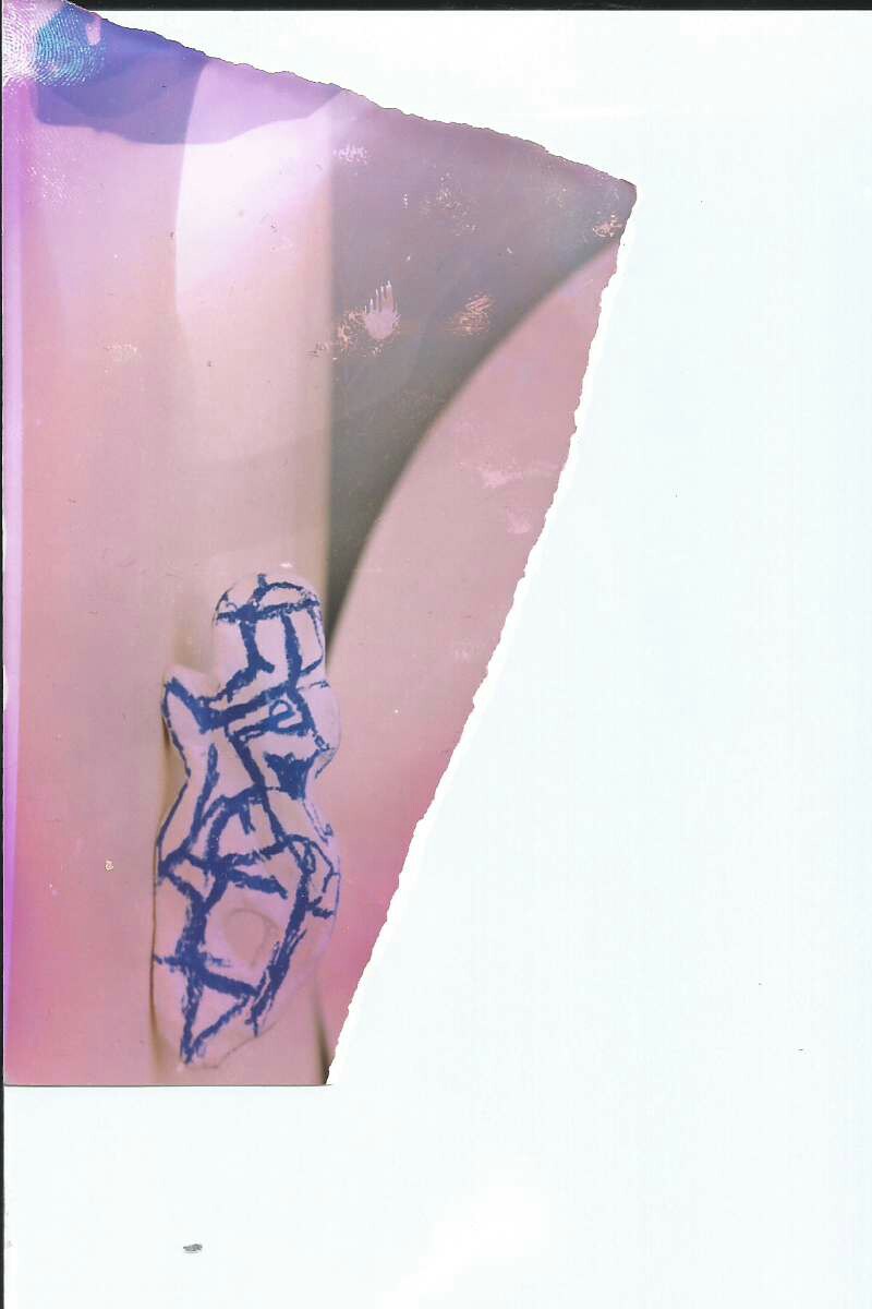

Yes finally I think I reached the right filtration but I think I have another problem right now... And I don't know if is about chemicals or other
No, I'm completely in the dark.
Flavia,
I expect that English might not be your first language, so I hope you don't mind if I tell you that this is a colloquialism that is very funny (in the circumstances).:D:smile:
The colour of the unstained part does look quite close to correct, so you should be feeling encouraged.
What procedure are you using to develop the paper?
