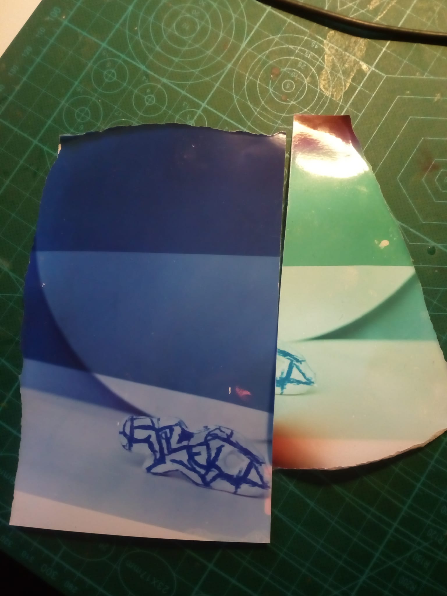

I was actually trying to do like you said but I was a bit confused by add or substract colors and I had to ask a sort of opinion to figure out the correct combination.
It's usually a bit confusing, particularly when just starting out, changing both M + Y at a time. Start with adjusting either one of them, and then do the other.
For instance, your left image is evidently way too blue. The right image is a bit too yellow. Left has Y=150 and right has Y=120, so you could try a print on Y=130 and whatever M setting you happen to be at. If the left strip is the first one you make, and we agree that the problem with blue/yellow is in that one the dominant color problem you'd like to solve first, start with that one.
If you happened to print the right-hand strip first, the most dominant problem I would see is the green cast, so I would try and solve that first. This means adjusting the M setting; given that the right-hand strip has M=140 and the left has M=100 (and that one is probably a little too magenta), you could try a strip at e.g. M=110 or 115.
Most likely you ran into problems with these strips because you were trying to manipulate both Y and M at the same time. Start with only one, and then figure out the other. If your initial strip is either too yellow or too blue (and the magenta/green problem is less severe), start with changing the Y filter until you get as close as you can to a good strip, and you're only left with a magenta/green issue. And the other way around; if the dominant problem in your initial strip is magenta/green, then start there until you're left with a blue/yellow problem and then solve that one. In the 2 strips you've shown, assuming you fist made the left one and then the right one, you solved the blue problem in the left strip (actually, you overshot a little bit and introduced a yellow problem) but introduced a severe green issue at the same time. Perhaps that has confused you.
In this initial step, by all means make nice and big changes as you did in the test strips. Adding or subtracting 20-30CC gives pretty good insight into where you are and roughly where you want to end up.
You may have to take a few more iterations. So if e.g. you have initially fixed your yellow/blue cast as well as you could and then fixed magenta/green, it is possible that you're left with a smaller yellow or blue cast which you didn't see because of the remaining magenta/green issue. You then proceed by adjusting the Y setting to get rid of the problem. In this second iteration, you want to make much smaller changes; if you made changes of 20cc in the initial step, now try something like 5cc.
Finally, please keep in mind you only need to filter on M and Y, never on C. So the 'ringaround' that @Mr Bill mentions is absolutely fine, but you don't need to go into 6 directions. 4 is ample. Leave C at zero, at all times. But like I said, instead of trying to fix both M and Y at the same time, do it one by one.

Hi, you can start anywhere you like, but personally, I'd say you already HAVE a start. I'd go on from there. For the folks that say to go back to a "standard" starting point, fine. Either way, pick one and then go on from there.
From your test that is too blue, here's how I'd approach it: a rule I've used for color correcting since circa 1970s is, "always do the wrong thing." Ok, since the print is too blue the "wrong thing" seems to be to add even more blue (to the filter pack). But following the rule, it IS what you want to do. So... since you're gonna do all your adjustments using only yellow and magenta filtration you've got to convert from blue to these.
Ok, yellow and blue are "complementary" colors, essentially opposites in photographic color. You know you want to add blue, which you don't have, to the filter pack. But since yellow is the "opposite" of blue, then removing yellow from the films pack is equivalent to adding blue. So... you wanna remove some yellow filtration. How much, I have no idea - this is so far off. But if you make several jumps of 30cc it shouldn't take long to zero in. So from your starting point of: 100M, 150Y, I might pull out 60Y, giving pack = 100M, 90Y. If this overshoots, giving a yellowish print, then you could estimate a correction somewhere between the original 150Y and the test value of 90 Y. If it was not far enough, and the print is still too blue, you could try removing another 30Y from the filter pack. Etc., etc.
Alternatively you could use the green print as a starting point. Using the rule, "always do the wrong thing," you would want to add green to the filter pack. As before, you don't have any green filters to work with. But... green is the complementary color to magenta, which means that adding green is equivalent to removing magenta. For the amount to remove, I dunno, but the green doesn't look as "strong" as the bluish print, so it's probably a smaller correction. I'd probably try pulling one or two sets of 30cc magenta. So instead of 140M, 120Y, I might try going to 110M or 80M with the 120Y.
When you reach the point where another color predominates then you can start working on that color.
I should probably describe how to deal with the third primary color, red. If you have a reddish print, you want to "do the wrong thing," and add red to the filter pack. The complement of red is cyan, so adding red is equivalent to removing cyan. But... traditionally we don't adjust cyan filtration. So, the question is, "is there another way to add red filtration?" The answer is yes, if we add equal amounts of both magenta and yellowish, this is equivalent to adding red filtration.
Now, I'm guessing that you don't have the color relationships memorized. A conventional way to work with them is to sketch three overlapping colors; label them as red, green, and blue. Where red and green overlap label it yellow. Where red and blue overlap, label it magenta. And where green and blue overlap, label it cyan. Once you have this diagram its easy to see which colors are opposite (these are complementary), and the result of combining colors. With this you should be able to work out all the colors. Once you are able to recognize them, that is. Most people, when starting out with this, will identify a magenta color as red, and a cyan color as blue. So keep this in mind if it's hard to fine-tune colors.
Once you get a print dialed in, more or less, then it may be worth making a so-called color ringaround. Basically this is a set of color variations in 6 directions. You'd have both plus and minus red (minus red = cyan), plus and minus green (minus green = magenta), and plus and minus yellow (minus yellow = blue). If you do this ringaround in two or three different color strength levels, this would be very useful in learning how to recognize colors.
Best of luck in your endeavors.

I was actually trying to do like you said but I was a bit confused by add or substract colors and I had to ask a sort of opinion to figure out the correct combination. Anyway I'll try your suggest too. Thank you !!
The rule to "always do the wrong thing" is virtually infallible. Just decide what the print has too much of, then plan to add that to the filter pack. Except that you will only be working with magenta and yellow in your filter pack. So you need to find the equivalent to "add." I say "add" because the equivalent of adding one color to the filter pack is to REMOVE that color's complement.
As I said before, if the test print is too blue then you say, "I need to add blue to the filter pack." But... since we don't work with blue filters you have to find the equivalent of adding blue. If you draw that color diagram I described earlier, if you start at blue you can see that the color directly opposite is yellow. Since yellow is opposite, then you figure that removing yellow is equivalent to adding blue.
If you understand and follow this method you won't need to make errors in your corrections. The only problem will be in identifying the actual color, as well as its strength. And actually printing a color ringaround will help with this.

Hello everyone,
I'm having an issue with the correct filter :errm: I did two test strip. One it's too green and the other it's too blue.
The blue one has M100 Y150 and the green one has M140 Y120View attachment 245248 . I did other test but I had cyan and I didn't get good results. What combination can I try to have the correct result?
Thank you so much :heart:
Just out of interest what negatives are these test strips from? Others seem to be able to see images from a negative projection onto a piece of RA4 but all I can see is a mid to dark blue section with a light blue section under it and on the other side green sections both of which seem similar in colour with some beige sections and a thin darker green streak
I am beginning to wonder if I am the only one to see the strips this way as it seems to be only me who finds it impossible to make a comment other than all pieces are either much too blue or much too green in terms of a cast on what may or may not be a negative projection.
By the way were these test strips done in total darkness except the exposure of the negative or are these blank strips of RA4 on which no negative was projected but simply exposed to the two filter settings you mention?
