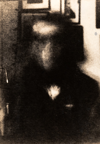

Loved your post, the nude and the Kentmere are very suited yo my warmtone inclinarions. Are you using controlled lighting? Kino Flo or Tungsten? Have you tried extended diluted toning like 1+300 for 20 min which is my standard in FOMA 131 with PW developer? Thank you for yout posting, and Jessica thank you for the thread and keep it up, and photographty is about experimenting regardless of what people say, and havin fun and enjoying it. I'm 60 and still enjoy it like when I was 18

How does the sharpness of the positive compare to the original negative ? Could you check it out with a loupe for us if it there is no obvious difference ?
I realise the emulsions are quite thin (perhaps 10-15um), but there would also probably be some supercoating/anti-scratch layer on top of that too. I guess due to diffraction the positive can never be as sharp, but I wonder what practical results you are getting.
hi peter
to be honest sharpness and extreme detail and examining a photograph with a loupe
seem to be only thing that photographers are interested in. well most photographers ...
i don't care much for loupe examination or extreme details, but if you need them, they are there...
