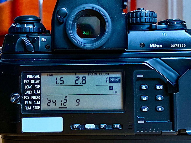

  • Exposing Kodak color negative films with the Nikon F4E and various AF Nikkor lenses. Imprinting the shooting date on the gaps between the images with the Nikon MF-23 Multi Control Back.

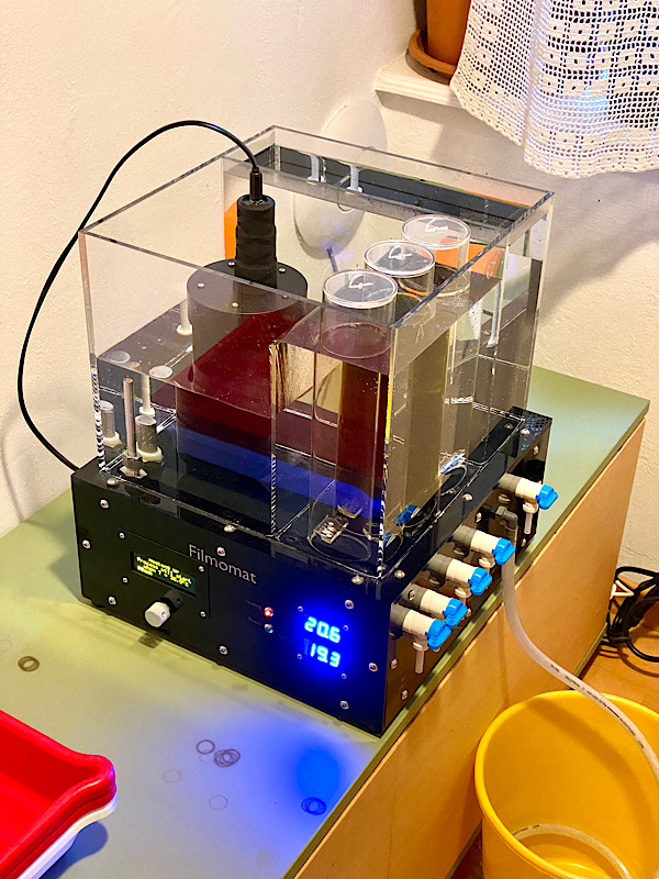

  • Developing the films in the C-41 color negative process by Bellini with the Filmomat processor.
Filmomat in action

The mighty Nikon F4E, for me one of the most impressive SLRs ever built.
This workflow is particularly dictated by the shelf life of the C-41 process chemicals, which only have a certain lifetime. This is why I try to be out and about with my camera every day, regularly developing, scanning, processing and archiving.
Nikon MF-23 Multi Control Back for imprinting data and automatically controlling the Nikon F4.

I previously worked with the Colortec C-41 set from Tetenal, a two-bath process that is no longer available. The diluted chemicals lasted a very long time.
The diluted developer in Bellini's process is different and I was amazed when I hung two exposed but otherwise empty films up to dry 😌
Otherwise, I am very happy with the switch to Bellini's three-bath process and have simply adapted my workflow. Bellini‘s customer service is excellent.
The Filmomat and its built-in impeller as part of the pump also appreciate regular movement, as does its user.
I still have two cans of Tetenal Protectan, which is supposed to be butane and displaces oxygen in opened chemical bottles. This extends the shelf life.
With one set of Bellini I develop twelve 35 mm films and therefore do not exhaust the yield.
The results are perfect.
As far as I can tell the Bellini developer should perform similarly to the Fuji stuff. Both (and many others) rely on hydroxylamine sulfate to keep them alive. Rapid deterioration of the developer is likely due to adverse storage conditions. This can include relying on something like protectan or butane instead of more effective ways of preventing oxidization. Of course, using fresh developer is a safe bet. We all have our ways.
