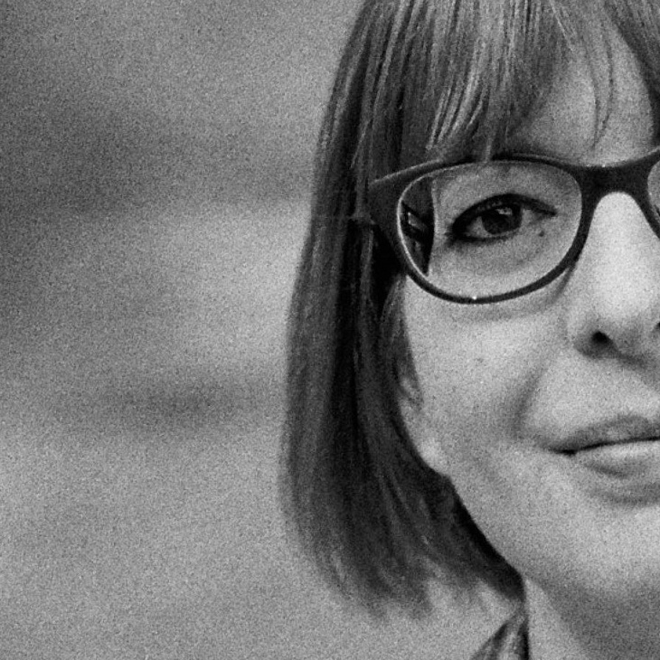

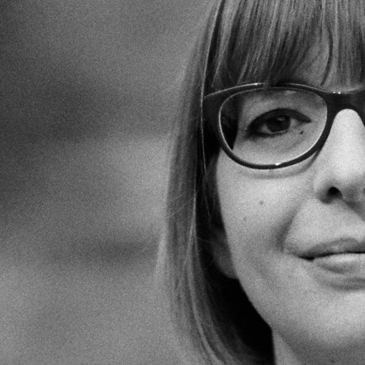

My time is 9:00. 20°C. Same as Xtol 1+1.
They came out pretty good. No problems that I can see (apart from the dust from the scan). Thanks for the advice.
