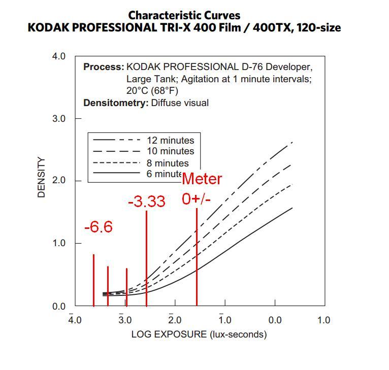

In your canadianfilmlab test there was -3 stop exposure as example and based on what you wrote that should be quite dark, I believe. But it is not.
Look, ISO speed calibration ensures that the speed point (0.1D density, plus B+F) is 3.33 stops underexposed, in the canadianfilmlab test subject is lighter than backgound, if it was incident metered the face is at +2 resulting -1 locally. The (now killed) 400H case is a bit a kown exception, metering has an influences... but a -3 (exposure compensation) underexposed shot have areas that were bright and had a lower underexposure.
I'm not saying the test is perfect, but carmencitafilmlab is a pretty known and reliable lab.
OK, but this test is is a pitfall, at -5 you have nothing. Still those bright zones that are +2 locally over the averaged metering will be locally at -3, so you get an image.
Based on your claim 4 stops underexposure should be dark. But it isn't.
The zones you point were not at -4, if spot metered would have been -3 or more exposed.
As you look interested, I would recommend you to get Beyond The Zone System book by Phil Davis, an excellent vault of knowledge about practical sensitometry.
Ilford does not provide curves but this is how all films behave:
ISO calibration places 0.1D over base+fog

In a nutshell, in ISO, 0.1 above fb+fog is located 3 1/3 stops below the metered exposure, whereas in the Zone System we are told to look for it 4 stops below the metered exposure. It is therefore no surprise that most Zone System practitioners who have tested as carefully as they can, tend to come up with an EI 2/3 stop lower than the ISO speed.
The unfortunate part is you go through all the testing, just to confirm what is on the box is correct. No new information is revealed - contrary to what a lot of books and gurus say. If one wants to use the Zone System, the correct EI is simply ISO speed minus 2/3 stop, so you might as well just skip that part and move on to the expansion/contraction stuff.
Well almost to the point. The Zone System metering aids in capturing the shadow detail. With today's negative film, Zonistas are merely testing, testing, testing their life away.

I don't think... under -3.5 halide crystals are simply not exposed, a crystal needs to receive 2 or 3 photons in time to get electronically marked (electron lost), if the crystals are not electronically marked they simply won't develop an image.
ISO calibration takes uses point where film starts being exposed (speed point), and meters aim 3.33 stops more lights, which is x10 more light. With ISO well selected in the meter, the meter instructs you adjust x10 more more exposure (in Lux·second) that the required in the speed to start exposing film.
So under -3.33 (spot metered) expect nothing worth.

I am not confusing anything my friend. The given time for HP5 gives a rather thin film negative. I have tested that film to more developers you can think of (135 and Medium Format only), commercial and home brew.My preferred rating, if you don't like the term true speed, in ID11/D76 is EI 320 and EI 200 is not far from it.
Btw, my preferred normal agitation scheme is 5 inversions/rotations (lasting 10") every minute. I never liked the results of Kodak's suggested agitation scheme.
From ISO 400 to EI 320 we have around 1/3 stop less diference. 400-320= 80... and 80 is 20% of 400 . In practice this is irrelevant. Using HC-110 vs Xtol decreases that.
Also, how fresh the film is? Just manufactured or it was in the bottom of a big box and it was sold 6 month later ? Did you keep it 6 months outside freezer?
What meter do you use ? 1/6 of stop is an easy mismatch... Spectral light nature? What kind of light ? How do you meter ? people meter 1 stop differently...
With today's norms one can use any developer to make a calibration, if not telling the developer true speed calculation make no sense beyond 1/2 stop.
To know if we use an ISO standard development (to find true speed) it should result a 0.17D density increase for each addiional stop, so your negatives are in the thin side if an additional stop exposuse increases density by less than 0.17D. (beyond linearization)
In that situation (0.17D per stop) we may investigate if we are using the "true speed", ("gray") spots metered at -3.33 should have 0.1D more than Base+Fog if we use the True Speed of Film+Developer.
Box speed nicely tells the film nature, but no film is ISO 400, it can be ISO 379.23 or 404.42, speeds are rounded to a comercial standard values (norm allows that), there is a manufacturing variability, we have film aging, and or course we have very different ways to meter that can easily differ 1 stop.

My metering depends on the camera I use. My F100 for example gives consistent and always spot on results across an entire 135 roll, while with all manual cameras one can see when I have used a handheld meter (a minolta spot meter btw), and when I estimated the exposure and when I did that and missed it by a stop or sometimes even more.
Let me add those points better described:
> You can measure densities simply with the scanner, just scan film alongside an Stouffer T2115 density wedge to compare.
> To know if your development is on the standard contrast just check if some gray subject that has been spot metered by +2 has a density that is around 0.51D higher than an spot metered -1. As meters may have a 1/3 stop resolution better if you check the density boost from 3 additional stops range, then error in the Contrast Index calculation will be lower...
> If you want consistency between cameras/meters you don't even need to shot film, just compare the metering each device provides in front of the same scene.
> If you want to know if you are using the true speed, first adjust development to have that 0.51D increase for ecah 3 stops additional exposure, then check that an spot metered 0+/- has a 0.72D more than Base+Fog density, Base+Fog is measured in an area that has not been exposed to light.
_____
Note that the speed point is underexposed 3.33 stops and has an standard density of 0.1D over Base+Fog.
Form B+F to Speed point you have 0.1D increase, and from Speed Point to the Meter 0+/- Point you have an additional increase of 0.62D. So from B+F to the density of a 0+/- spot metered gray subject you have 0.1D + 0.62 = 0.72D.
Either you can check if an spot metered 0+/- delivers 0.72D over F+B, or if that 0+/- spot delivers 0.62D over the density of a -3.33 underexposed spot (with will be in the speed point).
_____
At all those calculations are necessary to get great images, but if one likes to do that then one may get more consistency when using different films or developers, still doing that once in a lifetime it's quite nice to feel how film works..
