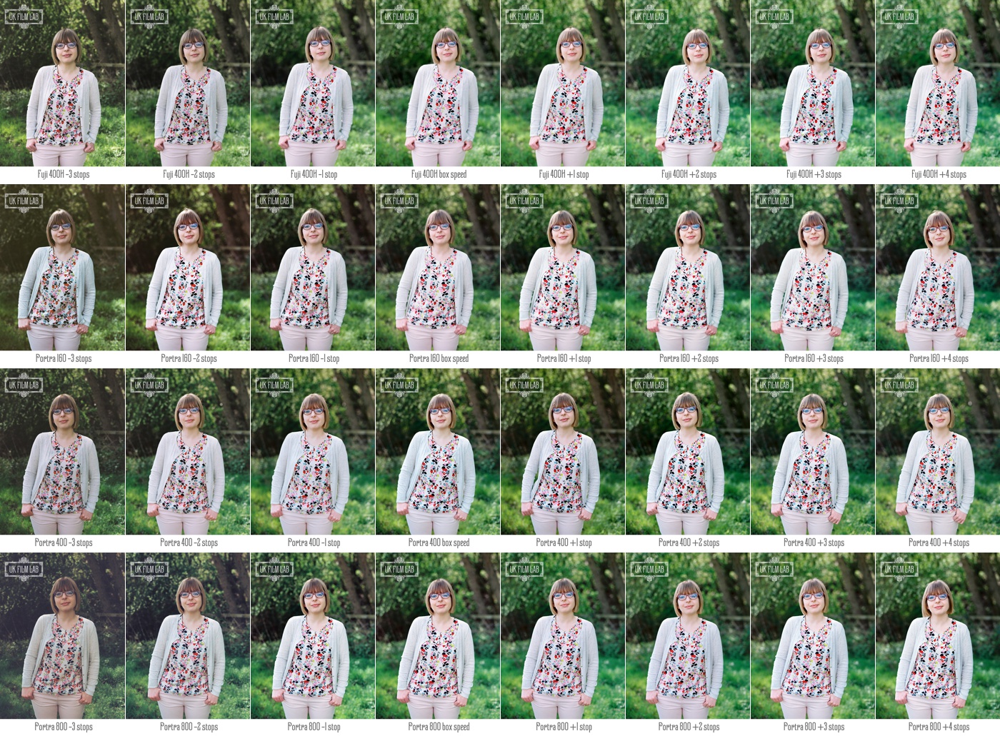

Many people rate negative film at lower EI than the ISO stamped on box without a correction in the development. Also it depends on how you meter. YMMV...
In fact, box ISO speed was doubled in 1960 with no change in the film manufacturing or in the development times, you simply have exposed like it was standard before 1960. Post 1960 shots were not better exposed than Pre 1960, but Post 1960 speed pushing allowed faster shutter speed (or more DOF from aperture) yielding sharper shots in general.
Slides are different because overexposing easily harms, but overexposing a bit (one stop is a bit) negative film usually does not harm and it even may be benefical.
With color negative film, you have to overexpose many stops to start damaging the image:
http://canadianfilmlab.com/2014/04/24/film-stock-and-exposure-comparisons-kodak-portra-and-fuji/

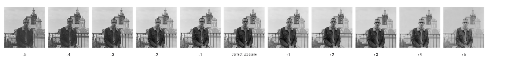

.. and do you still think we need to spot meter :wink: :wink:
Continuing joking around: this is why Sunny 16 rule works. You really don't need to have any clue of the lightning conditions :D
Edit: Example of under/over-exposure on HP5 https://carmencitafilmlab.com/wp-content/uploads/HP5-Bracketing.jpg
For sure, but sometimes we require a refined spot metering, this was my second 8x10 shot ever: https://www.flickr.com/photos/125592977@N05/24852468435/
In that shot I had 8 to 10 stops dynamic range in LIRF conditions selectively in the shadow areas, depending on what considered, I'm pretty sure that only a refined metering allowed me to nail the shot like I wanted it, with no bracketing but shooting two sheets to have a backup.
With slides... if we have a bright sky then also spot metering can be quite useful, it tells what graded ND we need to conserve highlight texture, while preserving shadows.
That test is totally flawed: At -5 you always have a black image. ISO calibration is based in the film speed point, by -3.33 underexposure you have 0.1D over base+fog, try it... So at -4 you have nothing, quite a weird metering had to be there.
In your canadianfilmlab test there was -3 stop exposure as example and based on what you wrote that should be quite dark, I believe. But it is not.
I'm not saying the test is perfect, but carmencitafilmlab is a pretty known and reliable lab.
Here is HP5 "pushed" to 6400 (4 stops) https://emulsive.org/wp-content/upl...5-EI-6400-Ilford-DD-X-14-Mamiya-645-Super.jpg and https://emulsive.org/wp-content/upl...HP5-EI-6400-Microphen-Stock-Canon-EOS-650.jpg
Based on your claim 4 stops underexposure should be dark. But it isn't.
