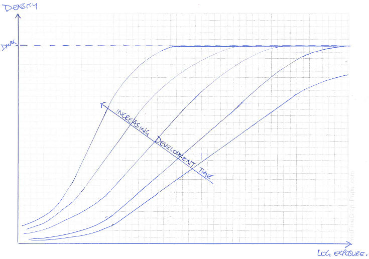

If possible I would like to make a very general statement about a film's shoulder (reached due to overexposure). Is it true that in general the following set of curves will represent the relationship in the shoulder area to increasing development times ? Note dev times might get too short to achieve Dmax as I show in the lowest curve.
If my graph is not general enough, then what generalisation could we make about the way a curve's shoulder is affected by increasing dev times ?? (you must ensure sufficient over exposure is given to define all of the shoulder right out to Dmax)

To your generalization. No.
In general, as development is increased the curve gets steeper.
It can be said that each emulsion/developer/technique combo creates a unique set of curves.
It can be said that some films will shoulder off as you have shown, but its not a general truth. For example, TXP reaches 2.8ish with almost no bend and gets well over 3 with just a little, the shoulder is still really steep though.
DR5 claims a D-max of about 3.3 for HP-5 chromes.
http://www.dr5.com/blackandwhiteslide/hp5dev-1.html
So where do we start bumping D-max for a given film? Where do we start shouldering? I don't know.

OK Mark, so I had assumed that we keep every other variable fixed except development time. Surely we can say something about each successive shoulder for increasing dev times. How about "As we increase dev time, the shoulder of the curve will begin earlier and reach Dmax sooner".
regards

Hi Mark. I think you are missing my point. Here is how I would conduct the experiment so that a generalisation can be made about the curve shoulders for at least a few popular films and developer combinations:
1. Pick one of the 5 most popular B&W panchromatic films.​
2. Pick one of the 5 most popular film developers.​
3. Expose the film to a step tablet with sufficient intensity that causes Dmax to be reached and entered into by at least 1 stop (this guarantees you WILL eventually traverse the shoulder even if you can't find it in the published curves) when it is developed.​
4. Develop the roll for some minimum time which ensures a CI beginning at say 0.3 and that Dmax is reached because it was overexposed so much in step 3.​
5. Repeat the above steps, increasing the dev time to give increases in CI of reasonable steps (say 0.1 or 0.2) until you reach a CI of say 1.0.​
6. Plot all HD curves for that combo on one page.​
7. Repeat all above steps for a few more film+dev combos.​
8. Make a general statement about what you observe in the shoulder areas of all the curve sets.​
regards
Peter

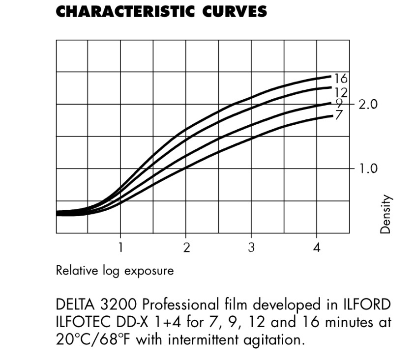

I do think you have your work cut out for you to make it real; first in finding, then in mapping the shoulders.
Personally I doubt that you find a clear cut shape or threshold that defines shoulders in general in a meaningful way.
Consider D3200, it has a long arc of a shoulder, depending on the CI you might consider "normal" the shoulder can even make up most of the curve. XP2's curve is similar in shape. Like the energizer bunny they just keep going and going.

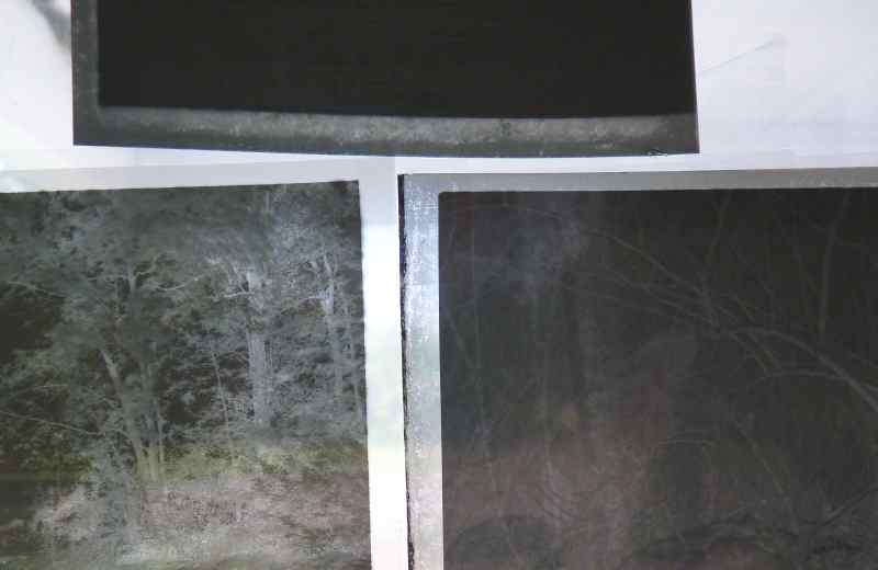

I was trying to reduce effective film speed not rescue a 4 stop overexposure with mathematics and theory
I'm beginning to wonder if there is any roll of film
losing film speed would be my first action before heading into all this graphing of whatever you're doing
if you use xtol at 400 you can use 250 with rodinal
add in restrainer and you could use 200
maybe add in enough and you could have a film speed drop from 400 to 100
more? don't know. At some point you wouldn't develop that latent image at all or so I've read
with that much restrainer you'd likely have to reduce development to tame the contrast from its addition
drop film speed enough and print on azo or alternative process
I'll include a pic of 3 4x5 negatives taken on badly fogged film. I was trying to reduce fog through restrainers
all exposed at ASA10 in Rodinal 1:20
upper neg had some restrainer
right neg had more
left had even more
as you can see the fog nearly disappeared and it seems the effective film speed was dropped probably from 40-50 at foggiest/most dense to about what I shot it at 10
i'll take a quick pic of the straight print using no filter "Grade 2"
detail from slightly smaller than 20x24 print
