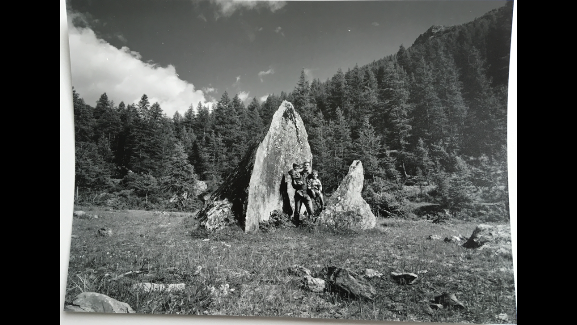

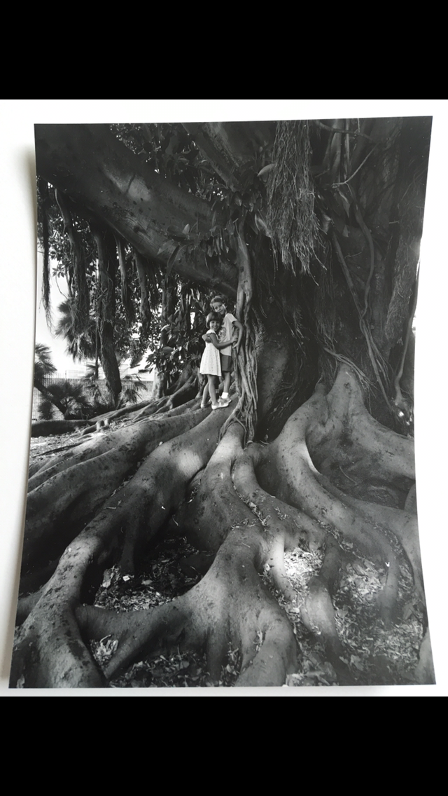

prints on MCP 312 matt in Eukobrom. these are small prints, 13x18cm or 5x7" but final prints will be much bigger according to what will happen enlarging 5X. Will decide final dimension on quality obtained. prints here are from my iphone picture, no scanner at the moment.
My first 6 120 rolls were processed in fresh xtol, then added 150cc to the used one and processed another 6 rolls, then added 200cc fresh and processed 6 more, than went on processing 6 and adding 240cc fresh. At the end I kept all xtol used as I needed 5000cc to fill my deep tank to process 5x7" in hangers 10 at time. Now I'm waiting for some more xtol to mix and use to replenish the used one to process the 5x7 film waiting since many months.
all 120 film was processed in jobo tanks 6 or 14 each time with manual inversions. 7min 20°c first minute agitation, then one inversion each minute. stop with citric acid, fix with tetenal odourless superfix 5 min. Unfortunately washed with Fotoflow 200
